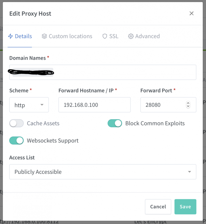

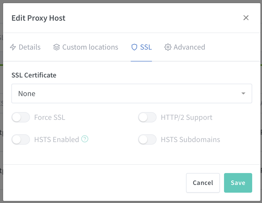

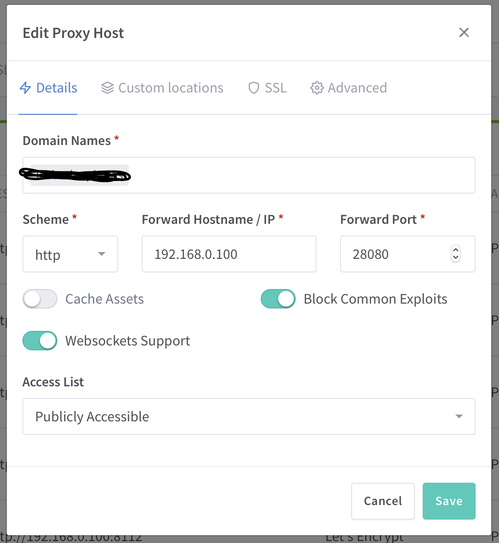

Hi all, how do I get this Wordpress docker to work with NPM correctly, I don't seam to be able to get the SSL working correctly. I have changed the external port for Wordpress to 28080 and points still to the container port of 80.
if I enable things in the SSL tab, the site stops working.. from the following what would I need to change, also does something in the wp config require changing?

Have you forwarded the port 433 in you router to the https port in NPM? Did you do a clean install of WP where it uses your HTTPS address?
Kru-x
Yes the 443 port is forwarded, my other proxy working ok,
I was reading another post about that further back in the thread, so I did just that and installed via eg: https://siteaddress.com
During me trying to get this to work correctly I hit the cert limits :) opps
Happens to us all ;-), you could fiddle around with wp-config but I find it easier to start from the beginning as it seems like u did. It should work when you can create a new cert, if not reach out again and ill try to help.
kru-x

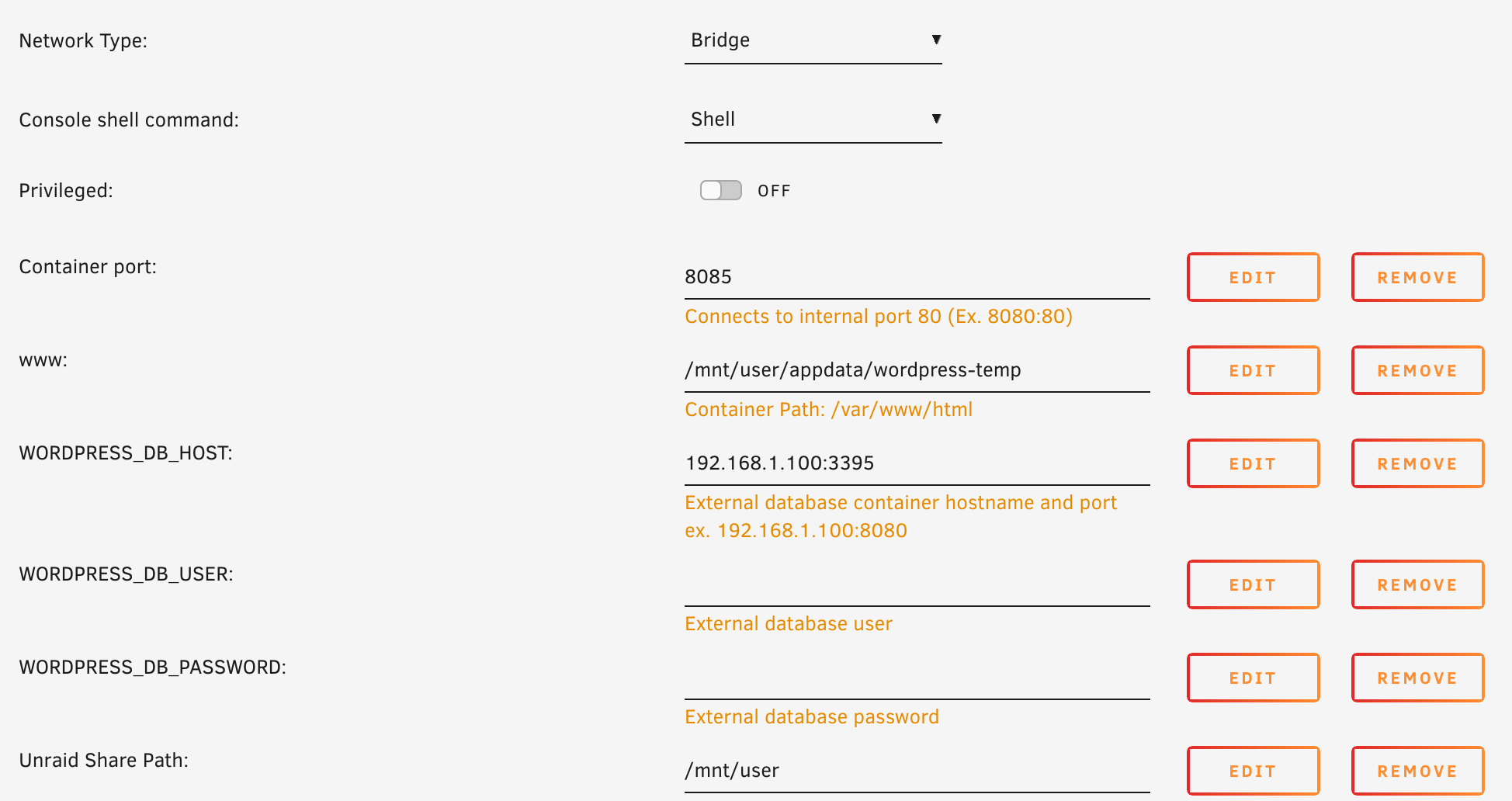

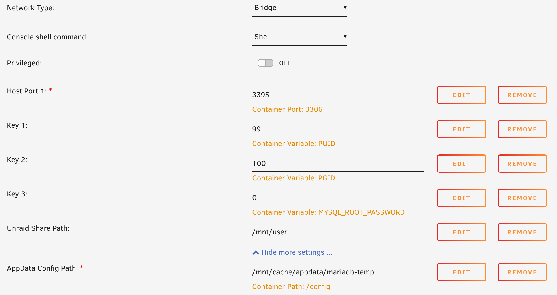

Tried this docker tonight but dont know if im stupid, if there is something wrong in the container or my unraid.
I setup MariaDB with the ip and port ...11:3309 (tried both host network and br1)
During Wordpress docker installation i choose network br1 with the ip of ...12
Also during the setup i have tried several different container ports, both 8080 and 443.
The funny thing is, even if a choose 8080 or 443, the "webui" link on the docker image always open the site with :8080.
The other funny thing is, even if i choose 8080 or 443, the port mapping is always 80.
And then the other problem, when i open the site with port 80, i get this error: Error establishing a database connection
So, how is this docker supposed to be installed?

Hi lusitopp,
There is a few issues and none of them is related to the container nor unraid, but we have all been there so don't be alarmed. ;-)
First, the IP address is the physical address to the computer (server) and should not be changed as you have done, most docker containers should be on the same address as your server and should be in "bridged" mode. Only in certain advanced situations a containers IP address  should be changed. To reach a container and if your servers IP address is as mine 192.168.1.100 you just add the :port number at the end for each container.
So to reach the WordPress container you should ask for 192.168.1.100:8080 in your browser. All containers have to have different port numbers and that is when you change the 8080 if that is already in use of another container (or unraid), the unraid web interface is on port 80.
If you have changed the port number unraid should pick that up when clicking on the Icon but that can also be changed in advanced settings WebUI: and by default it is "http://[IP]:[PORT:8080]/" to automatically be picked up.
So install the MariaDB container with port 3306 (default port numbers for DB's in most cases) if not in use, then in the WordPress container where it says WORDPRESS_DB_HOST: add your "server IP":port eg 192.168.1.100:3306 and then WordPress can talk to the DB container. You also have to add DB_user and Password and if you have not changed it in the MariaDB container you can use "wordpress" as the user and the same for password.
Then when clicking on the icon it should direct you to 192.168.1.100:8080 and WordPress can talk to the database in the background and you can continue installation and use it locally.
PS. do not use 443 as the port, it is used as the SSL port (HTTPS) if you want to reach it from internet and should not be used internally. Remember the port is a internal pointer to a specific container/interface on your server (IP adress) all my containers is in the range of 8000 - 8099.
Hope that answer your questions,
Kru-x

This is not happening. Im trying bridge mode for now, i have changed the port to 8081 since unraid uses 8080, i have also changed to "http://[IP]:[PORT:8081]/" in the advanced settings, but when i click the icon the page is opening on 8080. this must be a bug?
So i installed MariaDB with default port, i did not change the password, im using bridged mode. port mapping is 172.17.0.2:3306 <-> 192.168.1.100:3306.
I installed wordpress in bridged mode, database ip is set to 192.168.1.100:3306. for user and password i used 'wordpress'.
Portmapping for wordpress is 172.17.0.3:80 <-> 192.168.1.100:8081
When i browse to 192.168.1.100:8081 land at a page telling me: Error establishing a database connection
If you want to use different IP addresses then that is over my head, only had to worried about it ones myself.
But if you are trying to bridge them on the same IP then it should work,
And sorry, I told you to use wordpress as user and password but forget that, just leave them blank and they defaults to root with blank password. Make sure password in the MariaDB is set to 0 eg blank password, its only if you have changed it and the username you have to add it to the WP container.
The problem with "Error establishing a database connection" means that WP is actually talking to the DB but can't login (the above problem).  That it defaults to 8080 is probably a redirection from WordPress, have you ever managed to connect to the installation screen B4?
Probably easiest to start from the begining again, delete both folders in your system and reinstall them again,
The basic settings should be as easy as the attached photos.
Hope it helps,
Edited by Kru-x
 Thx, doing the 'next,next,finish' strategy worked.
When the fields are there, like the user and password, i thought i should enter that 😃

Hello.
I just wanted to put a pointer out to people who might need it when they can't get it to work.
I've been on this constantly for over 3 hours now.
If you're sure your NPM works, then remove mariadb and Wordpress including the files (you can use Krusader for that), then install mariadb and WordPress again.
Just take your time to install and configure everything. Write down, or open a text editor and type IP's, ports, usernames, password and database names down, all information you've created in one way or another, and then slowly progress, and you'll get there.

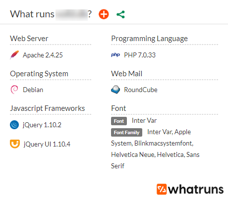

I'm still new to unRAID and Linux in general, so take my response with a grain of salt.
All I did to make it work, was using the Wordpress and mariadb docker, so most things are in the Wordpress docker, and it saves it in the mariadb.
I don't know what version it's using, but accordingly to WhatRuns (Chrome extension), it's this:
