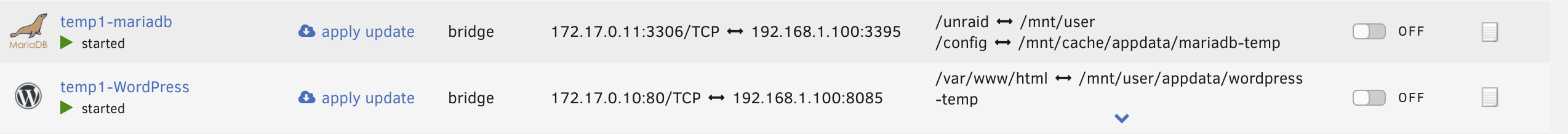

1556726018_ScreenShot2020-10-29at5_02_24am.thumb.png.b71442390bf4d3ede787c54f03b7f22e.png
See the "/var/www/html", this is the path (folder) inside the container, and the "mnt/user/appdata/wordpress-temp" is the path (folder) on your server. What version of docker wont matter.
So when you crank up a new container all files in "/var/www/html" (in this case all files in a new WP installation, the root of your site) gets copied to "mnt/user/appdata/wordpress-temp", after that on each update or restart of the container, all files in this folder should be persistent as docker wont copy and overwrite any files/folders with the same name.
