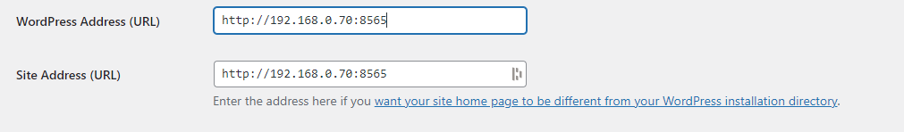

Hello All
I am after some help, as what ever I do ends up bricking my WP install and I end up removing it all and then having to start again.
So I have NPM setup to forward to the IP and port I am using for the WP Docker, and to force SSL - Same settings as I would use for say NextClould.
When I install WP I have to do it via the dockers IP over port 80, when I try and run the installer over HTTPS it errors. So when the install is done I end up with a wordpress site running but via port 80, and when I try and do https://IPADDRESS:PORT it fails.
So I go back to http and login to WP.
When I look to change any of these 2 URLS to either https://IPADDRESS:PORT or just IPADDRESS or even the external URL it just breaks the system.
How the heck do I setup the external URL within WP, and switch it over to SSL so NPM can forward the traffic and work like NextCloud does...
I am at a total loss.
Thank you for anyone who can help / advise.
5 hours ago, IKWeb said:
Hello All
Hi IKWEB,
Im not sure if I follow exactly what you are doing, or trying to do, but try this. First delete both the Wordpress folder and the database folder in unraid (to remove eventual old values, from previous installs). Then reinstall both, then make sure you can reach the Wordpress installation on your Domain, going through NPM, and start the install from there and set up your db etc. then it should work. After install you can not reach the WP install from your local ip address,
hope it helps,
kru-x
6 hours ago, Kru-x said:
Hi IKWEB,
hope it helps,
kru-x
Basically I cant get the installer to work over HTTPS so I have to do it over HTTP then when I Switch it after it breaks the WP install.
Once I install the container if I go to https://IPADDRESS:PORT the installer doesnt come up - but if I go to HTTP://IPADDRESS:PORT the installer works.
Check the settings in NPM, have you got "http" selected in Scheme,
It must be a setting, it should make no different installing WP.
Kru-x
Hang on, why do you say "https://IPADDRESS:PORT"? That is not right, should be your domain, you can't have https on the local IP address.
