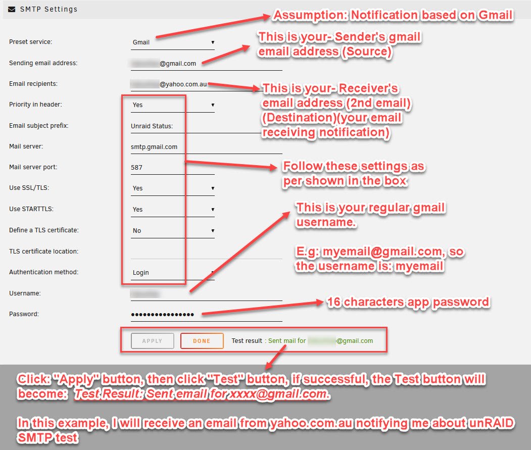

March 15, 20206 yr Hi All, Just want to share out my findings about unRAID notification. My notification settings are based on Gmail. This how-to will enable the user to send email notification from Gmail to Yahoo email. If you like my how-to, then make it a sticky. Thank you.🙂 ======================================================================== Requirements: A) Setup a gmail account. This account will be the SENDER's email address << Assumption: you have setup 2-step authentication via you mobile phone for logging into your gmail account >> B) Setup a second gmail or any other free webmail account. eg: [email protected] This account will be the RECEIVER's email address ======================================================================== You need to set up google App Password. 1) login into: accounts.google.com 2) Go to "Security" on your left section. 3) Under the heading: "Signing in to Google" 3.1) Click on App passwords 3.2) Sign in your normal gmail accounts 3.3) click: Select app, then select: Mail 3.4) click: Select device, then select: Custom 3.5) Give a name for the unRAID server e.g: midtowerunraid 3.6) Press Generate button 3.7) A window will pop out and app password for the device is display in the yellow box. Copy the password and keep in a safe place and save in notepad. This password is 16 character long. Next click the button: Done e.g: sskwowcomemtyufg <----- 16 character long app password. 3.8) Finally sign out all accounts Follow the steps below, to complete SMTP settings within unRAID server Edited March 15, 20206 yr by wepee

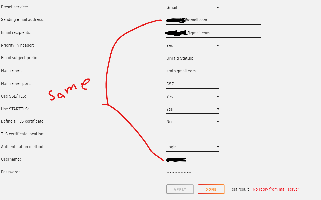

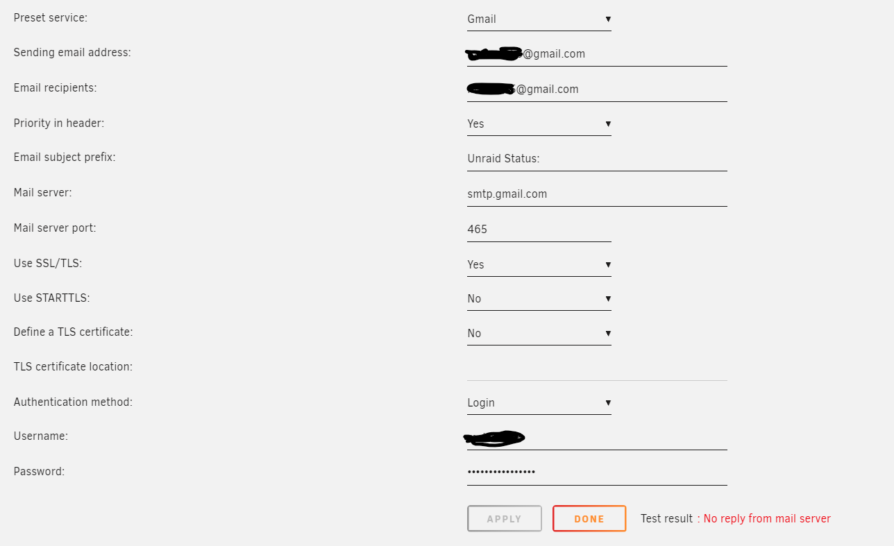

June 14, 20233 yr Greetings all, I have been pounding my head on the wall trying to get gmail notifications to work with no luck. I feel I have tried every combination avalible to try and log in. I have 2FA on, I'm using a new mail app password, I have tried 465 and 587 port, I have tried the login with and without the @gmail.com. I feel I'm missing something stupid, but I keep getting the error of "No reply from mail server". Can anyone give me some other ideas to look at, maybe a setting I'm missing in google or something. Any help would be great, thanks!!

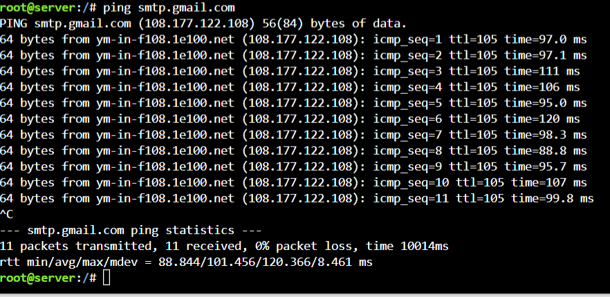

June 14, 20233 yr 9 minutes ago, mellow65 said: I feel I'm missing something stupid, but I keep getting the error of "No reply from mail server". Looks correct to me, can you ping smtp.gmail.com from you server?
June 14, 20233 yr Just now, JorgeB said: Looks correct to me, can you ping smtp.gmail.com from you server? I was just trying that, yes i can. Is there a way of pinging specific ports at smtp.gmail.com?

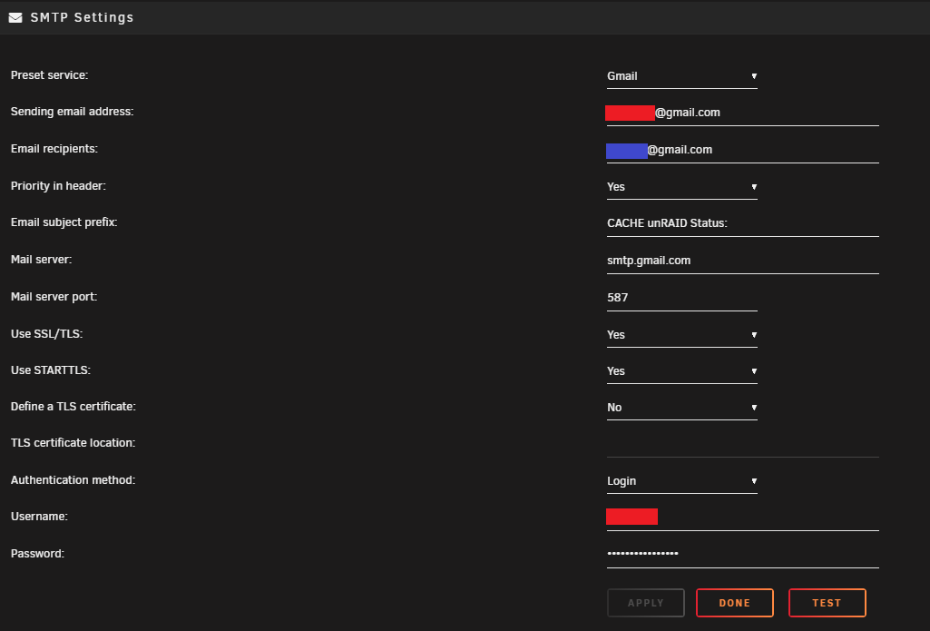

June 14, 20233 yr 36 minutes ago, mellow65 said: trying to get gmail notifications to work with no luck Here are my settings which work. The only difference I see other than the port number (which you have tried changing) is that I have STARTTLS set to No.
June 14, 20233 yr 46 minutes ago, mellow65 said: Greetings all, I have been pounding my head on the wall trying to get gmail notifications to work with no luck. I feel I have tried every combination avalible to try and log in. I have 2FA on, I'm using a new mail app password, I have tried 465 and 587 port, I have tried the login with and without the @gmail.com. I feel I'm missing something stupid, but I keep getting the error of "No reply from mail server". Can anyone give me some other ideas to look at, maybe a setting I'm missing in google or something. Any help would be great, thanks!! Spoiler Here are my Unraid settings below. Just make sure when you copy/paste the App Password from your 2FA section of your Google Account that it isn't adding an extra space or tab character at the start or end of it. Spoiler

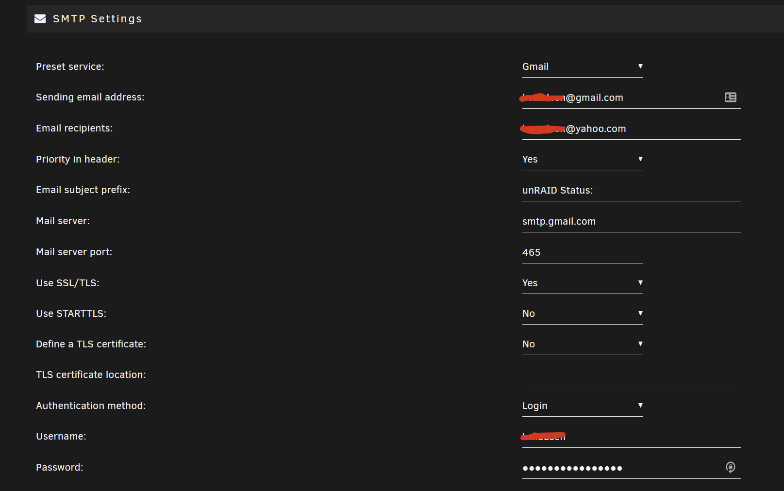

June 14, 20233 yr Still no luck. I tried swapping to a different gmail account to factor that varible out. Even more I tried a yahoo account still with no luck, with and without the @yahoo.com. But when I ping the yahoo server I get nothing back, the plot thickens. 🤔 Other things I've tried, currently my server is behind a VPN, I dropped that and still no luck. About the only other thing I can try is to take down my nextDNS resolver, and see if that has anything to do with it.
June 14, 20233 yr 12 minutes ago, axipher said: Here are my Unraid settings below. Just make sure when you copy/paste the App Password from your 2FA section of your Google Account that it isn't adding an extra space or tab character at the start or end of it. Reveal hidden contents I dropped the password into a text file to look at it first, no extra spaces or characters.
June 14, 20233 yr Ok so bunch more trying things with still no luck. I dropped my DNS resolver I dropped my VPN I changed DNS to 8.8.8.8 I redid an app password, dropped it into a text file to make sure there were no spaces or other weird things being copied in I tried 465 and 587 in all configurations I can ping smtp.gmail.com and get a respond I tried yahoo email with no success I'm out of ideas to try. 🤷♂️ I will say, the only time I get a different response than "No reply from mail server" is when I trying 587 and Use STARTTLS is NO. I still get the error "Cannot open smtp.gmail.com:587", while that doesn't fix anything, at least it's some sort of different response. Thanks for the input and I'll keep poking around and see if I find anything else.
