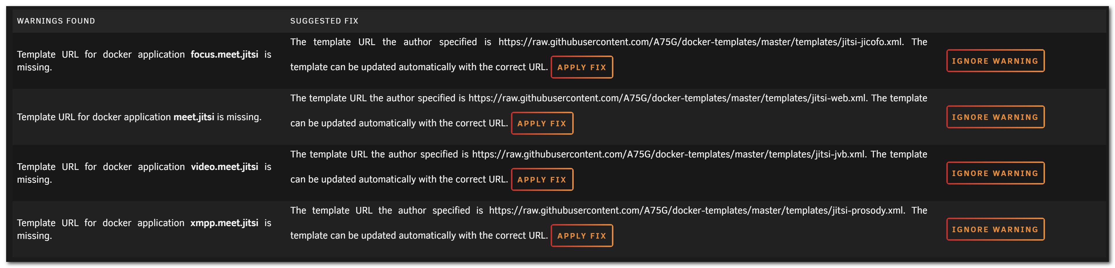

HI Guys
Mine works just like it says on the tin from the video
But i am seeing some errors in Fix common problems
Has anybody got the same errors and how do you fix them.
Do not say hit the Apply Fix button as it does not work :)
Please can you explain how to fix this issue if you have managed to fix it?

12 hours ago, OsoPolar said:
HI Guys
I am also seeing this error.   Everything with the meetings appear to work.  But it is frustrating to have errors...  if you figure out how to fix let me know.

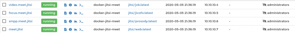

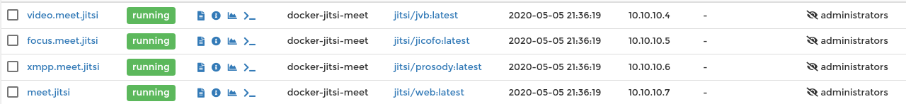

Also I am wondering  how so we update
The method I have found to update each of the Jitsi docker involves using Portainer.
In the Portainer GUI, click Stacks > selected docker-jitsi-meet -> select all and stop all -> Select each Container one at a time (i.e. click on it's name) -> Click Recreate and click "Pull latest image" and then "Recreate" -> once all are updated start all containers -> restart letsencrypt -> done
@SpaceInvaderOne Is there a better way?

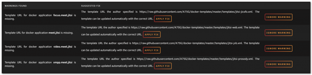

On 5/2/2020 at 5:24 PM, Michael Woodson said:
I have just followed that fully and mine are still showing update available and still got the fix common problem issue with template
Also, can you help enable Colibri for Jitsi stats? I can't seem to figure it out with this set up.
Thank you!
Edited by OsoPolar
I have the same thing.  The current situation is kind of messy since it was installed song docker compose so Portainer is pretty much like “it isn’t mine” and Unraids docker manager isn’t like “not me!”
I will probably reinstall the stack in Portainer or hopefully someone will roll an Unraid docker for jitsi that works well. It would actually be nice if they were rolled into one just for convenience.
also if you are using Nginx Proxy Manager, you need to expose port 5280 on the prosody container in Portainer.
I agree it is very messy and disjointed when you can use the website far easier.
If you link tinkering and having errors all over the place it is ok .
But i have OCD i cannot stand errors and messages and fix buttons that don’t work all over my dashboard.
I think it's going to have to go unless I fix is possible.

I have tried updating via the portainer route described above. It did update by look of it. But on docker page still see the "update available." warning..
I doubt it would fix the Unraid issue, but I have been contemplating switching over to Portainer for all my dockers anyway.

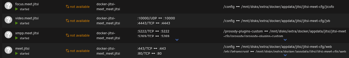

I've got a pfSense firewall forwarding 4443 and 10000 to my unraid IP.  I've got other containers working with the LetsEncrypt reverse proxy.  I'm assuming I have something wrong in my jitsimeet.subdomain.conf file but I'm just using the one attached to SpaceInvaderOne's video with no changes.
The only hint that I can see is that in Portainer I don't have any published ports against any of the containers (I see them in the video).  I can ping 'meet.jitsi', etc from the LE container so I know it can see/reach the four jitsi containers - I'm just not sure about the ports.

I note that he uses a special network for his reverse proxying so if you have it setup the same way - you need to join that network in portainer.
Also, oddly enough, if you look at spaceinvader's video and even my own docker page, I don't have any ports mapped for xmpp besides 5280 that I manually added.
@tknx I noticed that but was trying to keep my current setup as the rest of my reverse proxy/containers work ok with what I have now, which is a VLAN created off of BR0:
I like being able to use a VLAN as I have a bit more control in pfsense for firewalling, etc.
I went back to original video that he setup that Proxynet (the first 'setup a reverse proxy' one) and all he does is 'docker create network proxynet' but that must register it differently for Docker to use.
I noticed there is a difference between a VLAN created in Unraid and a Docker network:
I suspect it's the 'bridge' that allows it to work with Docker better?  I thought I might be onto something when I found an option in the Docker settings for 'Allow access to custom networks', which I've now enabled but that hasn't made a difference.
I'll try swapping my LE container and the rest of my proxied containers across to a new docker network today and see how I go - thanks for the suggestion.

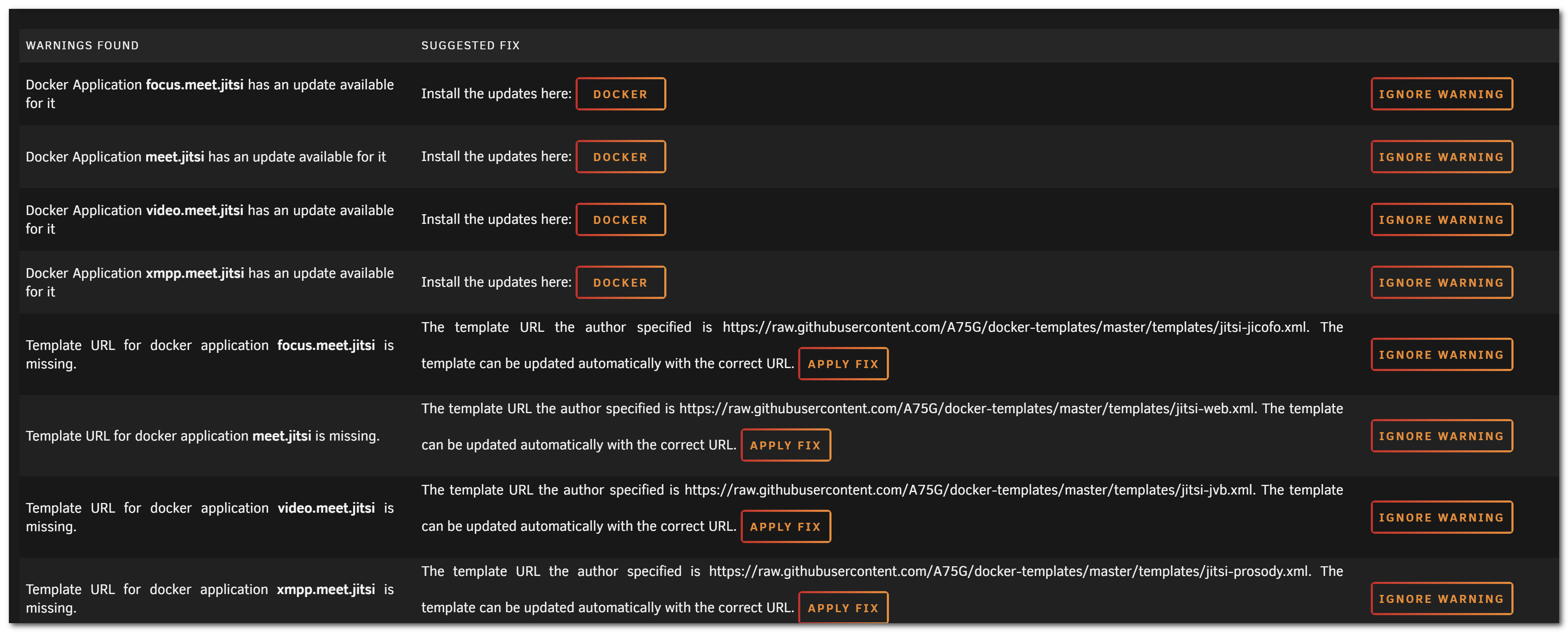

Has anybody worked out how to update the containers correctly and hide the errors?
Going thru portainer you click on the container. Then there is a red button on the top that says "Recreate." After you click that, flip the toggle on that says pull latest image. Then recreate. Be advised that your container names will change and the proxy networks may not persist. You'll have to make those changes.
If that doesn't work, run thru the docker-compose commands in the terminal and rebuild the stack.
Neither of these suppressed the warnings I got in Fix Common Errors and the docker tab says I need updating.
I personally wouldn't update unless there's compelling reason to do so. Ed helped me troubleshoot all this after I updated and broke my setup. I vowed not to update jitsi until after my daughter's virtual birthday party next weekend.
There is no "recreate" button for me. Any idea why I'm not seeing it? Thanks.
