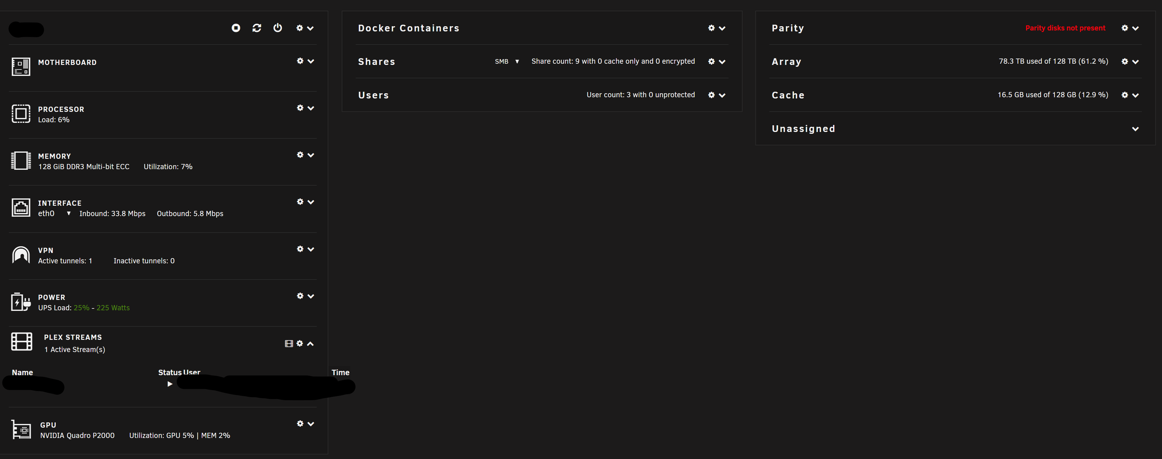

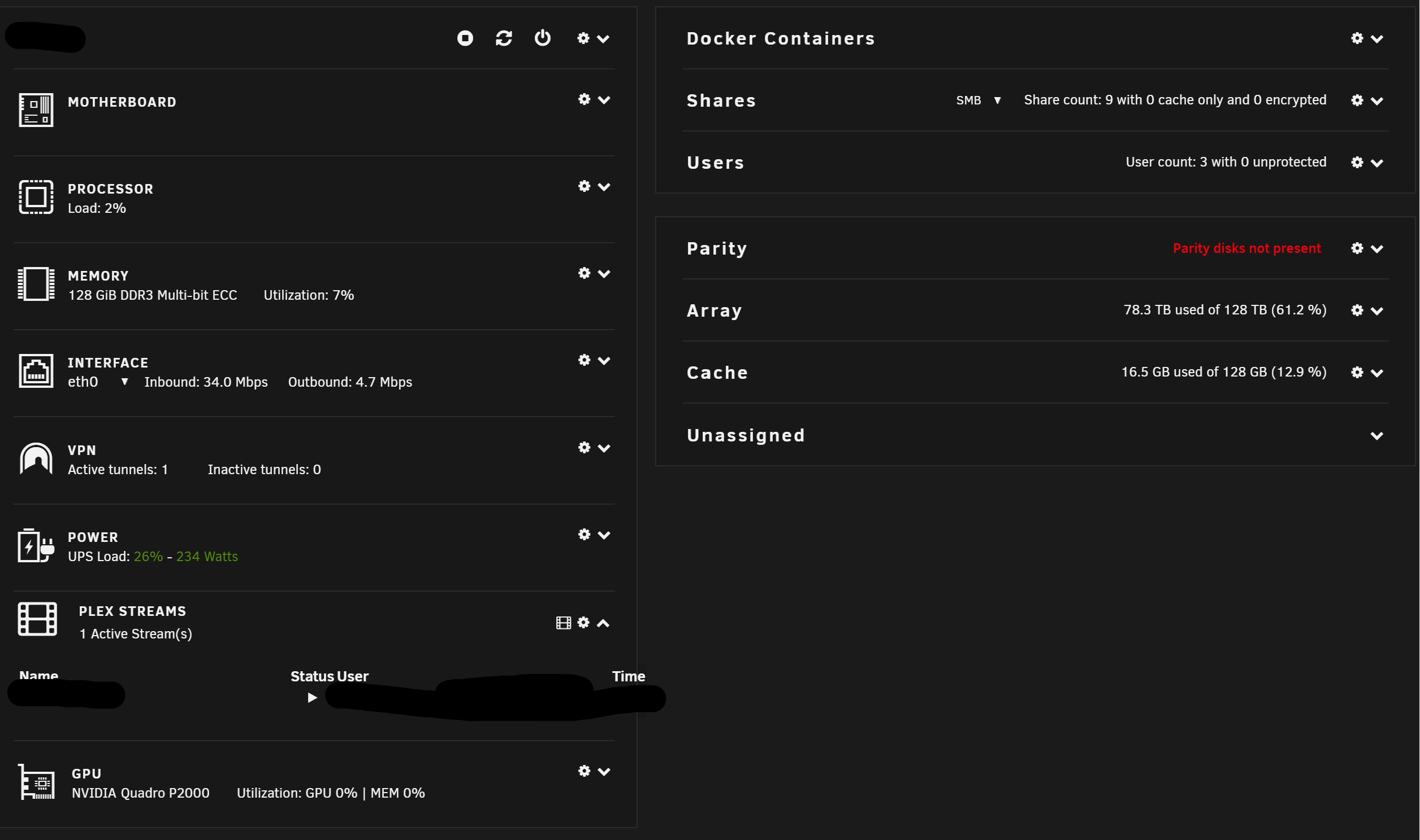

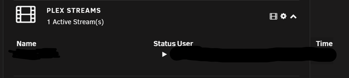

Unraid-arr Posted July 12, 2020 Share Posted July 12, 2020 On 6/30/2020 at 10:49 AM, dorgan said: Warning issue should now be resolved, with version 2020.06.30b. Also, so should the dashboard display, but let me know if not and I will down grade to previous version of unraid without translation support Hey @dorgan, Thanks for the update, Sorry I just saw your comment today after an update was pushed. Unfortunately the Dashboard Widget still is not in bounds of widget. Upon further Inspection, the widget is out of bounds on 3 column or 1 column layout width. On 2 column layout it is OK for the most part. Below are 2 screenshots for clarity. - 3-column layout - For 2 column layout wider than this the widget is OK. This is the boundary case. The Warning issue was actually not visible now on the NAVBAR page, so that may have fixed. Cheers on the good work! Quote Link to comment
dorgan Posted July 14, 2020 Author Share Posted July 14, 2020 On 7/12/2020 at 12:10 PM, Shomil Saini said: Hey @dorgan, Thanks for the update, Sorry I just saw your comment today after an update was pushed. Unfortunately the Dashboard Widget still is not in bounds of widget. Upon further Inspection, the widget is out of bounds on 3 column or 1 column layout width. On 2 column layout it is OK for the most part. Below are 2 screenshots for clarity. - 3-column layout - For 2 column layout wider than this the widget is OK. This is the boundary case. The Warning issue was actually not visible now on the NAVBAR page, so that may have fixed. Cheers on the good work! What version are you running? I thought I noticed and fixed this in the latest release. Quote Link to comment

Unraid-arr Posted July 27, 2020 Share Posted July 27, 2020 On 7/14/2020 at 10:18 AM, dorgan said: What version are you running? I thought I noticed and fixed this in the latest release. Hey @dorgan, Running 2020.07.23 and that issue is resolved. I see others were having this issue as well. So that should help them as well. My recommendation would be to keep Name & Status in one line and User & Time in next line for better readability purposes and that would also give enough room to display complete names instead of cutting them off. Thanks for the update though! Cheers! -Shomil Saini Quote Link to comment
dorgan Posted July 30, 2020 Author Share Posted July 30, 2020 On 7/26/2020 at 11:43 PM, Shomil Saini said: My recommendation would be to keep Name & Status in one line and User & Time in next line for better readability purposes and that would also give enough room to display complete names instead of cutting them off. You should be able to see the full name if you hover over the name for a couple of seconds. Quote Link to comment

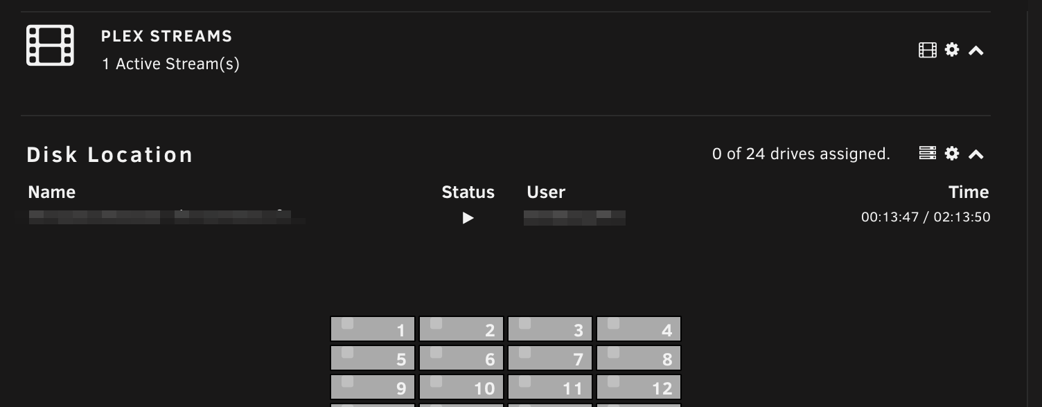

jrdnlc Posted September 16, 2020 Share Posted September 16, 2020 (edited) Any plans on adding support for HW transcoding? Like have it show when a stream is being HW transcoded. I'm also having the same issue @Shomil Saini is having with the dashboard widget. This only occurs when using it on the left panel. If i move it to the right panel it works fine and doesn't overlap other widgets. Edited September 16, 2020 by jrdnlc Quote Link to comment
dorgan Posted September 18, 2020 Author Share Posted September 18, 2020 On 9/16/2020 at 3:24 PM, jrdnlc said: Any plans on adding support for HW transcoding? I believe it already does, but will double check and if not will look into adding it. On 9/16/2020 at 3:24 PM, jrdnlc said: I'm also having the same issue @Shomil Saini is having with the dashboard widget. This only occurs when using it on the left panel. If i move it to the right panel it works fine and doesn't overlap other widgets. He reported his issue as resolved with the last update, if you are still having an issue please let me know what version of unraid you are running and attach a screenshot so I can see what its doing. Quote Link to comment

jrdnlc Posted September 19, 2020 Share Posted September 19, 2020 17 hours ago, dorgan said: I believe it already does, but will double check and if not will look into adding it. He reported his issue as resolved with the last update, if you are still having an issue please let me know what version of unraid you are running and attach a screenshot so I can see what its doing. I don't see it showing if it's either a software or hw transcode. Here is a photo of the overlapping issue with the Disk Location plugin Quote Link to comment
dorgan Posted September 19, 2020 Author Share Posted September 19, 2020 45 minutes ago, jrdnlc said: I don't see it showing if it's either a software or hw transcode. Here is a photo of the overlapping issue with the Disk Location plugin Ok I happen to use this plugin, so I'll take a look... Quote Link to comment
