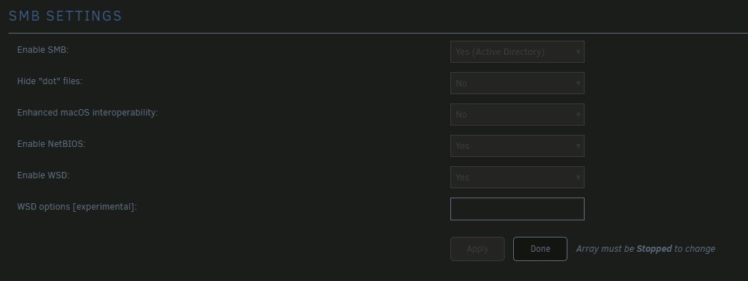

Quickly looking at the system log, when it tries to mount the share, it says SMB must be enabled to mount a share. SMB IS enabled in the settings. See image.

2 minutes ago, dlandon said:
Ok, I see the problem.  It's from a recent change I made.  I'll release a fix today.
That's great! Thanks so much!

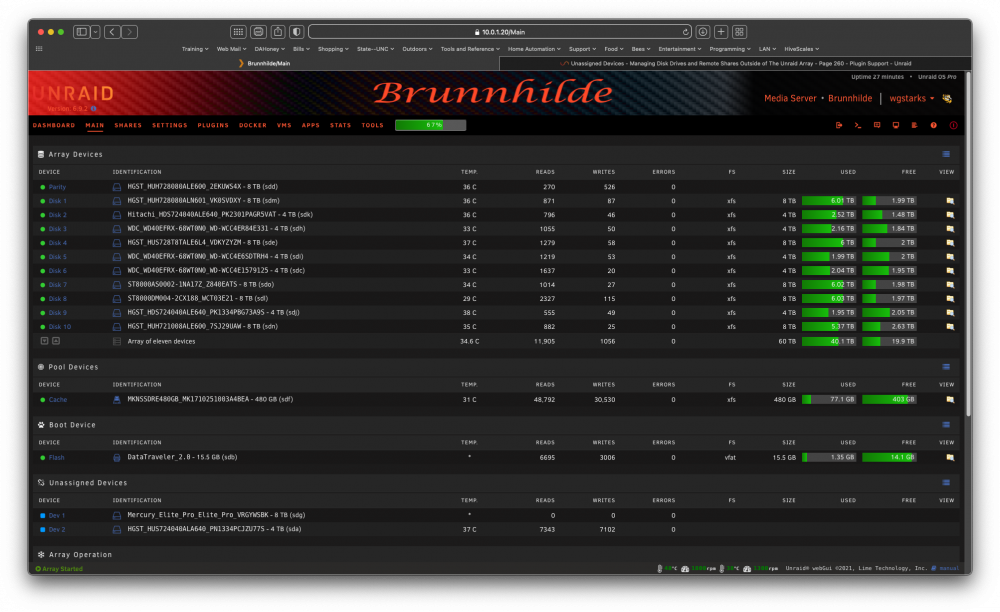

Had my server freeze last night due to an OOM problem. Had to hard reset. After rebooting UD no longer shows my unassigned drives. If I uninstall the plugin I see the drives on the main tab but with the plugin installed that section is blank. I've tried deleting the plugin and it's config and doing a clean install but no luck. Not sure what to try next.
brunnhilde-diagnostics-20211201-0754.zip

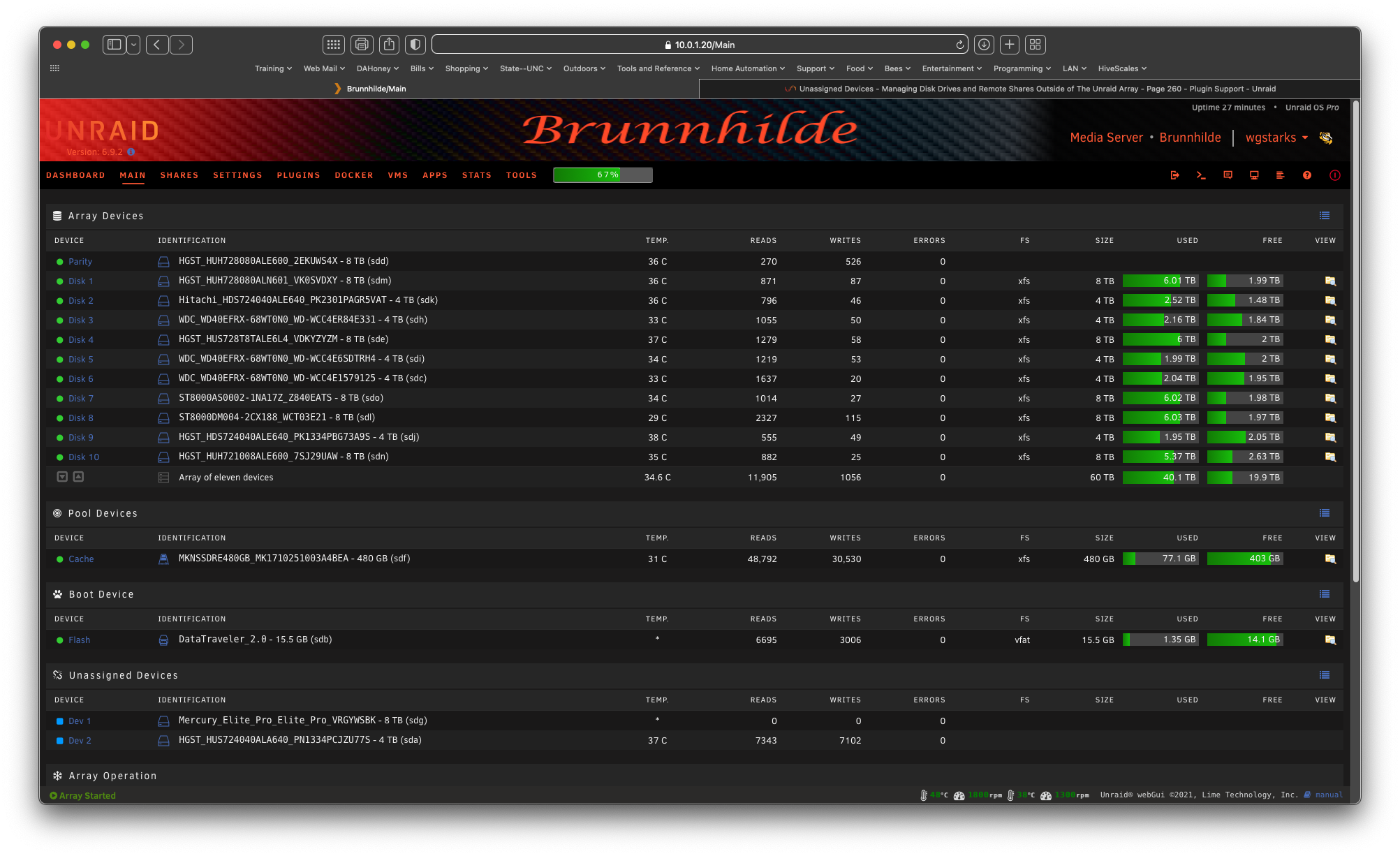

Uninstall the UD plugin and give me a screen shot of the array disks and UD disks.
I found this in the previous logs (log server)-
/sbin/mount -t xfs -o rw,noatime,nodiratime '/dev/sdf1' '/mnt/disks/deluge'
I tried using it after adjusting to the current designation (/dev/sda1) but get an error that mount point deluge does not exist. Maybe I need to create a share "deluge" in the UI first?
318679479_ScreenShot2021-12-01at4_07_10PM.thumb.png.274f54c044b98b265faa9ee25a55946e.png
Looking at the disk log I don't see anything to indicate that the plugin ever tried to mount it. It shows where I mounted it via terminal but not much before that.

So when you install UD the two unassigned disks don't show up?
Correct. That section of the main tab is blank.
