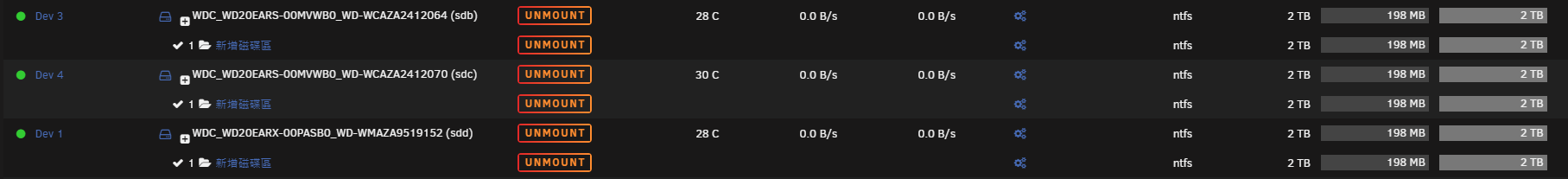

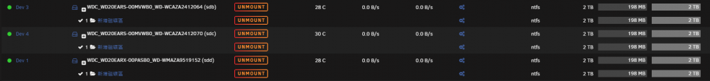

I have make some test on mount Windows format NTFS disk, sdb ( dynamic single disk ) and sdc + sdd ( dynamic mirror disk ), all could mount by UD individual, so no much idea for your case.
This is super helpful, thanks for doing some testing on my behalf!  I remain stumped, but it seems next steps are to get another external SATA-to-USB hookup and see if that changes anything on a windows machine.
In the mean time, anyone have any other thoughts on what I might do to get it mounted?  I'm still stumped as to why my file system shows up correctly in MiniTool but not in UR.
