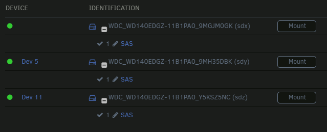

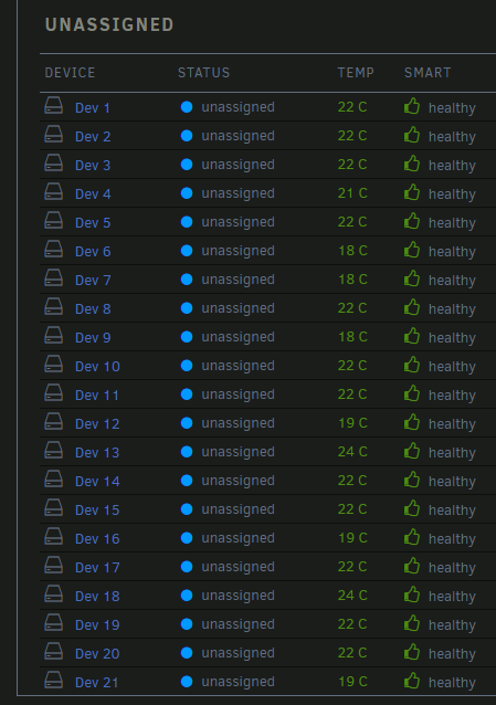

I have backup unassigned.devices.cfg and delete it, try does current release have detect disks normal. BTW, result still negative.
- Only two disk show and first row blank name ( after 1st refresh )
- Each refresh will show one more disk and first row still blank name
- All dev always correctly show on dashboard page
- I make UD have 21, 9 or 3 disks also got same issue
- when problem occur, some process cause high CPU loading
- Restore backup cfg file, then all work again

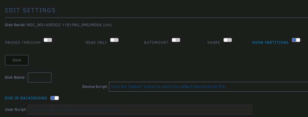

Thought my server just kicked off my UD's. Rebooted ( after a LONG uptime ), still down, came here to check out what's going on.
Went to historical devices, clicked on each disks settings.
Hit save
Hit done
Each is back where it's supposed to be.
Cool update.
Hit save
Hit done
The new disk alias feature does things a little different with regard to Historical devices.  When a new device is hot plugged UD assigns the 'devX' to the hot plugged device and creates an entry in the unassigned.devices.cfg file.  When the device is removed, it will show in the Historical devices list.  Normally a historical device would not show unless the user made some setting changes on the device.
What you did was to overcome something I am not getting right when UD does the saving of the 'devX' and there is no current entry for that serial number in the unassigned.devices.cfg.  I'll try to reproduce this issue and see if I can resolve it.

I've just released a fix for the disks not showing in UD and the blank device.
