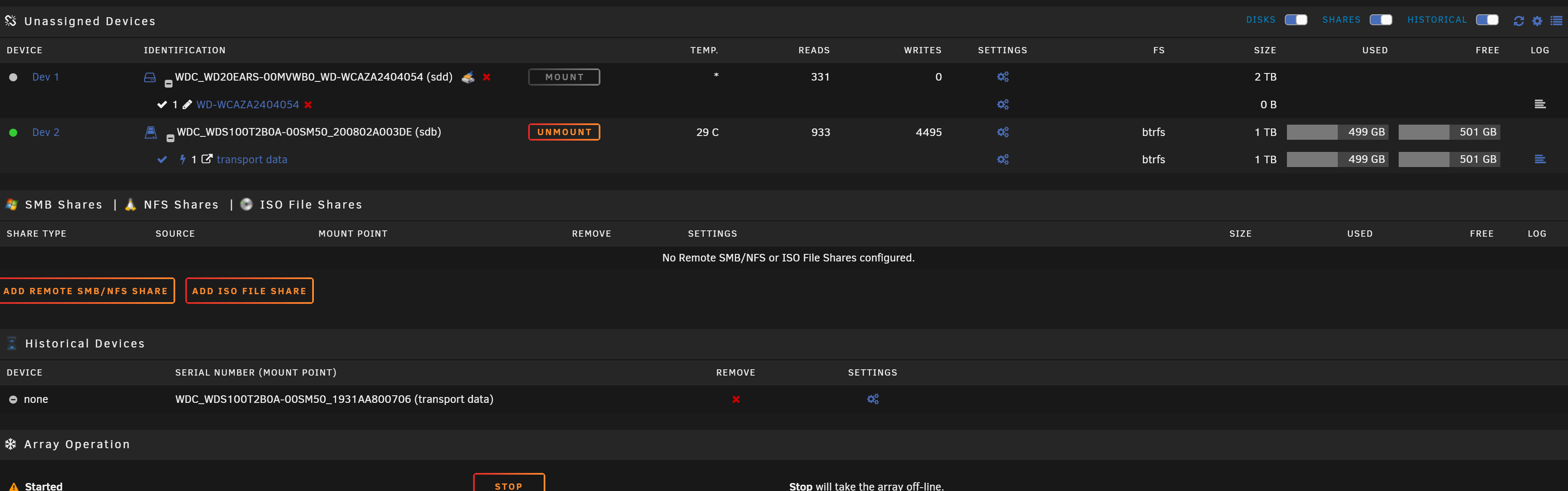

ah ok  as i followed what you said
unmount the disk.. then click the lightning bolt    to run the system check
thats why i said it wasnt working..
ah ok
so what i found was even if i do "mv  command line   or a script "  it will run
but say if i have
Folder
test  and all the files are in the folder test
when it moves over i get the error  but it moving all the files that are in the test folder  into the root of the folder  so a  .. of test
and i can use  Krusader  fine  its moving the files  when i highlight and move..
but  ill run that scrub test now then... the lightning bolt does nothing  it just sits there as i let it sit there for 30 min  and on a SSD i dont think its working ?
but ill run the test again

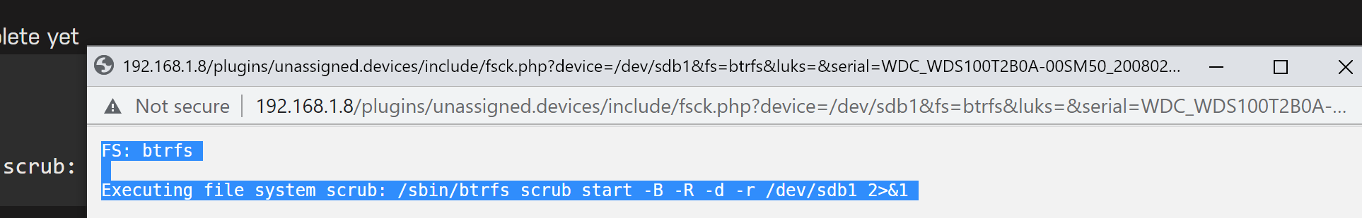

running test again.. how long should it take a 1TB ssd?
update:
i think test is done.. there is no drive activity.. the Window  stopped spinning top left  beside the 192.168.x.x
but it hasnt said its completed i dont see a log file to see any info?
Edited by comet424

and still nothing to say  complete yet
FS: btrfs
Executing file system scrub: /sbin/btrfs scrub start -B -R -d -r /dev/sdb1 2>&1
still only says that
doesnt say its complete.. doesnt say it crashed   no log file nothing..  all i can see is there is no file activity  looking at the drive under   read and write section
here is pic  all i can tell is the globe is now a globe wehre it was doing a spinning
Edited by comet424

2 hours ago, comet424 said:
getting duplicate device error..  general chat  had me post in here as Safe mode cleared it but rebooted back and its back
Can you post a screen shot of the UD page.  It appears you only have one UD device and it's an nvme disk.  All the BTRFS errors you are seeing are on array disks.  These errors are generated by udev.  The messages are generated when UD does the auto mount of disks.
After you post a screen shot of UD, uninstall the UD plugin and see if that makes a difference.

ok i was able to get the old diagnostic  with all those  duplicates you see.. and a new one where it has just 1
you will see the history one  also stay transport data
i use 2 SSDs  labeled   transport data
so when i see my sister  we swap SSDs and  i give her a blank she gives me her stuff wants backed up  and when she shoves in  it just works..   but i been finding issues lately  with MV too that i asked help for so  hope that fixes it..
but ya i found that duplicate..
so mitch server gets 1 error  but has a couple UD drives
 mitchflix server gets those multiple  duplicates   but has 0 UD drives
mitchsserver-diagnostics-20220203-1123.zip mitchflix-diagnostics-20220203-1132.zip
