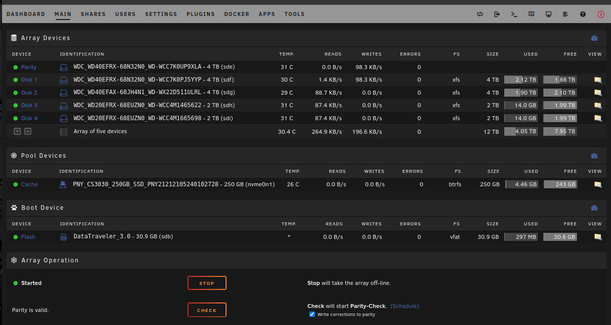

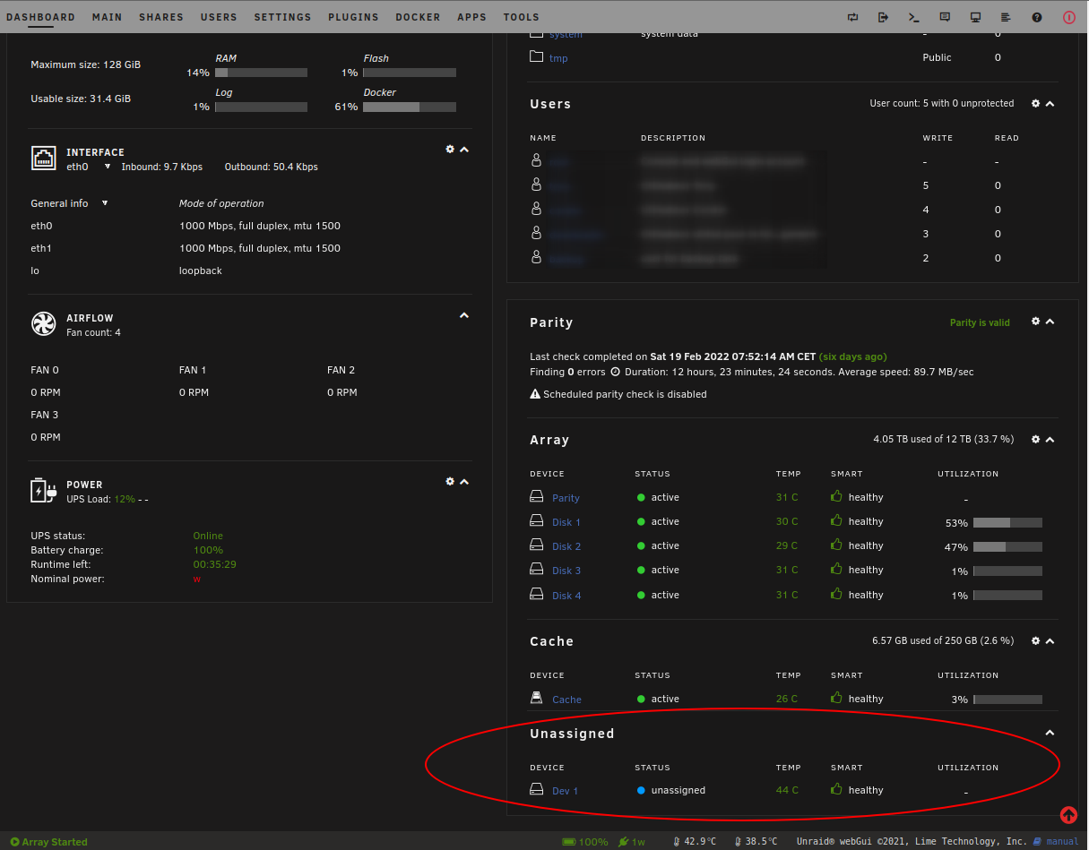

Hello,
After updating to version 2022.02.24a, I no longer see my external hard drive from the 'Main' tab in UnRaid :
Before this version, I could see my external hard drive in the list of available hard drives with a 'MOUNT' button from this tab.
However, I see it in the list of hard drives from the 'Dashboard' tab but without a button to mount the hard drive:
Can you help me please?
Thx in advance.
Your unassigned devices tab is missing.  Try uninstalling and reinstalling the ud plugin.  If that doesn’t work, reboot.
Thank you for your reply.
This works by uninstalling and reinstalling the plugin.
Thanks again.
