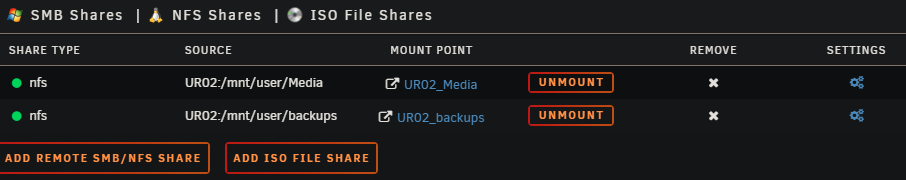

Hi All,
Recently I mapped NFS shares from another Unraid server to use in some dockers on this server. That all seems good and working in dockers like I want.
However recently I tried doing some rsync of some files from Server 1 to Server 2 using this mapped share. Anyway it didn't seem to like that at all. CPUs were randomly and slowly filling up to 100% and not coming back. To the point it would just crash the Unraid UI or become super unresponsive. These files were old VMWare VMs, so some of the individual files were over 1tb. Not sure if that makes it different?
Anyway, it's are transferring just fine now in windows using UNC paths. After this one is done, i'll try another one in rsync and grab logs. I was seeing RED errors. Just forgot to save them. This was yesterday. Processor is a threadripper with 24 cores and 32 RAM.
Most of the time the server sits at 20% CPU and 40% RAM. But running rsync using those mapped shares and it goes crazy. Actually, I think I also tried in Krusader transfering the same files using the mapped shares again and krusader became unresponsive too and had to kill it.
So it crashed transferring like this:
rsync -rtvv /mnt/user/backups/EX1 /mnt/remotes/UR02_backups/EX1 --log-file=/mnt/user/Other/rsynclog.log --progress
I think some of the small files worked.
Currently transferring like this (Windows Explorer):
\\192.168.0.5\backups\EX1
\\192.168.0.8\backups\EX1
Maybe I have a config wrong somewhere, any ideas on what I should look at first?
Dockers seem OK using them.
Cheers
Are you using NFSv3 or NFSv4?
How do I check?
Running UnRaid Version: 6.9.2
You'll be running NFSv3.  Go to the UD settings and you'll see the setting for NFS version.  You'll need 6.10 for NFSv4.
If you look at your log you'll probably see a lot of stale file handles.  When that happens, everything stops.  NFSv4 solves this and other issues.  NFSv3 is very troublesome and you shouldn't spend a lot of time trying to sort it out.  It's not worth it and you won't get anywhere.
How about using SMB for now?
Ah OK. That makes sense. No problem. I can work around this for now and revisit it later.
Funny enough, because the 2nd server is not my primary, it's already 6.10. I probably should keep them at the same version moving forward. :)
Thanks for the update.

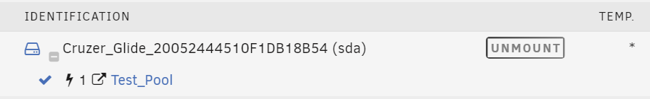

Can anyone explain the grayed-out "ARRAY" label on my usb drive..
I had it plugged into a usb3 port but lsusb -t showed that its was in fact not usb (although marked blue) so i performed (using the unmount button on UD) to unmount it. Nothing wrong there.. The disk was unmounted and could be remounted using UD.
Then I removed the usb-disk and plugged it into a blue usb socketed on the back-plane of the motherboard.. Now lsusb -t shows that it is on a and usb3 hub, but I can no longer mount or unmount it - but it is accessible -
And here is a part of the unraid log:
Feb 22 16:04:35 Tower kernel: sd 0:0:0:0: [sda] Write Protect is off
Feb 22 16:04:35 Tower kernel: sd 0:0:0:0: [sda] Mode Sense: 4f 00 00 00
Feb 22 16:04:35 Tower kernel: sd 0:0:0:0: [sda] Write cache: enabled, read cache: enabled, doesn't support DPO or FUA
Feb 22 16:04:35 Tower kernel: sda: sda1
Feb 22 16:04:35 Tower kernel: sd 0:0:0:0: [sda] Attached SCSI disk
Feb 22 16:04:35 Tower rc.diskinfo[9404]: SIGHUP received, forcing refresh of disks info.
Feb 22 16:04:37 Tower unassigned.devices: Adding partition 'sda1'...
Feb 22 16:04:37 Tower unassigned.devices: Mounting partition 'sda1' at mountpoint '/mnt/disks/USB_DISC_4T'...
Feb 22 16:04:37 Tower unassigned.devices: Mount drive command: /sbin/mount -t 'ext4' -o rw,noatime,nodiratime,nodev,nosuid '/dev/sda1' '/mnt/disks/USB_DISC_4T'
Feb 22 16:04:38 Tower kernel: EXT4-fs (sda1): mounted filesystem with ordered data mode. Opts: (null)
Feb 22 16:04:38 Tower unassigned.devices: Successfully mounted 'sda1' on '/mnt/disks/USB_DISC_4T'.
Feb 22 16:04:38 Tower unassigned.devices: Adding SMB share 'USB_DISC_4T'.
Feb 22 16:04:54 Tower unassigned.devices: Refreshed Disks and Configuration.
Feb 22 16:04:54 Tower rc.diskinfo[9404]: SIGHUP received, forcing refresh of disks info.
Don't understand this line tho: "unassigned.devices: Adding SMB share 'USB_DISC_4T'."
I can browse the file and directories on it by clicking the label and is also accessable from the terminal.
Any idea's ?
10 minutes ago, sjoerd said:
Any idea's ?
This generally happens when a device is not recognized by Unraid as unassigned.  You can tell because the device designation is sda and not  'Dev X'.  Try clicking on the double arrows on the upper right hand part of the UD screen and see if that fixes it.  There is a bug in UD that may be causing this that is fixed in the next release.
