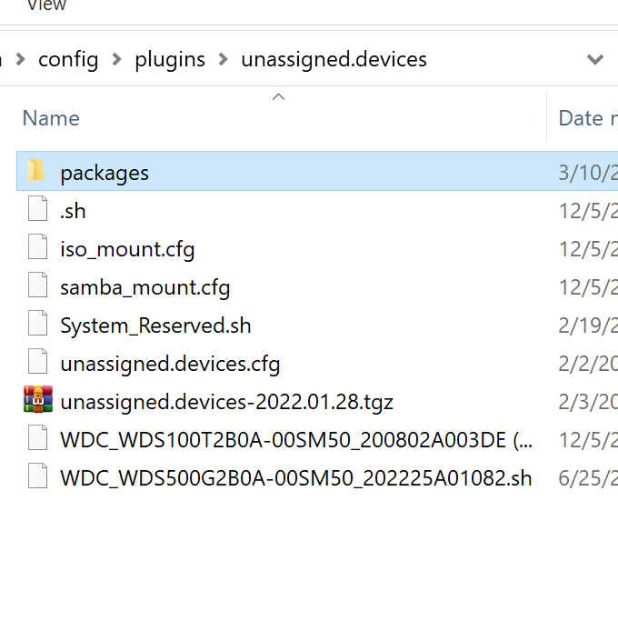

so i looked on her flash drive dunno if it helps  i looked in the plugin directory
mitchflix-diagnostics-20220203-1236.zip
those 2 drives arent installed anymore nore are in the system or historical... could that be causing the dup issues

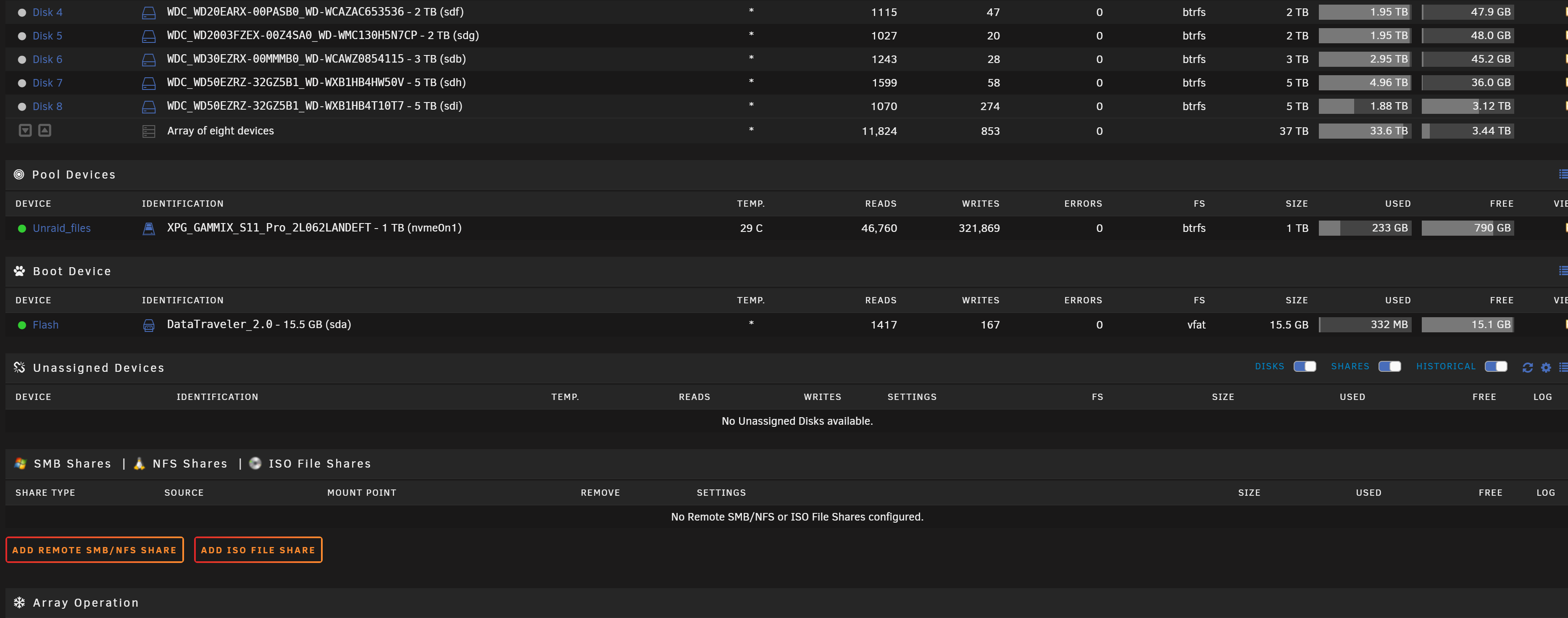

4 minutes ago, comet424 said:
there was no issues.. i then reinstalled UD plugin and Plus and rebooted the server and the dups are back
If you are talking about the disks on this screen shot, they are different disks with the same mount point (you need to change one to not be a duplicate).  This is correct, they are different disks.

here ill make it clearer
this one is getting the dup errors   but has 0 historical  0 ud
so i was thinking maybe  the dup error unknown is..  that when i clicked X  to remove teh historical drives.. it never deleted it off the Flash  and the UD plugin is conflicting those files with the whatever.. i didnt delete it off the flash  just incase need it for debugging
mitchflix-diagnostics-20220203-1306.zip
24 minutes ago, comet424 said:
but what i mean is  the Flash Folder  shows the 2 Drives  i no longer use in that Server
and they are not in the Historical  Part.. as i clicked  X  to remove them a while ago
so for my last post  techincally i shouldnt have those 2 drives in the Folder correct..
Those are script files you once used.  You can remove them.
oh ok... so that blows that idea of the dup uknown error figured that was the issue..  those 2 files
can you see anything in the diagnostics that keeps bringing that error?
ill delete the 2 files and do a reboot
so deleting.. and doing a reboot..  doesnt fix the unknown error.    if there is anything you want me to look for let me know

44 minutes ago, comet424 said:
Ill delete the 2 files and do a reboot
Those files are not used unless the disks are installed in UD.  Rebooting won't fix anything as you have seen.

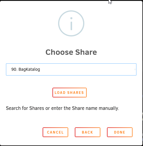

After one of the later updates, adding SMB shares with periods or spaces in their name from a Synology NAS no longer works properly.
It will automatically remove the period and space from the share name, making it then try to connect to a non existant share, resulting in this in samba_mount.cfg:
[//10.10.11.200/90. BagKatalog]
protocol = "SMB"
ip = "10.10.11.200"
path = "90. BagKatalog"
user = "user"
domain = ""
pass = "pass=="
share = "90BagKatalog"
mountpoint = "BagKatalog"
automount = "yes"
[//10.10.11.200/90BagKatalog]
protocol = "SMB"
ip = "10.10.11.200"
path = "90BagKatalog"
user = "user"
domain = ""
pass = "pass=="
Is added in as:
(2nd one is how it's added now, 1st one is how it used to be added)
Still works if manually adding it to .cfg and then refreshing.
I assume it might be the 2022.01.02c update:
Add: Check for safe name whan a SMB/NFS remote share path is added.
This is also "safe"ifying the name of the source share, which makes it not be added correctly, i assume is the case here.
Edited by PeritusTV
Fixed in the next release.

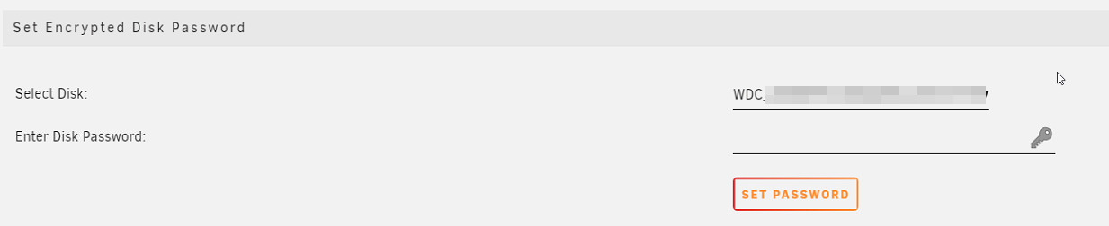

@dlandon
It would be nice to prompt for a password if no password was added to the settings while mounting a LUKS disk.
If its setup, the prompt could be still shown, but the password would be pre-filled (* * * * * *). I think this would make it more clear for the user how to mount encrypted disks.
The problem with prompting for the password on an encrypted disk is that it cannot always be done from the UI.  If a user clicks the mount button on the UI, it may be possible to prompt at that point, but if a disk is auto mounted, it's difficult to prompt for a password because there is a background script doing the mounting and it is not UI aware.  That's why the password is a configurable setting, so the mount can happen whether or not the UI is running at the time.

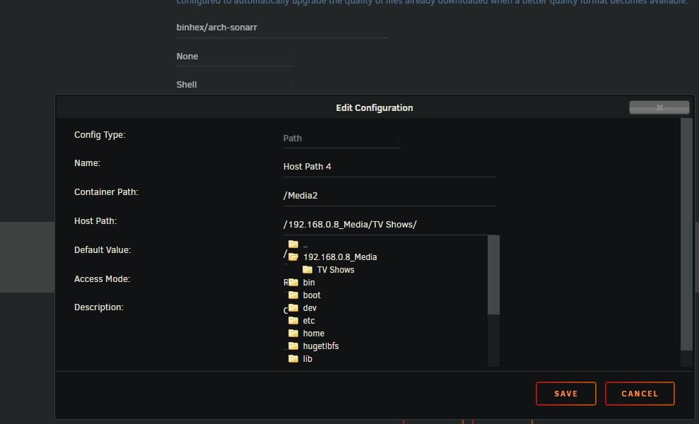

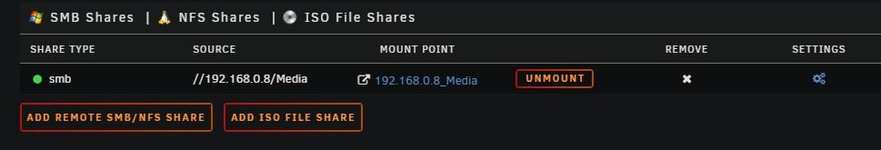

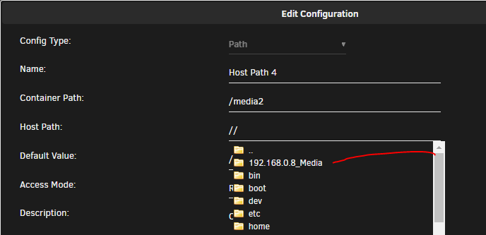

I'm trying to make an Auto Mount share accessible to my dockers from a 2nd unraid server.
It seems to successfully auto mount and I can browse files from the 2nd unraid server on the main unraid server file browser.
But when I added the path to my docker, it seems like only the top path is visible, I can't see any of the files inside when I try to use the path in the docker.
Any ideas or settings I need to check/double check?
Access Mode
7 hours ago, trurl said:
Access Mode
It's currently read/write.
I tried 'read/write shared' and got this.
Then tried 'read/write slave'. The docker updated OK, but it fails to start.
The other share (which is local to that unraid server, so it's not the same I guess) is set to just read/write. But maybe it's not supposed to be the same when it's a share from a separate unraid server.
Edit:
I should add... maybe this adds an extra level of complication to this setup as well, but the network for this docker, runs through another docker. Like this;
Maybe this will be my limitation :(
As I don't really want to change that.
Edit2:
I can ping it from that Docker tho;
hmmmm.
Edited by cappapp

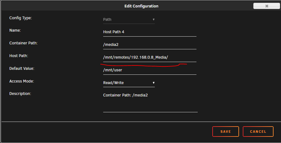

I just figured it out.
In the Docker if I use the full path and not the 'shortcut path'?? it works as I want it.
Back in the parent directory it was listed there, so I just choose that by default.
Thanks for helping me checkout more things :)
