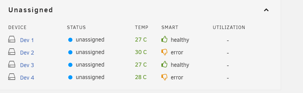

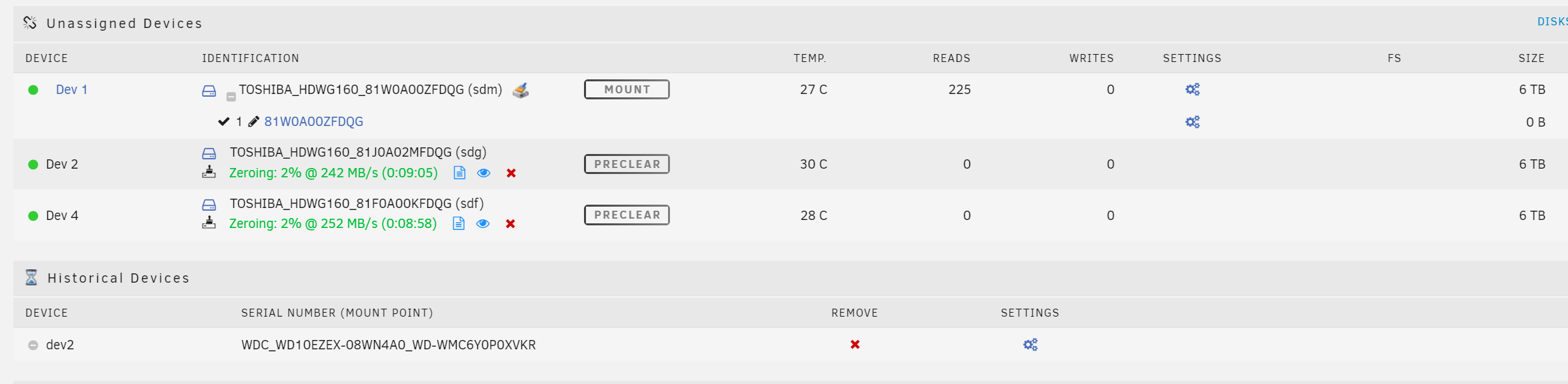

Does anyone know why I would have an unassigned drive show up on the "Dashboard" but not appear in the Unassigned Devices window on the "Main" page.
See two photos below:
A little background.
  • I routinely have two devices connected "unassigned" at all times.  One is mounted as a shared drive outside the array and used as a backup drive.  The other is a warm spare.
  • Periodically I have added one or two drives on Esata ports to preclear through unassigned devices and have never had issues.
  • This time my backup drive no longer shows up in the "unassigned" connected drives.  Instead its under "historical devices" yet the shared drive is visible and works.
  • A few restarts trying to troubleshoot and it appeared back on Unassigned as connected.  I think I did refresh the unassigned drives button in this operation and that is what I attributed it coming back too.  Note: I did also disconnect and reconnect the Esata drives, rebooting during this process.
  • Concurrently I have another issue I'm trying to troubleshoot, where I am getting UDMA errors during the "write zeros" operation of preclear for the two added drives.  I don't believe this has anything to do with the problem here, and believe I've tracked it to the power cable.  I've just started the two drives concurrently "writing zeros" under preclear and will know in a few hours.  Link for more info here:  https://forums.unraid.net/topic/119010-errors-during-pre-clear-2-drives-simultaneously/?tab=comments#comment-1089117
It seems every time I reboot the my unassigned devices change which is Device 1,2,3,4.  I haven't figured out what is driving that but it doesn't appear driven by what port they are connected too because it floats.
Is this possibly driven by the backup drive previously being "Dev2" and now a different drive has taken the "Dev2" assignment?  Should I just red-x the Historical Drive? I don't want to lose settings for that device.
