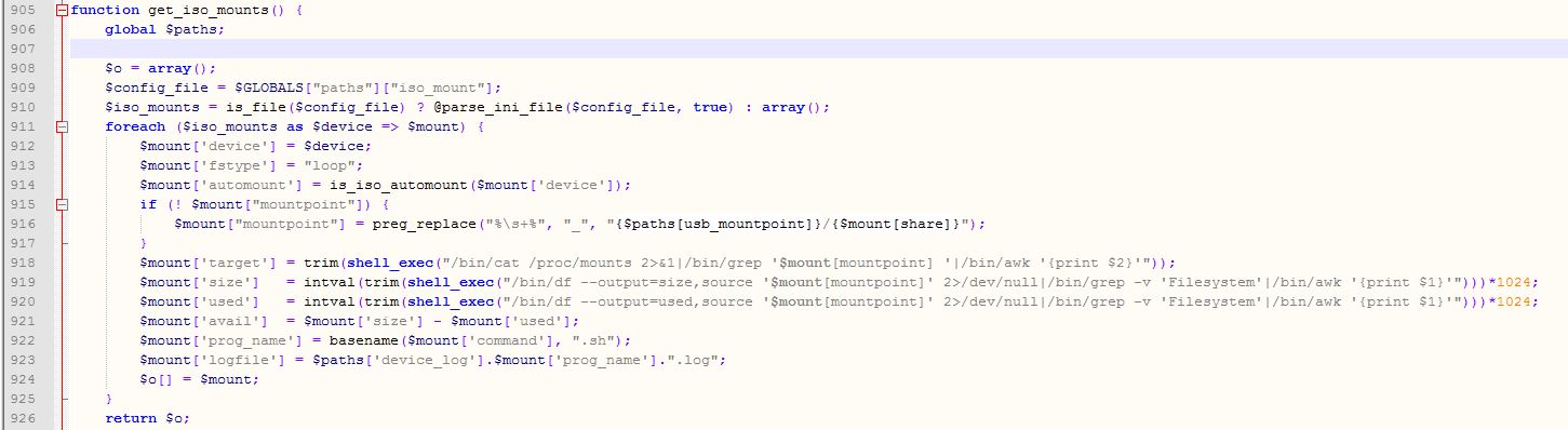

Hello,
I have a error message :
Warning: Invalid argument supplied for foreach() in /usr/local/emhttp/plugins/unassigned.devices/include/lib.php on line 911
I have opened the lib.php file :
capture file attached
Do you know where it comes from?
thanks
Hello,
thanks
Post your /flash/config/plugins/unassigned.devices/iso_mounts.cfg file.
