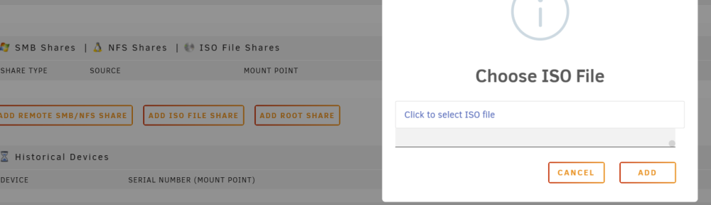

Hi, Guys:
I tried to mount an ISO file from the disk but got nowhere to go. I have the Unassigned plugin installed and I can mount the remote SMB without issue. However when I click "ADD ISO FILE SHARE", a pop up page appeared asking me to choose iso file. I clicked it but got a draw down menu with nothing, as below.
Is there anything I've missed? All disks are started already.

7 hours ago, eddie_bear said:
Hi, Guys:
ISO files have to be in an isos share.
Why is there that filter? Been annoying me several time to have to copy a file that's already somewhere else to the isos share for no apparent good reason.
Edited by Kilrah
7 hours ago, ScreN said:
Also. Maybe there is a ready-made script for user-scripts that automatically mounts the directory, makes a backup via rsync and unmounts the directory?
This is the best way to handle this situation.  Mount the remote share, backup files, then unmount the remote share.  There is no User Script that I know of that will do what you want, but it is not hard.  If you turn on the Help while on the UD page, you can see the commands needed to mount and unmount the remote share.  You can add a script to User Scripts on a cron to run at a specific time, or add the script to the Remote Share in UD that will run when it is mounted.  The script would look something like this:
/usr/local/sbin/rc.unassigned mount source
rsync
/usr/local/sbin/rc.unassigned umount source
The source is "//Tower/remote share" for a SMB remote share.
The issue you are running into is the downside of remote shares.  Your network and remote server have to be very robust and reliable to maintain the connection.  Both CIFS and NFS have these issues.  There is little recovery that I've found except to unmount and remount the remote share.
Historically ISOs are downloaded for use with a VM and are stored in the isos share.  For security reasons, UD limits the ISO selections to the isos share.  I don't think copying an ISO file is that difficult.  The Unraid file browser makes it very easy.
