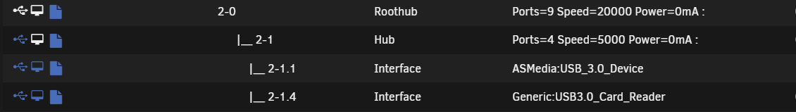

Has anyone been able to get a USB 3.2 Gen 2x2 port to work on unraid?
My MSI b560 mortar wifi motherboard has a single usb-c port and it is this 'USB 3.2 Gen 2x2' but it does nothing when used.
Instead I have to use a usbC to usbA cable plugged into a normal usb3 type A port.
Specifically it is our drone SSD which is usbC and would be much faster to backup if leveraging the usb3.2 2x2 (20Gb/s) or even 2x1 (10Gb/s)
Edited by dopeytree
Specifically it is our drone SSD which is usbC and would be much faster to backup if using a typeC port.
I have a msi Z690 which the USB C works shows as 20G even thou the hub I have connected is on 5.
Is that being passed through to a VM?
Will try some other cables see if I can get it working.
That is on the host msata to usb on the hub is passthru to my test unraid vm. Might be qemu wont support full 20g
