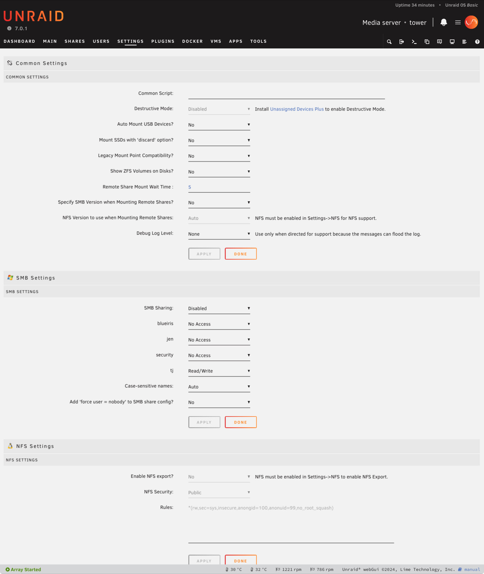

2 hours ago, fbwr75215 said:
When I try to change the SMB Sharing type from disabled to another value it does not save. I can make the change to the users access type but am not able to change from disabled. Does anyone have an idea of why this would occur.
It is working for me.  It may be something on your system.  Post diagnostics.

11 hours ago, fbwr75215 said:
I also manually edited the unassigned.deices.cfg file to changed the smb_security="private" and I am able to connect to the share. However, the UI still shows as disabled.
When you edit the file on the flash device, you need to click the double arrows icon on the UD page since the settings on the flash need to be copied to the /tmp/ file system because UD uses the /tmp/ copy to manage UD.  This is done to save reads on the flash.
I have done this and it still shows disabled. I have also done a uninstall and reinstall and the issue is still there. I checked the file in the /tmp location and it shows the value of private like the file on the Flash device.
Edited by fbwr75215
added the details about /tmp
It sounds like your flash device is having problems.  Shutdown your server and check the flash in a PC.
Maybe I was not clear. It still shows disabled in the UI. The files in /tmp and /flash match after I manually edit the file and perform the sync via the UI. The files will be updated for all other settings in the UI except for the SMB Sharing.
It's possible you found a corner case.  Give me a screen shot of that settings page.
Do you have any special characters in the user names?
Go to a command line and do this command 'ud_diagnostics'.  Then post the /flash/logs/ud_diagnostics....zip'
File attached.
ud_diagnostics-20250226-184726.zip
35 minutes ago, fbwr75215 said:
Ok, here is the situation.  There was a decision made long before I took over UD and it was a poor choice.  The SMB Sharing setting (Disabled, Private, Public, etc) setting in the config file is 'smb_security'.  The user names are 'smb_username' in 'Private' mode.  You have a user 'security', so in the config file the 'smb_security' is your user setting and not the 'smb_security' setting which confuses UD.  Until I can come up with a solution to this dilemna, your best bet is to rename the 'security' user and then reconfigure UD SMB settings.
Thank you! I don’t think I even use that user anymore so I’ll review and remove it.

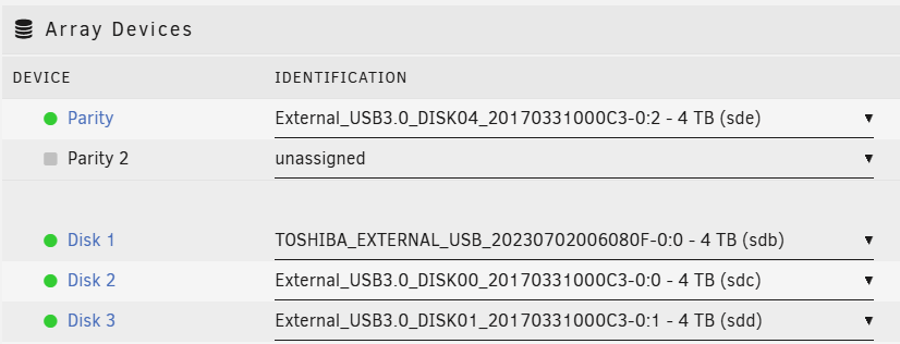

On 1/22/2016 at 2:55 AM, dlandon said:
If any of your UD disks get a gray mount button with the 'not' symbol and the 'Array' text, an array disk probably disconnected and was assigned a new sdX designation by Linux.  You'll need to stop the array and fix this situation.
How? This is driving me nuts. I've installed a new drive, I have this message showing, and I cannot work out a way to fix it. I have no ability to do anything on this drive whether it is plugged in or not plugged in (yes, destructive mode is available). I was able to pre-clear with no issues (but that is literally the only thing I can do with it).
Edited to provide a little more context:
  • I have a brand new IronWolf drive, sitting an external HDD enclosure
  • The slot in the enclosure was previously used for a drive that was in the array (it's not the same physical HDD)
  • The new drive can be seen, but I'm seeing the "not" and "array" (first screenshot)
  • I want to add the drive to the array. The array has a spare slot available, and all I'm trying to do is to assign this drive to that slot and rebuild the parity.
  • I have tried uninstalling and reinstalling all the UD apps. I have tried moving the drive around, shutting down, removing, booting up etc. in many combinations to no avail.
The only thing I have not yet tried is simply adding a new config to the array. I've never done that and I'm slightly nervous, but if this is what I need to do then I will.
zeus-diagnostics-20250303-0842.zip
Edited by Cyclical Jester
