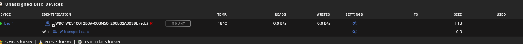

my one unraid server running 7.0.1  when you have and ssd shoved in for removable it automaticlly goes  grayed out mount...  if you do a reboot of the computer when you log back in  its still grayed out  not sure whats going on?  any logs tell ya anything
and on my main server i found my one 5TB  drive  shows up and sometimes disappears  and i dont see anything in the logs as i also rebooted and sometimes come back  it just hides itself in the historical area.. ill get diagnostics when it happens again
mitchsserver-diagnostics-20250411-2005.zip
Edited by comet424

is there a temp fix  to make a drive mountable  so i can copy files to it..  since no fix yet   is there a command line  that i can run that force it to mount  as id like to be able to copy files to a removable hot swap drive  but right now i cant  since its locked me out
im guessing it lost its partition table..  i found the disk log i guess it lost its ntfs  is reason  its grayed out i guess?

gonna format and see if it fixes itself
 I have this peoblem too
@DanielMayers for me i got it to work i had to re format the drive.. somehow unraid or UD plugin or just a freak of nature the SSD lost its partition  lucky  i didnt have anything on it..  but for me i didnt know  and i do not know if it will loose it again but thats what i found  i had to click the X to clear the disk and re format it..  but unclear how it lost the partition as it is a automount and script i have auto dismounts after copying  so  its not like pulling the drive while its running..  it gets unmounted.. so very confused  but its working again but who knows when or howlong till the next time.. but thats how i was able to get it back to working

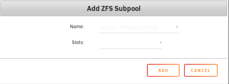

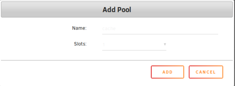

7.1.0 rc3 with unassigned devices version 2025.04.14 installed the add pool and add subpool popup screens don't display text correctly like shown in the screenshots. i have attached diagnostics as well

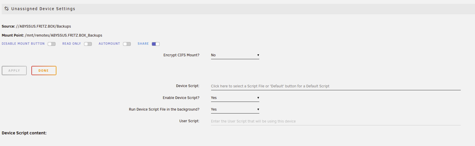

Hi Guys,
I have mounted a few SMB Shares served by my old QNAP NAS. The shares are visible in remotes, I can browse them without issue.
Now I wanted to make those mount points available to a docker container.
But I can't see the remotes "folder" in the path selection UI. What am I missing? Just used my sonarr docker for demonstation purposes. It is the same across all my containers, no matter if they are privileged or not. The remotes are not shown in my containers path selection UI.
image.png.c00e62ba667505df3659b5667d5c97
What unraid version? There was an issue with that a few versions ago that's been fixed.
Also for such mounts make sure to click the Edit button and switch the access mode to the "slave" version.
Thank you for your reply. Version is 7.0.0 2025-01-09.
I can't seem to find the slave access mode, could you point me in the right direction please?
