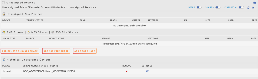

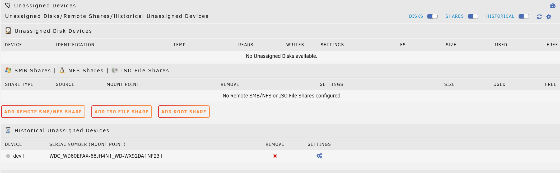

Hey guys, im not a power user but have been running Unraid for 4-5 years now. I'm having an issue after I upgraded to 7.0.1. I had a failed drive and I was using unassigned devices to keep it going until I can afford to replace the failed drive. After the upgrade the disk has moved to "Historical" as seen in the picture attached. Now im unable to start my array. It just says "cache - too many wrong or missing devices" when I try. Is there a way I can fix this until I can get a new drive in the server? Any help is appreciated thank you. EDIT: I've tried to search the forums and didn't find a solutions.  If there's been a similar issue please link!
This has nothing to do with Unassigned Devices plugin. Plus you already have a thread going about your problems so let's keep it there.
Ok sorry I didn't realize the support people were the same in both places.  Cheers
