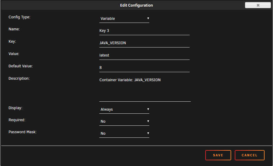

9 hours ago, CmdrKeen said:
also...the JAVA_VERSION variable in the docker config doesn't recognize java version 17 as the default...when i had 16 in there the log said it didn't recognize it and instead set it to "latest". when i emptied the variable, it defaults to java 8
this is expected, basically the options are java v8 (defined by JAVA_VERSION=8, java v11 (JAVA_VERSION=11) and latest java (JAVA_VERSION=latest), the reason for latest as opposed to a numeric is that the os i am using is rolling and thus updates to java can and will happen, if i define the exact version then as time progresses the version will no doubt change meaning i need to then update the template and tell everybody to update the defined version again (template changes are not pushed to end users).

I might recommend setting the JAVA_VERSION variable in the unraid docker config to "latest" (no quotes). this will set it to default your servers to java 17 (for now, though if it gets updated past this it should follow suit). If you don't have this variable in the docker config page, you should be able to add it manually:
If you need a server to use version 8 or 11, then set it manually in the server.config file for that server.
