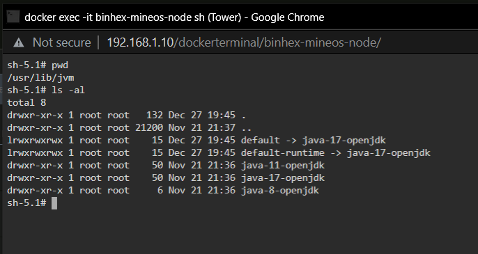

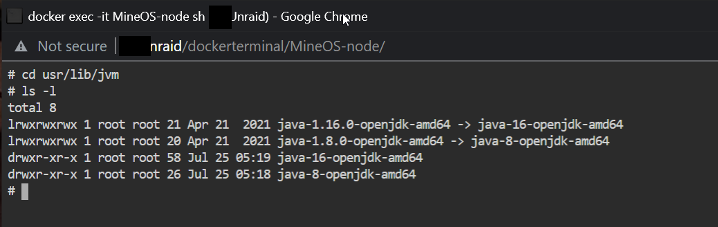

58 minutes ago, dyker said:
Maybe I'm not understanding things quite right, but I don't see Java 17  and I'm on the latest version according to unraid.  I'm trying to create and run a 1.18 world (see prior post)
you are not running the latest image, just verified from tagged 'latest':-
do a 'check for updates' then apply any updates.

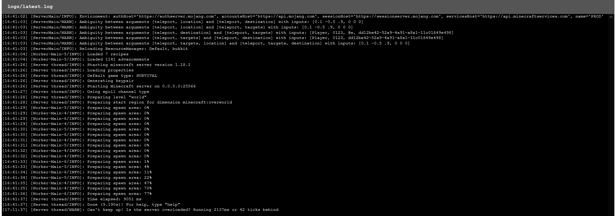

Hi!
I've been having some strange issues with the Binhex Container sometimes loading all of my 12 threads to 95% or 100% and keeping it there as long as anyone is on the server I'm hosting. A reboot of the container appears to fix the issue but it takes the container a solid 5min to even let me get to the web UI and another 2-3 min to show me my list of servers (1 server). I've already moved my dynmap storage folder to not interfere with the scanning that has been mentioned here before.
The server is running :
MC_Spigot 1.18.1
16GB RAM (48Gb total )
on a Ryzen 5 3600 6c/12t
Last time this occured I had to stop the container from Unraid as the WebUI wasn't responding at all anymore and basically froze my entire server. After that I checked the logs a bit more carfully and I'm getting a ton of  lines saying "[Spigot Watchdog Thread/ERROR]:" listing basically every function on the server (minecraft.server.level.ChunkProvider, Dynmap, etc.). I assume that this is the due to the container shutting down through Unraid but I though I'd still mention it.
There are also a bunch of "Can't keep up!" (~100ticks behind) messages now and then but usually only after somebody TPs around on the server (creative server so this happens quite often).
First post here so please let me know if I missed something and huge thank you for supporting this awesome docker container!
Edited by frokes
On 1/27/2022 at 5:56 AM, frokes said:
Hi!
MC_Spigot 1.18.1
I can't help with the issue of the docker taking a long time to start the webui and then a long time to load the server list, but i had a lot of server performance issues with spigot in the past and they mostly went away when i switched to paper. might be good to look into it.

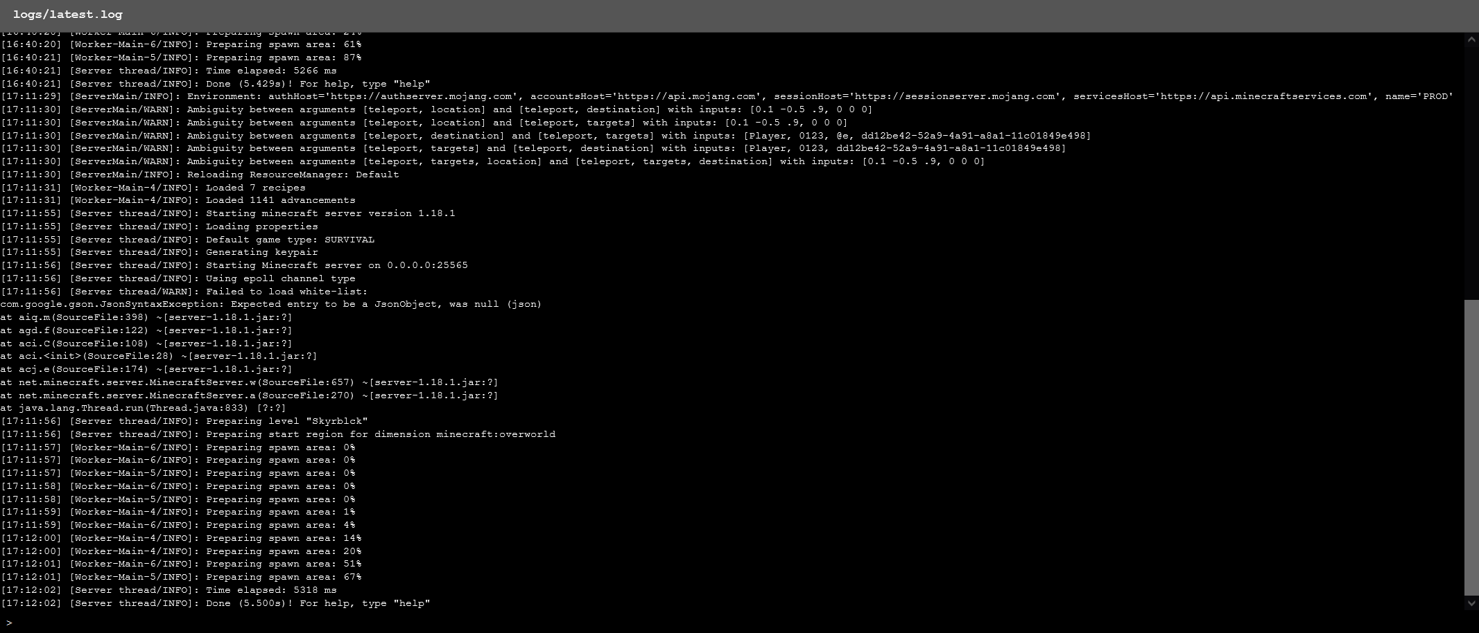

Hello there,
I've been trying to get two mc servers running on my unraid server for a few days. As it didn't work with multiple Dockers (MinecraftBasicServer & BinHex Minecraftserver) I tried MineOs.
Both servers work independently (port 25565 & 25566).
My problem is that when one server is running and I start the second server, server A gets shut down.
Log of the server getting shut down:
Log of the starting server:grafik.thumb.png.905df418838809391004f0598be7d122.png
sys specs:
i3 8350k
msi b360m
8 GB DDR4 (another 8GB are coming soon)
Any help is apprechiated
Thanks for your work ;)
assuming both containers have separate HOST ports defined i would suspect your system cannot cope with running two minecraft servers at the same time probably due to underpowered CPU, thus the overloaded message shown in the first screenshot.
Upgrading to 16GB of RAM seems to have fixed it. I guess there was not enough RAM so one server had to be killed.

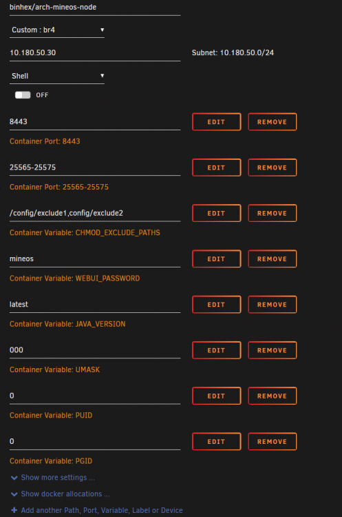

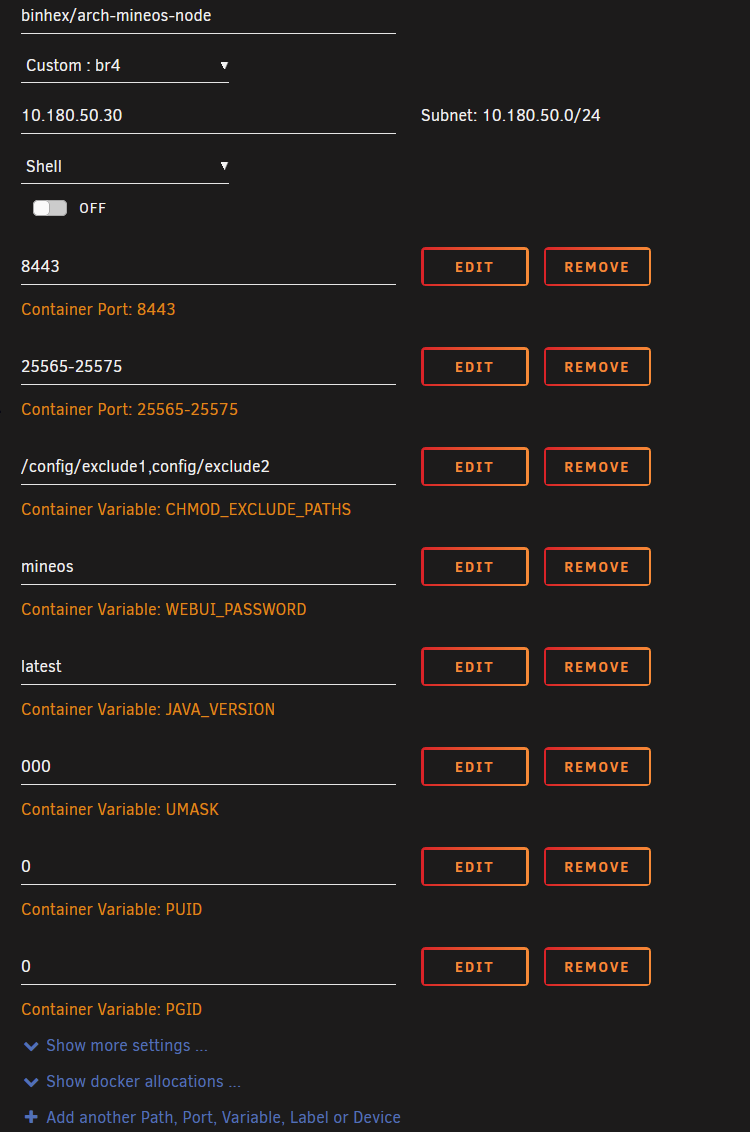

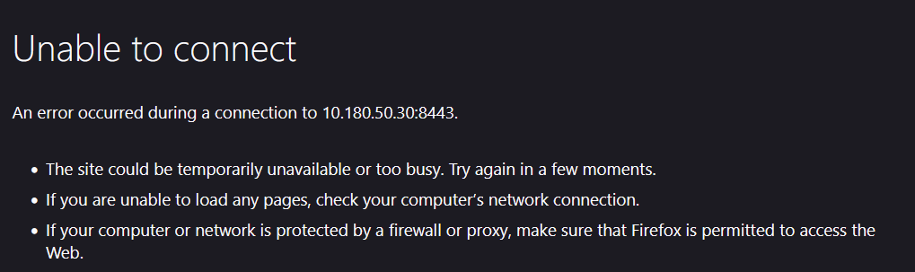

New to this container but having some issues with it hoping there's a solution.
After login of root:mineos I get this in firefox / chrome
Looked in the supervisor.log in  /mnt/cache/appdata/binhex-mineos and didn't see any errors.
unraid: 6.9.2
BR4 is a VLAN and the IP is unique only to this container.  Traffic my my client to this vlan is completely open (firewall wise)
this is the issue, you need to login as user nobody
Easy fixes are the best. Thanks for prompt response. Good now.

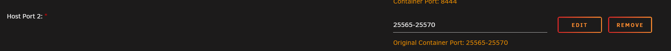

On 3/22/2022 at 12:10 AM, Vinster411 said:
I have a question about the container port range. To mix things up I usually change standard port designations. and because of this I tried changing the range from 25565-25575 to 56555-56565. But when I start the Docker it uses the default ports.
is there a way to change the port designation?
Vin
@Vinster411,
Go to the Docker Container and edit it. Change the "Host port 2" setting.  Make this the new range for your servers. Apply, and restart your docker.
Then when you login to MineOS, go make sure the Minecraft server you want to change is stopped.  Go to the server properties page of that server and change the "server port" of the server to a port in the range you designated.  When you start the server back up and check the log output and see if the new port took affect and then you can test.   Also make sure if you are hosting outside local you setup port forwarding on your router for the new Minecraft server ports you designated.
I hope that helps.
Edited by ArKineX
