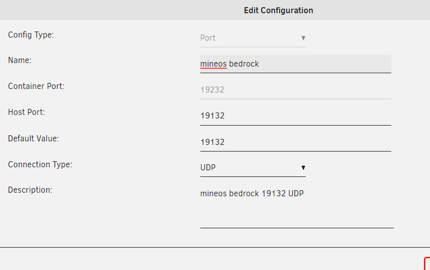

Trying to get GeyserMC plugin going. I'm close... I get the "unable to connect to world." I have gotten this working on other servers, ones I pay for (Shockbyte hosting). But I'm trying to make this one work inside unRaid Docker.
1. added Port for the Docker config, 19132 UDP (see attached)
2. forwarded 19132 UDP on router to unRaid box
added Geyser-spigot.jar to plug-ins folder. Restarted server.

I was able to test if the port was open using
https://check-host.net/check-udp?host=minecraft.mydomain.com:19132
The UDP port is coming back Closed, or not listening. I'm sure this has something to do with it.
Edited by dkerlee
Spoiler

Geyser and Floodgate plugins require forwarding 19132 both UDP and TCP since Bedrock uses both (at least it seemed to for me...no mention of it on the FAQ page for GeyserMC).

7 hours ago, CmdrKeen said:
  Reveal hidden contents
Also, if you use dynamic dns service like duckdns for your address, sometimes these don't work. I had mine initially reject connection but after a few minutes it started working.
And to get both udp and tcp you added two port entries in the docket config? Ah, and set port forwarding on router to both.
it was my understanding that Java uses 25565 tcp, and bedrock uses 19132 udp.  Geyser sits between them - and yet, it ain’t working! So I’m certainly doing something wrong. I’ll try two docker entries for both 19132 tcp and 19132 udp. Thanks!
