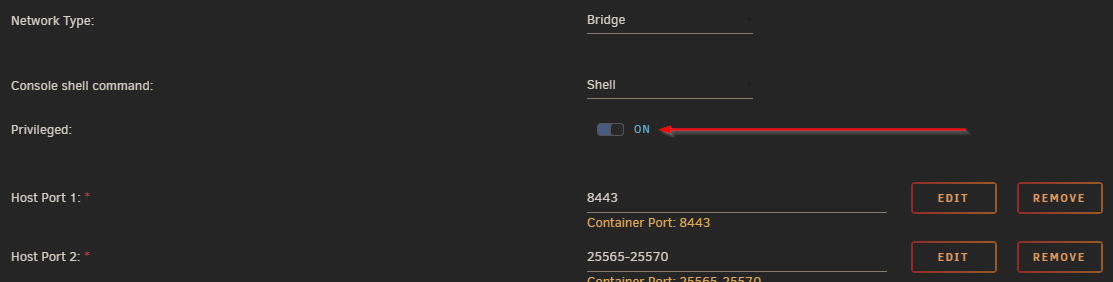

*UPDATE: Applying Docker in "Privileged" mode seems to work.

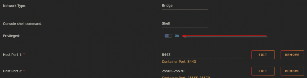

How do you apply Docker in privileged mode?
Click Edit on the docker, and it's right above the variables and after the "console shell command"
I changed this, and both my servers (1 FTB, one Vanilla) started perfectly. :)

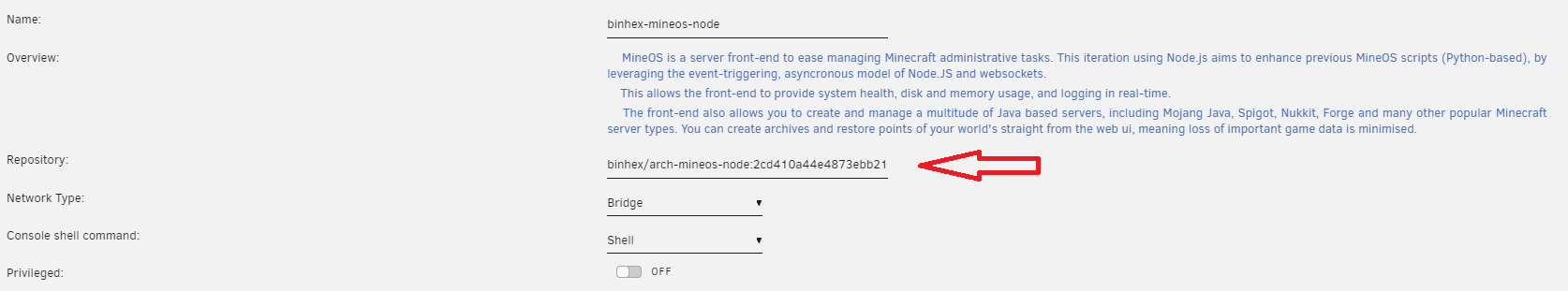

Just change the marked line too binhex/arch-mineos-node:2cd410a44e4873ebb215048d51509be07bacd89a-01
and you go back too a working image tested on Unraid 6.9.1 and no need for privliged.
Thanx for the shortcut to docker use the image you want via the method you show here!

I did have luck getting everything to run by switching the Docker to "privileged", but do not feel safe leaving that enabled.

I'm running the image: binhex/arch-mineos-node:2cd410a44e4873ebb215048d51509be07bacd89a-01

They both WORK on this image. But they ONLY work if the container is in "Privileged" mode. Otherwise I get the same issue as others above about "Operation not permitted".
