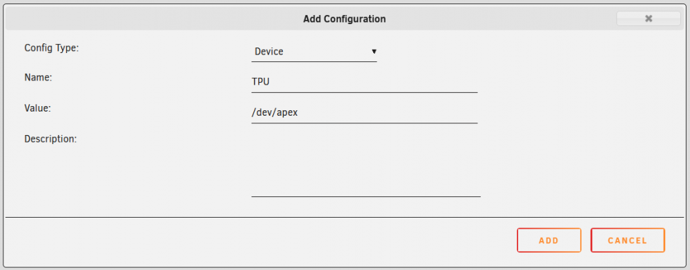

7 hours ago, aceofskies05 said:
My current working theory is that I some how need to forward the PCI/Apex drivers? to the container but I dont see a way to do this... Im thinking since I forwarded to the VM, then installed the TPU drivers via google/linux packages it magically worked to pass through to the docker container in the VM.

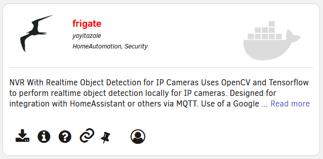

Actually that is pretty simple btw, I hope you are using this one:
also here is the support thread for the container itself: Click
(since I actually don't own a TPU device and I'm only the guy who create plugins with drivers for unRAID so that they are working on/with unRAID)

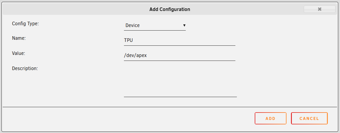

You only have to click on: grafik.png.b30d5618a00c828f18c8abbfb29852e1.png on the bottom and then create a entry for a device like this:
(Please make sure that you change the config type to "Device" and enter the device path like: "/dev/apex", click on "Add" and "Apply" and you now should be able to see the device in the container)
A short summary:
  1. Turn off autostart from the VM where you use the TPU
  2. Unbind the devices from VFIO and reboot your server
  3. Create a Device like mentioned above in the Docker template
  4. I would recommend to delete the "wrong" mapping for your usecase. Delete: "/dev/bus/usb" and "/dev/dri/renderD128" from the template by simply clicking remove
  5. Enjoy
If it isn't working after this please try to create a post in the appropriate support thread for Frigate because there are people that can really help, at least more than me, and that actually have such a device.
From what I know the Dual TPU should work just fine on unRAID. :)
That worked! Thank you so much. The trick was adding a device to forward and using apex. Woot!
