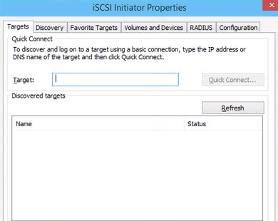

Hello,
I installed the ISCSI target plugin in the latest release of UR and i have a server with 2 nic including 1 at 10Gb.
I created a Lun and would like to isolate it on the 10Gb nic and keep the other nic for the network.
Would it take a network binding option or is it possible to do something else?
Many Thanks
If you want to do that the easiest way would be to assign a static IP address to the 10Gbit/s NIC and on the Initiator (Client) enter the assigned Static IP address this should route all traffic over the 10Gbit/s NIC.
By default the iSCSI Target (Server) listens on all interfaces and if a Initiator want's to connect over a specific IP address it chooses that NIC which is assigned to this address.
For example if you enter on the Initiator the IP address from your slower NIC it will use that for the iSCSI connection.
Here is a example where to enter the IP address of the Target on Windows:
Hope that makes sense to you. ;)
