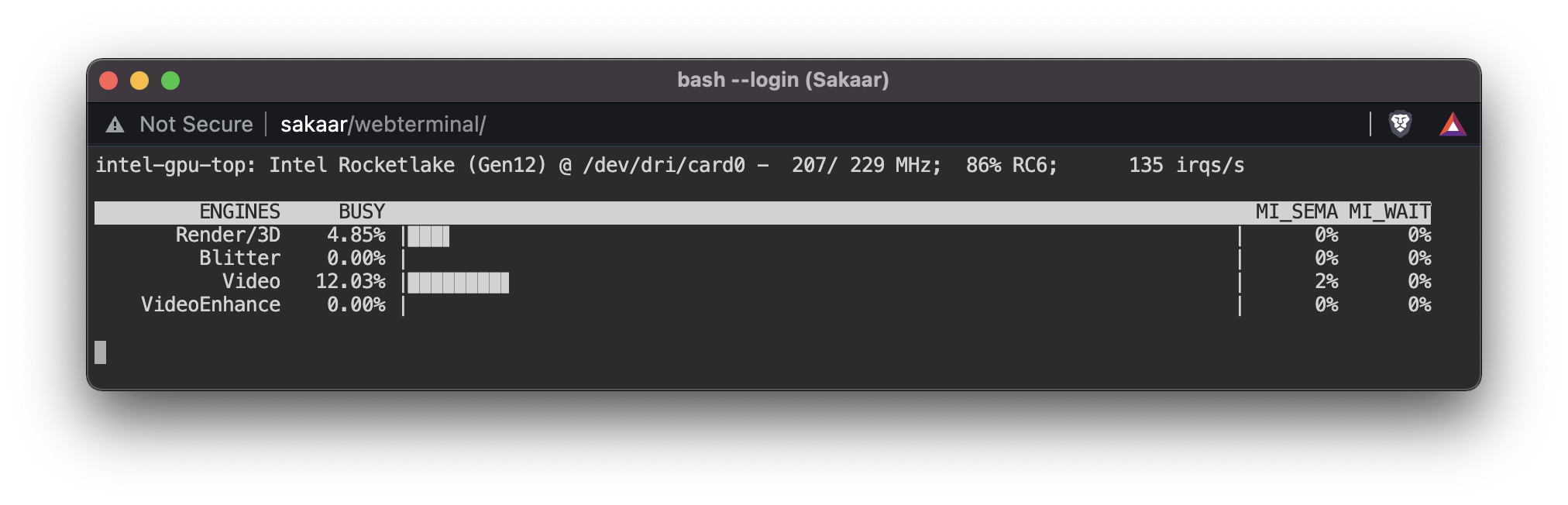

Using the latest intel_gpu_top plugin `2021.07.16` my Intel 11700K shows as `Intel Rocketlake (Gen12)`, but it's a Gen11 ? Is this right?35568912_bash--login(Sakaar)(BraveBrowser)2021-11-13at23_53_49.thumb.png.bb245c6855214e4d0c1b659330d7d46f.png
1 hour ago, Craig Dennis said:
Is this right?
This is completely correct Intel 11th Gen Core processors usually have 12th Gen Intel Graphics (I think it's UHD 750) built in.
Intel GPU TOP shows the generation from the iGPU and not from the CPU. ;)
Hope that makes sense to you.
Ha, ok. Your explanation makes sense at least! :D

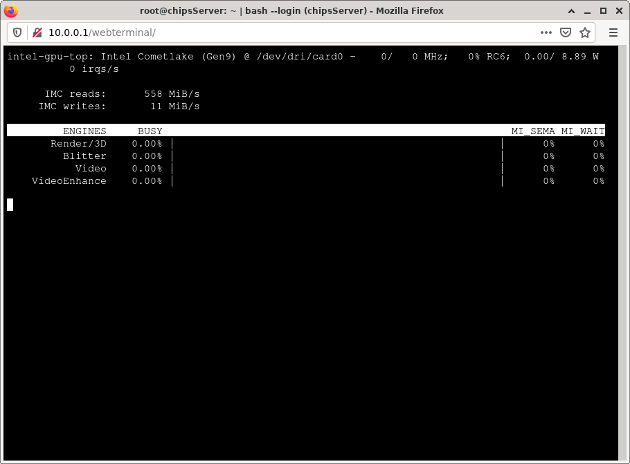

This is pretty normal when nothing is using your iGPU like on my system now ;) :
