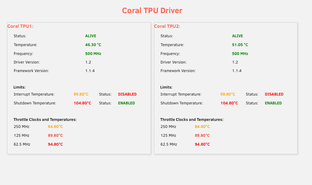

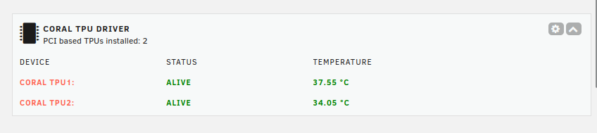

EDIT: I did a quick test with my Dual Edge Coral TPU, I can see both Coral TPUs on the plugin page:

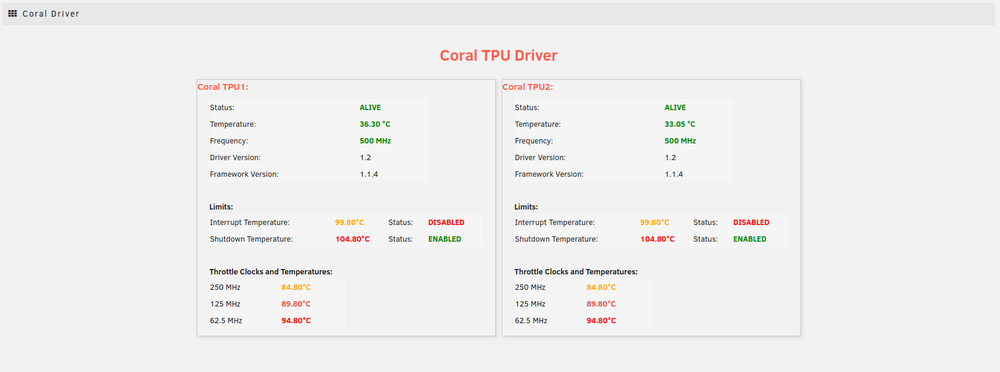

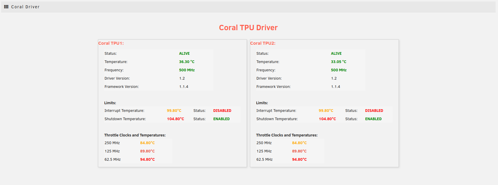

and also on the Dashboard:

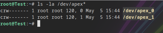

and also listed under the devices:

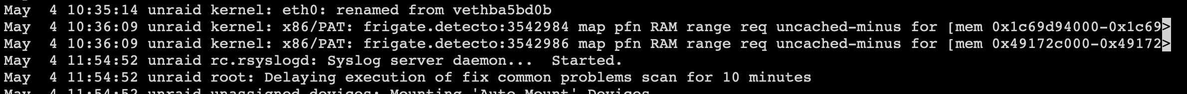

The only somewhat interesting thing in the syslog is the write back errors:

I have the syslog history through crashes. But it restarts instantly after crashing.
In this example of a crash at 11:53am, this is what the syslog looked like around the crash time.

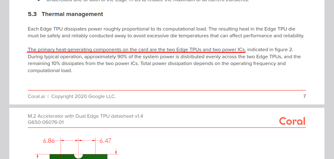

Oh see, it's still in there but they worded it differently:
Source: https://coral.ai/static/files/Coral-M2-Dual-EdgeTPU-datasheet.pdf

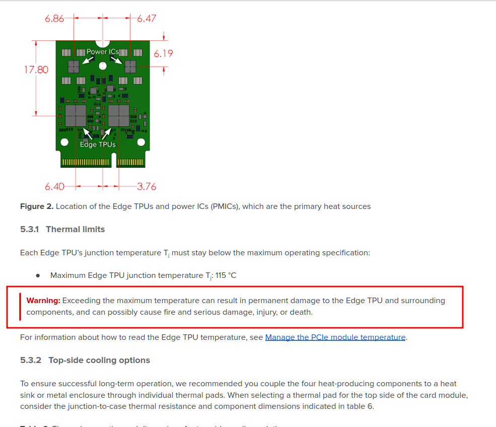

And there is the note about the power ICs:
...just to let you know that it would be good to mount something since nothing is monitoring the Power ICs @Daniel15.
Good catch! I've never seen mine above 55C (especially since it's used infrequently for ~100ms at a time, rather than it having constant load) but I'll definitely keep it in mind. I'm surprised they don't factory-install a heatsink, but I guess for $25 for the single TPU / $40 for the dual TPU we can't expect everything :)
Please look at the docs:
I would always recommend to have some kind of cooling in place because even the single chip Coral TPUs have some kind of heat sink on them (metal cage on top <- you don't see them in most screenshots).
Just saying, the documentation is here.
