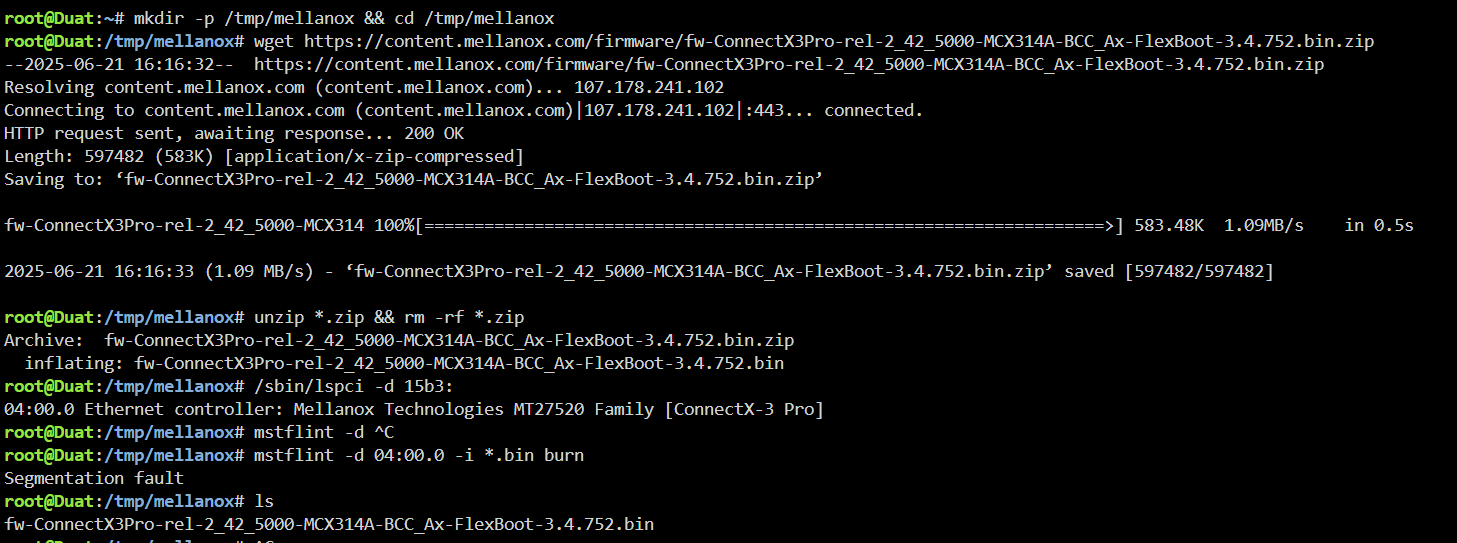

Not finding anything regarding a seg fault. Anyone have any ideas? Any help would be appreciated!

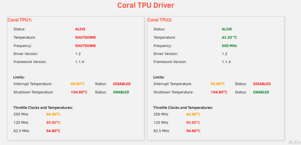

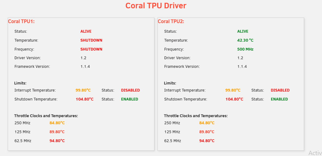

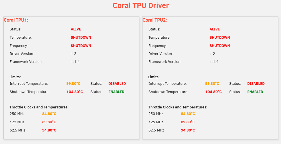

Tried installing a Coral M.2 with the Dual Edge TPU PCIe x1 Adapter, and have been finding that it crashes my entire system in under a minute or so after installing the Coral plugin.
Looking at the plugin page shows that it's overheating pretty fiercely, despite nothing being configured to utilise it.
Immediately after the machine is shutdown, the Coral TPU feels barely warm. Does this look like it could be a faulty Coral unit?
Plugin page after installing plugin:
Plugin page after around 30 seconds and immediately before system crashes:
Do you have a heatsink on your Dual Edge TPU? It is recommended to use a heatsink otherwiese it is most likely that it will overheat.
Please also do keep in mind that the failure rate from the PCI modules is pretty high from my experience, maybe you got a faulty module, just saying.
On my Dual Edge TPU everything just works fine and with a heatsink attached it is about 36C while in idle and can reach up to 72C in my case depending on the workload.

Thanks for the quick reply.
I do not have a heatsink (yet). I didn't think that even while idle it would overheat, but seems like I should take a look into it.
I have seen that a few of the PCI modules have had replacement issues, so I may reach out to the maker to see what they think
Back in the days the documentation for the Dual Edge TPU even mentioned that this card is a Fire Hazard without a heatsink and the the main heat source is the power delivery.
Pobably also try to get a heatsink too if your distributor has some.
