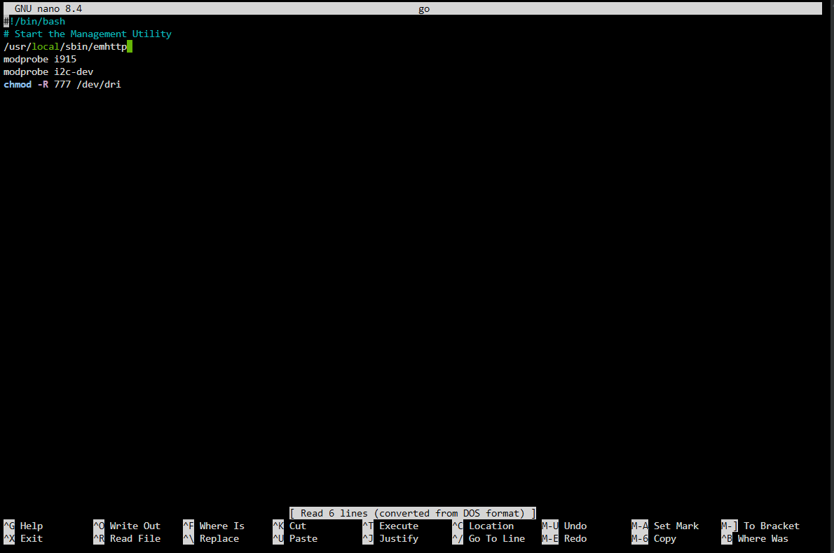

I have the exact guide for anyone facing this issue with missing i2c devices on UNRAID 7.1.2.
  1. Run sensors-detect. Press y to probe i2c and then y to probe i2c-0. All of my sensors were detected here. Then press y or n to the remainder of the i2c-x devices, I didn't have any on these only i2c-0. Then y at the end to write.
  1. "cd /boot/config"
  2. "sudo nano go" (edit the boot go file)
  3. Add line "modprobe i2c-dev"
  4. Press ctrl+x, then y to write
  5. Reboot UNRAID to load command, i2c devices should now appear in openrgb after every reboot
