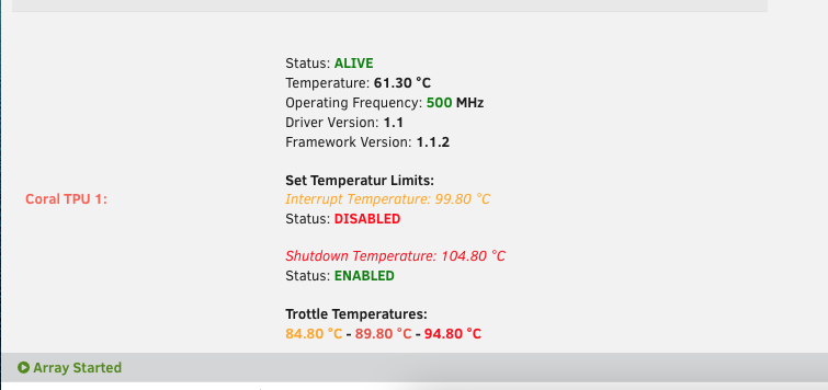

Please keep in mind you have to come up with a way to cool the TPU(s) since they are really hot in your case if they are currently idling.

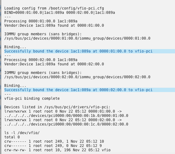

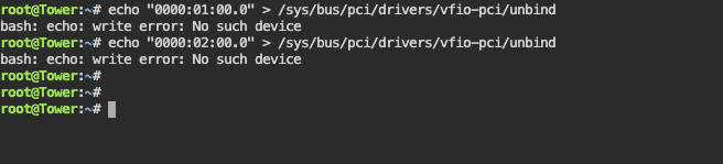

I see the 2 post labeled as answered to this question, but i cannot find a solution to my problem so im asking anyways. My coral pci device is detected by my unraid server, but the drivers will not load as seen by
ls /dev/apex_0
and of course my coral device does not show up in the settings -> coral driver tab in unraid.
Inside the system devices tab on unraid i get this, when hovering over the "System peripheral: Global Unichip Corp. Coral Edge TPU"
kernel driver in use: vfio-pci
kernel modules:apex

But everyone that buys a Dual Edge TPU don't forget to set up proper cooling, otherwise the Dual Edge TPU can be a fire hazard, even memtioned in the documentation.
Because you've bound it to VFIO, unbind it and reboot the server (Tools -> System Devices).
Have you installed the Coral Driver plugin?

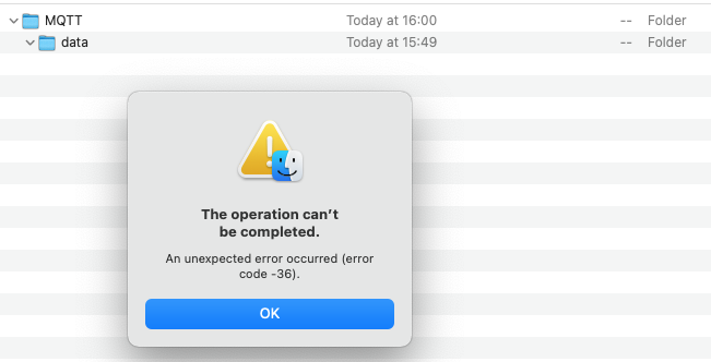

  I have had to install Frigate/ Mgtt plugin again  as they both stopped working. Now  I am unable to get Spants Mgtt to  statr and  Frigate   seems  not to be configure correctly. when I try to  insert my config thru smb  I am unable to insert  it due to the diretory for Frigate is not there. Instead MQTT is there . If i try thru the terminal I have the same error Input/Output as MQTT.
Any advise  would be appreciated.

Do you have the array started an working on unraid? It looks like you have some failure on disk2. Did you change the bind point to the array share or you are writting still directly to the disk?
yayitazale
  Thanks you  are correct i have a faulty disk in my array so i have removed it and had to set up my unraid.  Now the  coral drivers are not loaded. there seem  to be a problem  as i cannot click on the logo to see if they are running just.
 I understand that my TPU are binded to Vfio-pci . I have tried to unbind them without success, any points  how to unbind them. I have laso rebooted but nothing is happening.
 I await your comments thanks
The answer is there
