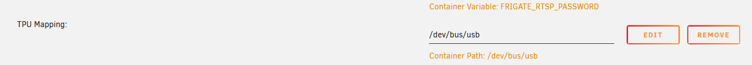

I have 2 Coral TPU USB installed in UNRAID. Do I need to install the Coral Drivers in UNRAID or that is just for PCI/M.2 TPUs?
Also, how do I passthrough the USB TPUs to the Frigate Docker in UNRAID?
Thanks for your help!
For USB TPUS there is no need to install the drivers. The USB TPU is passed already on the template:

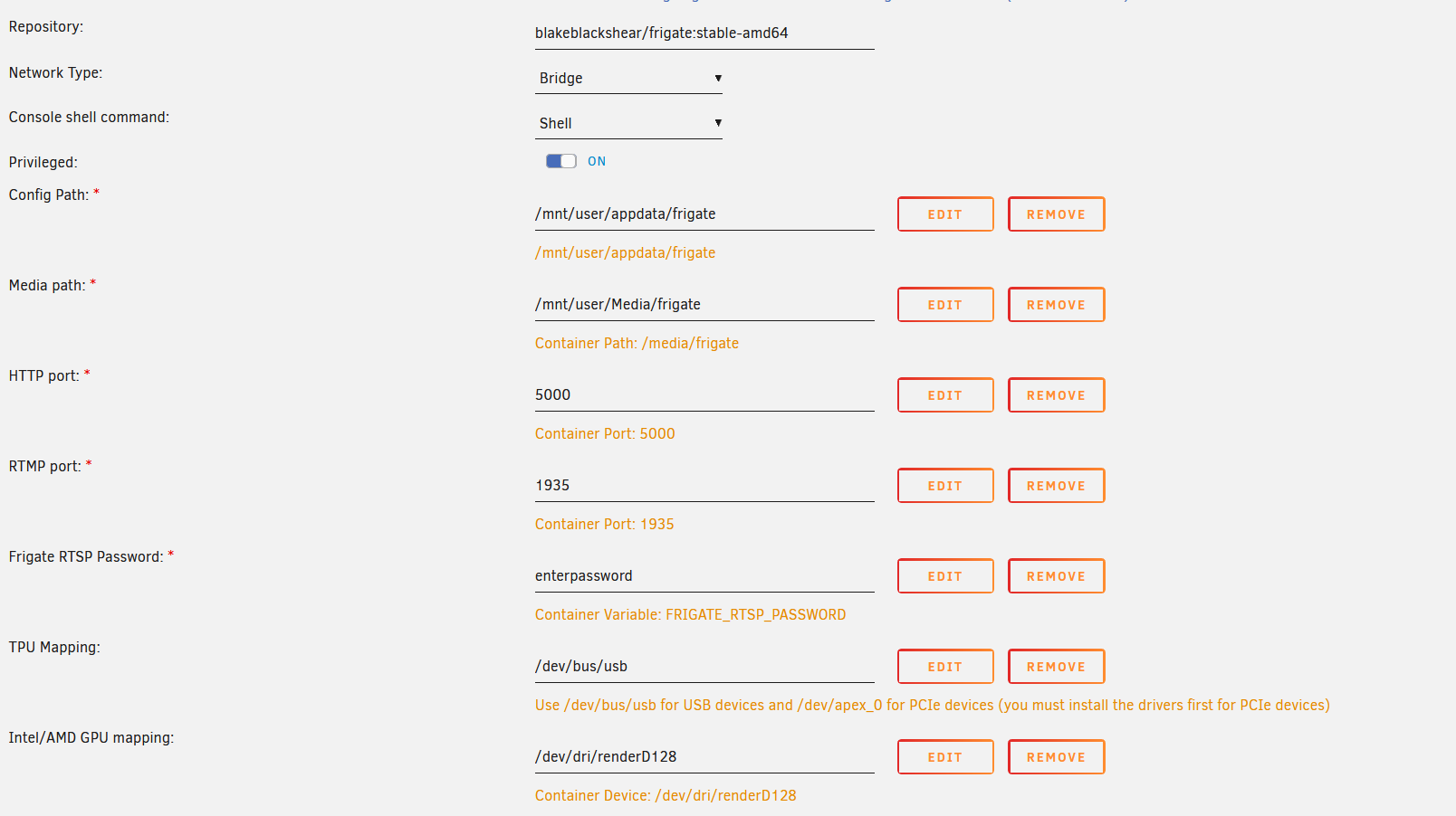

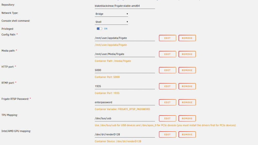

On 1/6/2022 at 5:18 AM, m0ngr31 said:
I'm having a weird issue with this docker where if the docker is started, I can't start up my Windows VM. I'm not sure what the issue is.
I'm using the nvidia docker passing in my Quadro and my Coral USB device. My Windows VM is using a GTX 1070 with its own PCIe USB card passed in. Home Assistant is being ran on an actual RPi 4. What could be causing this issue?
Can you show how are you doing the passthrough of the graphic cards to the container and to the VM?
There are these 2 lines in the template
<Config Mask="false" Required="true" Display="always" Type="Path" Description="Container Path: /media/frigate" Mode="rw" Default="/mnt/user/Media/frigate" Target="/media/frigate/" Name="Clips path">/mnt/user/Frigate/</Config>
<Config Mask="false" Required="true" Display="always" Type="Path" Description="Container Path: /media/frigate" Mode="rw" Default="/mnt/user/Media/frigate" Target="/media/frigate" Name="Media path">/mnt/user/Media/frigate</Config>
Both are required (forced) and both map to the same container path so it makes absolutely no sense to have it twice. Every time I update the container this screws up my container settings. Every time I have to delete the second one that gets re-added and I also have to delete the media user share that gets created by the mapping because the container re-started after the update.
The name and default system paths also don't match in the first one where I underlined them.  I don't use a media share so that isn't right for my system. Lots of people don't. I would suggest using the typical /mnt/user/Frigate type path like all the other templates I've used are doing.
I would remove the fist one and also remove the Media from the path in the second one.
Also, the paths to the GPU and CPU mapping should not be required(forced). I was testing it without a TPU and no GPU acceleration so I deleted those device mappings but updating the container messed that up for me too by adding them back in so I had to delete them again.
Edited by lionelhutz
I think you are messing up updating over a older template. Delete the container and recreate it with the new template from the app store:
Media folder is OK where it is, you can change it if you are not using it, but I don't like the idea of forcing everybody to have a new share just for this. Media must live on media.
The cpu/pgpu devices are not forced.
Hmm, my install must have keep an earlier messed up template once I installed it....
I haven't had any other containers act like this one, I guess the original assignments in them must have been fine with how I wanted to use them.
When did Media become a default user share that is created by a new unRAID install?

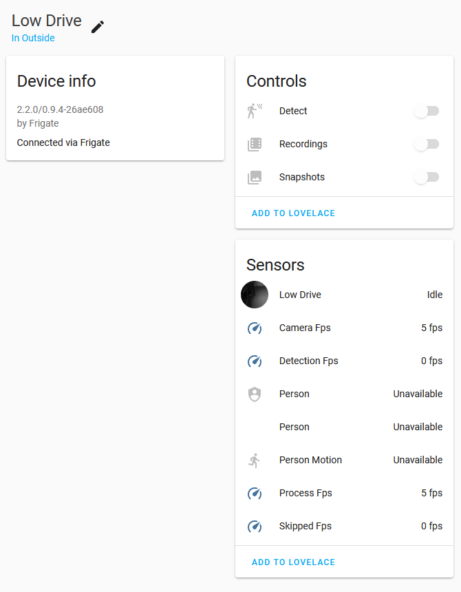

For some reason my config has stopped working properly.
In the Web GUI provided by the docker I can no longer toggle detect, snapshot or recordings on or off - clicking the icons simply hightlights the buttons and that's it.
Also, in Home Assistant multiple entities now report as Unavailable or greyed out:
I have tried deleting all my recordings and the appdata, deleting the container and re-downloading and starting from fresh but the problem strangely remains.
Any ideas ?
The frigate logs seem OK, from a fresh start:
Any ideas ?

This is not related to the frigate docker, is something with your hass addon. Please refer to that github issue page.
OK thanks, I thought because the toggles on the Web GUI no longer worked it may be an issue with the docker...
I have also tried deleting everything on HA, ie removing the integration from HA AND HACS, re-downloading etc and the issue remains.
Should I open a new Issue against the HASS integration on github https://github.com/blakeblackshear/frigate-hass-integration ?
Edited by fireplex
If you refer to this icons then maybe yes but the image you attached is from HA.
Anyway, if this is the case, I found this: https://github.com/blakeblackshear/frigate/issues/2098
Comment out the port on your config file.
Edited by yayitazale
Yes those icons, I forgot to also post a picture of them.
Sorry, which port number?
My config file:

Try to define the port number on the MQTT host like so:
mqtt:
  host: IP address
  port: port
And see if it makes any difference. If the error persists please open a issue o reopen a issue on github.

Did you fill out the "NVIDIA_VISIBLE_DEVICES" argument on the docker template?
Then, the ffmpeg validation error is because you are mixing arguments on one line with the new ones with line breaks. You should only have one type of separation between args. so it must be something like:
ffmpeg:
  # Optional: global input args (default: shown below)
  input_args: -avoid_negative_ts make_zero -fflags +genpts+discardcorrupt -rtsp_transport tcp -stimeout 5000000 -use_wallclock_as_timestamps 1 -c:v hevc_cuvid
Or:
ffmpeg:
  input_args:
	- -avoid_negative_ts
	- make_zero
	- -fflags +genpts+discardcorrupt
	- -rtsp_transport tcp
	- -stimeout 5000000
	- -use_wallclock_as_timestamps 1
	- -c:v
	- h264_cuvid
Change that and I think it will work.

I'm not using a Coral TPU for now (only Nvidia card). What should I set for TPU Mapping in the container?
