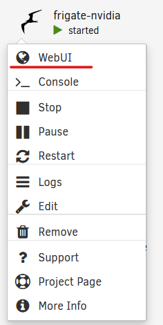

  • Hi @mathgoy, I've been using Frigate with an NVIDIA GPU.   to set it up, go the the docker template and add: --rm --runtime=nvidia to the "Extra Parameters".   Y
