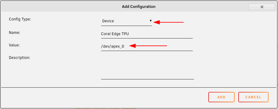

Same thing happened to me, I solved it by changing the docker UI from "/dev/bus/usb" to "/dev/bus/usb/003/003" in your case.  Hope this helps, mine finds it and records - just lost all UI around the same time...

For USB coral you don't need the Driver pluging, that only works for PCI and M.2 coral cards. It looks you have changed the config file of your frigate. Make sure you have these:
detectors:
  coral:
    type: edgetpu
    device: usb
And not these:
detectors:
  coral:
    type: edgetpu
    device: pci
The USB tpu mapping is /dev/bus/usb. /dev/dri/ is mapped for hardware acc. of intel CPUs.
Be aware that pointing to an specific usb port will not work if you reboot your Unraid machine as port may change to another number. Thast why the mapping is done to the entire USB driver to let frigate find it whatever the port number is.

Glad it worked, and as @yayitazale said, it will change at boot.  When mine rebooted, I went back to the default /dev/bus/usb with no issue since.
