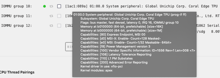

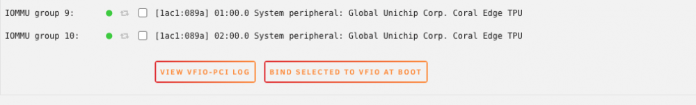

  Yes I saw this post and unchecked the TPU in Dveice and rebooted . I also  tried to unbind by echo "0000:01:00.0" > /sys/user/pci/drivers/vfio-pci/unbind. however, its not unbinding.
 I have tried this numerous times
 correction The script is incorrect i used  /sys/bus/pci/drivers/vfio-pci/unbind

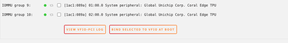

Can you please share your Diagnostics, your Coral TPU is bound to VFIO and unRAID can't see it really.
1 minute ago, mikey6283 said:
You have installed the VFIO plugin please remove it from there, also I would strongly suggest that you remove the VFIO plugin entierely and use the Tools -> System Devices to bind devices to VFIO.
BIND=0000:01:00.0|1ac1:089a 0000:02:00.0|1ac1:089a
This is from your /boot/config/vfio-pci.cfg
 Thank  that fixed it , I only downloaded vfio-pci.cfg to see if there was a way to delete the original . Obviously i made it worst.

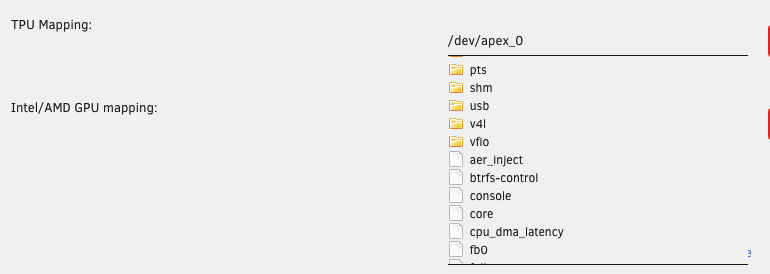

 Thanks i now see the TPU running  now to sort out my config and FFMPEG
 For inforamtion only i binded the TPU  in TOOL-> System Devices  originally as i am struggling with Docker Frigate  as it is  Frigate is running in HASSIO but on CPU. so i was trying to,load the TPU's in a VM

Hi, my Frigate stopped working, it cannot find the TPU. Everything was working fine, removed my GPU some days ago so i had to restart the server. Since then frigate was not starting.
TPU is unchecked at Tools > System Devices, but if i hover over the green dot it says that "vfio-pci" driver is in use.
Tried to unbind, checked and unchecked the tpu, rebooted and reinstalled the driver, but had no effect.
frigate.edgetpu ERROR : No EdgeTPU was detected. If you do not have a Coral device yet, you must configure CPU detectors.
Unraid 6.9.2
Frigate 0.9.4
Coral Driver 2021.10.01
M.2 Single TPU
Any Ideas on this?
Thanks in advance

TPU was mapped with apex_0, this one is no longer here.
Docker:
System Devices:
Coral cant find the TPU:

1 minute ago, ich777 said:
Is the TPU detected by the plugin?
Please also post a picture from the Coral Driver plugin in addition to your template configuration.
No its not, thats the reason why i tried to reinstall etc. Sorry, forgot this in the initial post
You've also mapped the TPU wrong, you have it mapped as Path but instead you have to mount it as Device.
25 minutes ago, ich777 said:
Please reboot your server (with the Coral Driver plugin installed) and after it rebooted pull the Diagnostics and post them here.
Found the mapping path in a blog article for the setup, will set it correct then afterwards.
