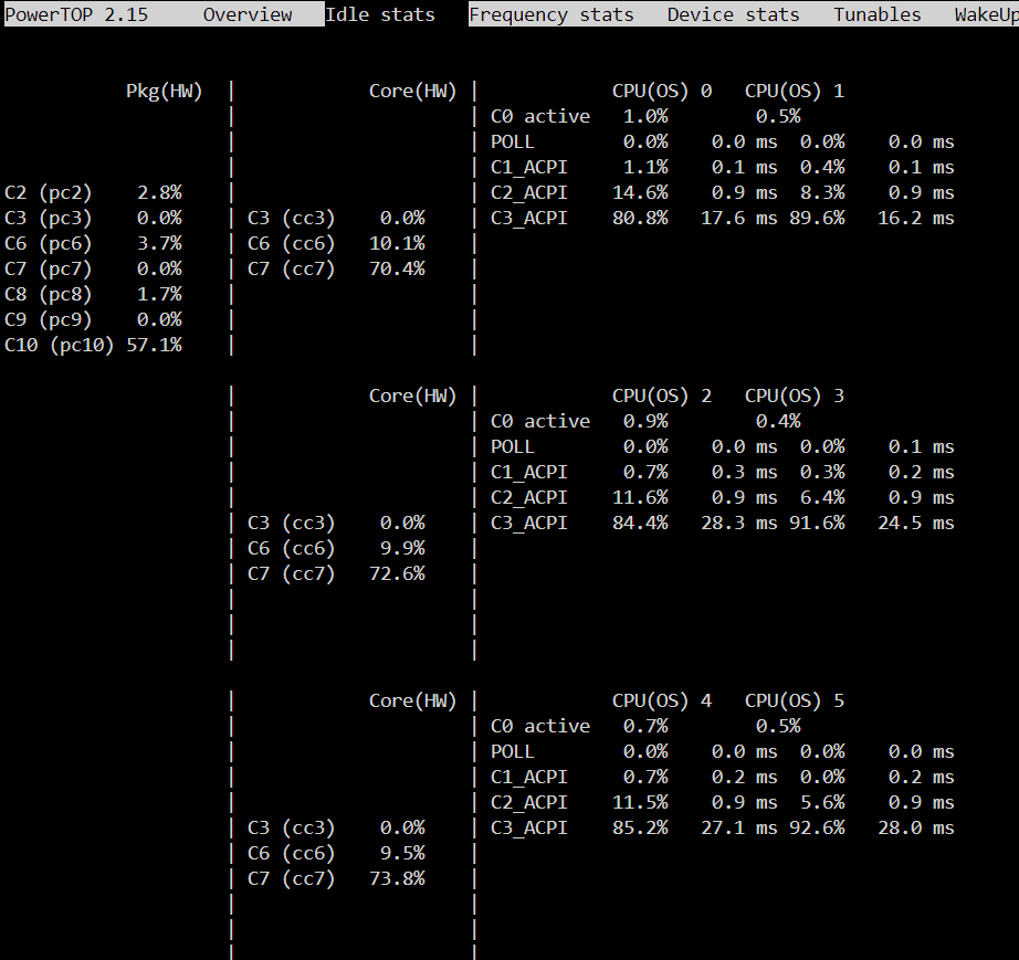

    Good news everyone! I managed to get C10 pkg C-State (previously I get no higher than C3) on Asrock LGA1700 mobo and you can too. Yay!   My setup is:   Motherboard: Asroc
  • I added a warning:   And a further explanation to the initial post:

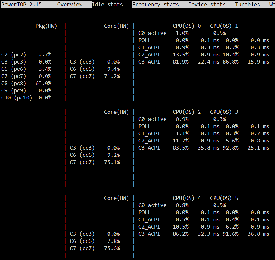

Hi guys,
hope someone might have an answer for my system behavior.
My setup:
- Intel i3-13100
- ASUSTeK COMPUTER INC. Pro B760M-C
- Samsung 970 Evo Plus
- 2x WD HDD
- Corsair RM550x
- Only onboard controllers for SATA, Ethernet, ...
- Unraid 6.12.6
- Powertop 2.15
I am able to achieve approx. 15-17 W in Idle with HDD spinned down.
With spinned up HDD consumption is around 20-22 W.
(No dockers or VMs active)
Do you feel there is space for further improvements?
What is strange to me in powertop:
  • With spinned up HDDs C-states are reaching up to C10
  • With spinned down HDD, only C8 is possible
Do you have any idea what could be the reason for this?
Any further info needed to identify the root cause?
Looking forward to your advices and ideas :-)

Thanks for the quick reply.
ASPM is enabled on all devices as far as I can see:
  • ~# lspci -vvPPDq | awk '/ASPM/{print $0}' RS= | grep --color -P '(^[a-z0-9:./]+|:\sASPM (\w+)? ?((En|Dis)abled)?)';
  • 0000:00:1a.0 PCI bridge: Intel Corporation Device 7a48 (rev 11) (prog-if 00 [Normal decode])
                    LnkCtl: ASPM L1 Enabled; RCB 64 bytes, Disabled- CommClk+
  • 0000:00:1c.0 PCI bridge: Intel Corporation Device 7a38 (rev 11) (prog-if 00 [Normal decode])
                    LnkCtl: ASPM L0s L1 Enabled; RCB 64 bytes, Disabled- CommClk-
  • 0000:00:1a.0/01:00.0 Non-Volatile memory controller: Samsung Electronics Co Ltd NVMe SSD Controller SM981/PM981/PM983 (prog-if 02 [NVM Express])
The power supply is the only one I have available at the moment.
Since it should have a quite high efficiency even in low load condition, I hope it to be a minor optimization factor.
I have equipped a single RAM module and have now performed an additional test with Unraid in safe mode without any plugin, docker etc. active and disconnected HDDs and fans (beside CPU fan). Display and USB devices are plugged off, only Unraid USB stick and Ethernet are connected.
Due to disconnected HDDs, the array can of course not be started.
But since powertop shows C10 state (checked while not in Unraid safe mode) I assume, that system is still controlled and power safe modes are active.
Power consumption shows: 12-13 Watt
Both measurement devices are cross-validated with several classical bulbs and LED lamps for which they show accurate results.
Any proposal for further reduction measures?
