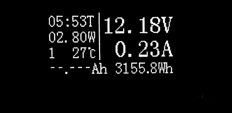

On 1/31/2024 at 2:27 PM, bagican said:
With better SSD a bit better power consumption.
I swapped Samsung 970 Evo to Samsung 980 Pro 2TB and idle power consumption (mostly in C10) is:
⚡️on the DC side:
⚡️on the AC side: ~2,8 Wh (from Shelly 1PM) is average consumption for last 2 hours.
It's known that Pro models from Samsung SSDs have better power management and they are more efficient.

Note that I also changed USB from old Patriot 16GB to new 16GB Transcend JetFlash 180I (industrial-grade USB flash drive with SLC mode https://us.transcend-info.com/embedded/product/embedded-flash-solutions/jetflash-180i  ).
Update:
- added 2x SATA SSDs (Samsung 860 Evo 4TB)
- added 1x USB2 Flash drive (to make dummy Array)
- running 2 dockers
and idle power consumption is now:
⚡️on the DC side:
⚡️ 2.5 — 6 W on the DC side
and average 4Wh on the AC side (measured by Shelly 1PM)

In Windows I have C8 pkg C-State (Throttlestop utility) and 4.5 watts from the wall at idle (display went to sleep).
in Proxmox (sorry I don't use Unraid but this forum is a godsend) as you see I have
C10 (couldn't believe my eyes at first) and 5.5 - 6 watts from the wall with disks spinned down (added 2 2,5" HDDs: 250GB Samsung HM250HI and 4TB Seagate ST4000LM016 instead of Plextor SSD)
