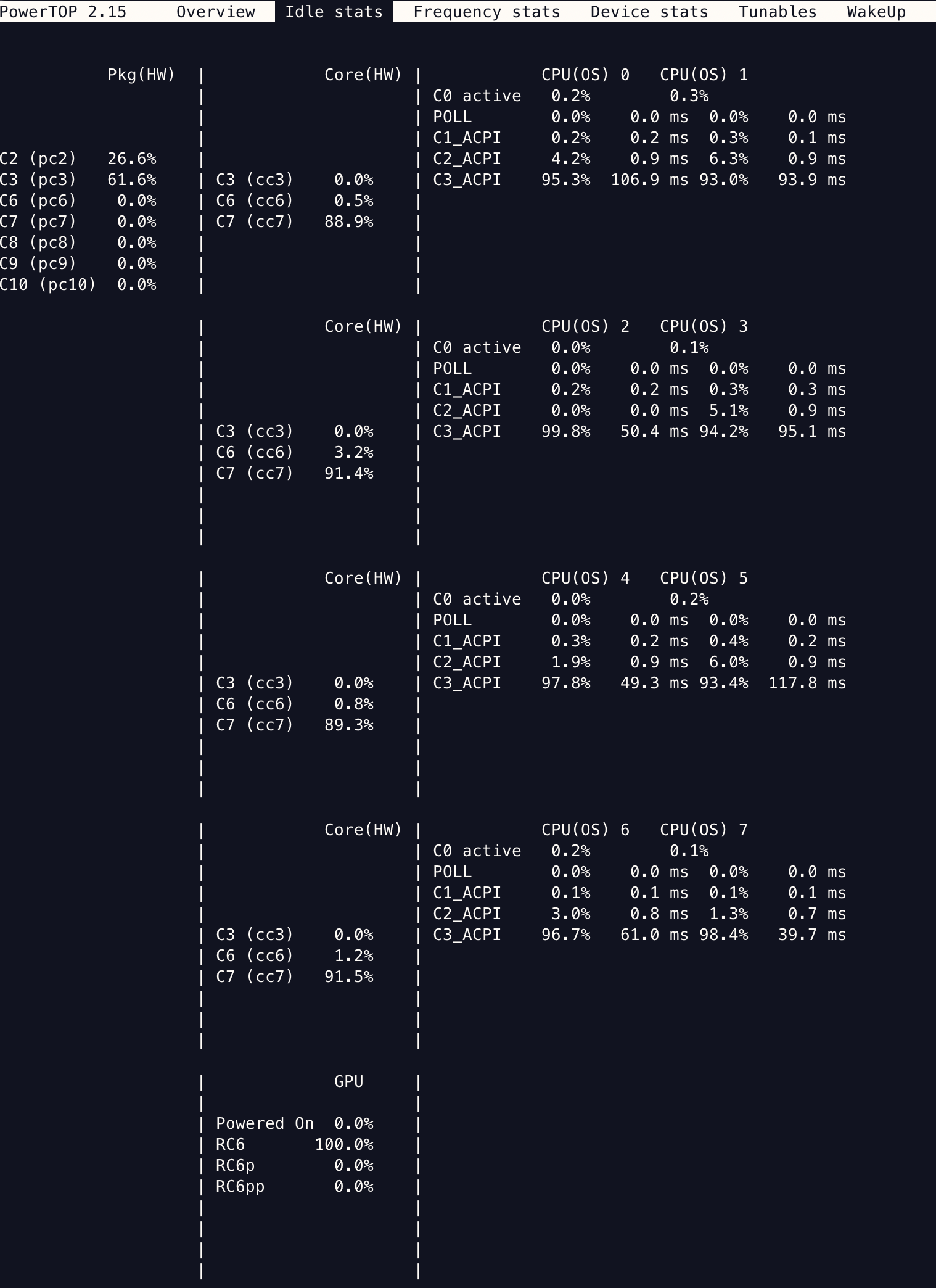

I'm back with some updates @mgutt, and thanks for your quick reply.
11 hours ago, mgutt said:
Two active disks cost you 10 to 16W. Why are they active?
Parity + Disk1. I'm kinda failing to troubleshoot what causes Parity drive to constantly spin up. Even if stopped manually. Possibly will create separate topic for that.
Disk1 keeps mainly the files that my family is using or content being read by qbit, so I can live with that one active.
Not the best for super low power consumptions, but at the moment not your main problem.
As per 80Plus Gold, should have something around 90% efficiency at loads below 20%. Platinum gives only +2%, rated 92%
Ask the biostar support. If their answer doesn't make you happy: Throw it in the trash.
Created support ticket, but no idea about their response times. Will see.
Disable array auto start, remove both components, spindown your HDDs, execute powertop and check if this influences your PKG states. If yes, find out, which of both is your problem.
Removed both components and enabled back motherboard 1gbe.
disabled array auto start, and used guide command to spin down all drives:
Executed auto tune and powertop (via ssh), to see if theres any difference with removed devices:
All Tunables are good, but it still sits at C3, even with cores doing C7 and frequency going down to 800mhz.
Main change is that only 2 devices are now listed as ASPM disabled/not supported.
btw. with removed devices, and all disk spun down, its at 23-24W.
Any hope for me, or just unlucky with mobo selection for going low with power consumption?
Edited by Alistar
formatting
Read the first post. The rating levels are completely irrelevant for low power consumption efficiency.
At the moment it looks like a very bad board for low power consumption 😔  I think the main problem of this board is the ASM1064 SATA controller. As far as I know this controller is incompatible to ASPM, which means it stops the whole cpu package reaching a lower state than C3.
Right. I've seen it earlier, but forgot about this specific fragment.
Would you recommend any "confirmed" mATX motherboard or nvme? Considering I will use this config for at least few years, might be worth selling biostar + lexar (it has aspm not supported as well) and upgrade to something else (to be honest I do not expect any miracle from biostar support).
Its so annoying that the Intel i226-v 2.5gbe network card prevent any higher C-States...

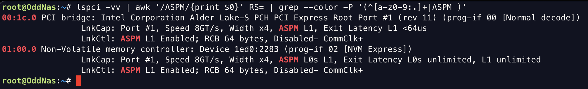

I was not able to directly test it, as ASPM settings are not available on motherboard level.
One of the commands says it supports ASPM L1. Unless L1 is not sufficient and what really matters is only L0sL1 ?
Maybe in your BIOS configuration there are some option not enabled.

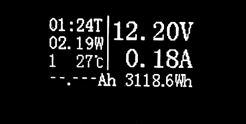

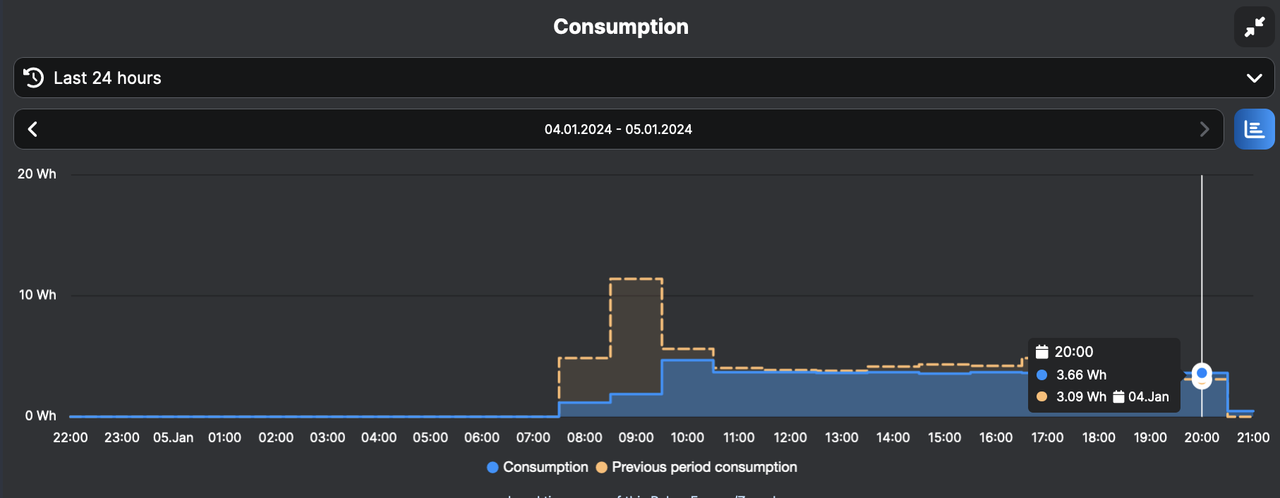

Here is consumption from my Shelly 1PM:
So previously measurements 2.5—3 W on the DC side
corresponds to 3.6—3.7Wh according to Shelly 1PM (on the AC side).
Average power consumption for last 11 hours is 3.75 Wh ⚡.
Cool :)
 Consumption Time, Wh
  05/01/2024 10:00 , 4.71
  05/01/2024 11:00 , 3.7
  05/01/2024 12:00 , 3.67
  05/01/2024 13:00 , 3.62
  05/01/2024 14:00 , 3.7
  05/01/2024 15:00 , 3.6
  05/01/2024 16:00 , 3.68
  05/01/2024 17:00 , 3.66
  05/01/2024 18:00 , 3.6
  05/01/2024 19:00 , 3.67
  05/01/2024 20:00 , 3.66
          average = 3.75

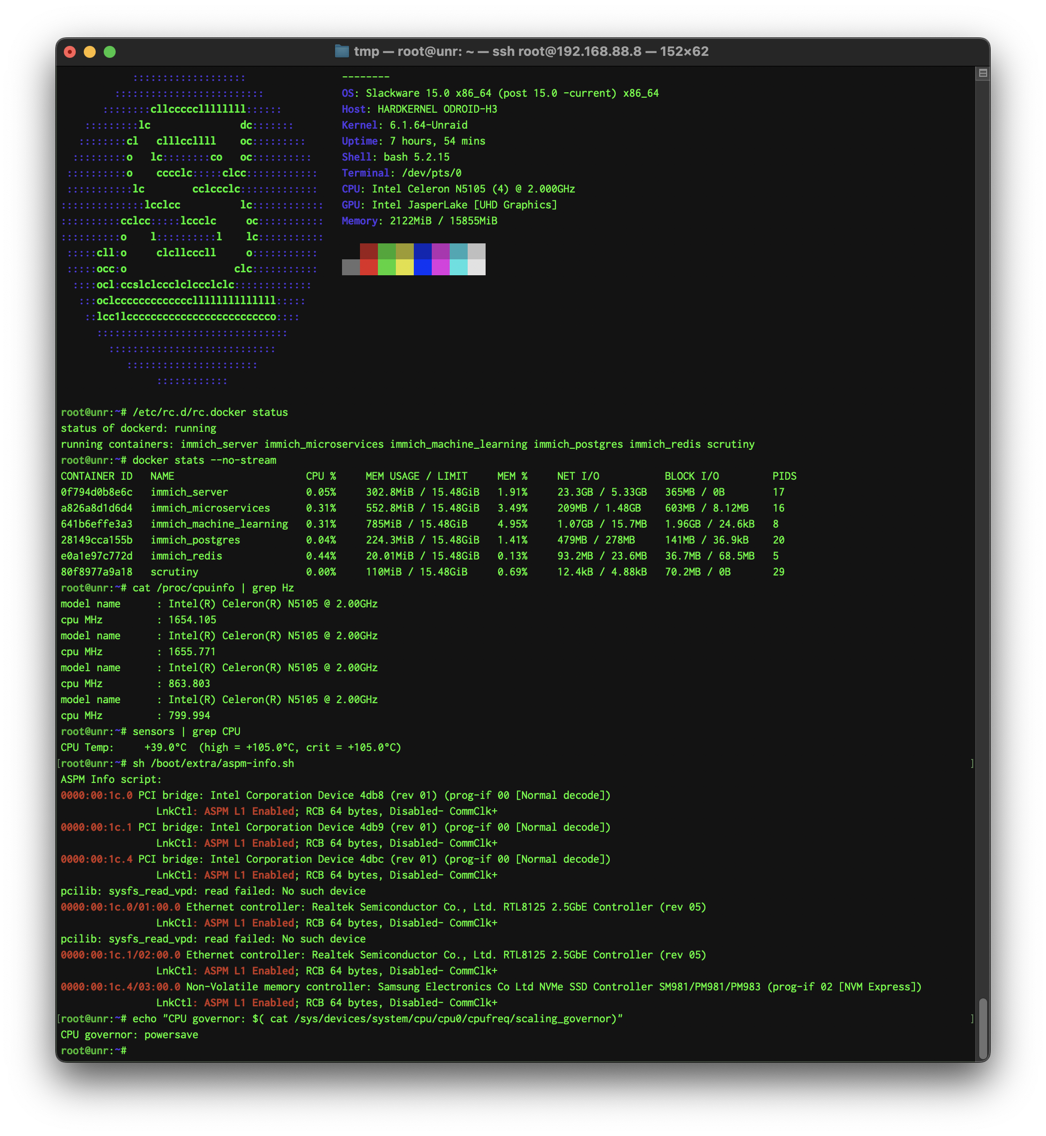

with these running docker containers:212641518_Screen2024-01-04at16_08_50.thumb.png.0ddad8594b7243f8dd973b730b7499b6.png
HW: Odroid H3 (Intel N5105, Turbo disabled)
RAM: 1x 16GB DDR4 Crucial 3200
SSD: 1x m.2 Samsung 970 Evo 500GB
Power supply: 12V 150W from AKASA (https://www.akasa.com.tw/update.php?tpl=product/product.detail.tpl&model=AK-PD150-02K)
+ into power consumption measurements is included also OLED DC power meter: https://www.aliexpress.com/item/33012984676.html
With better SSD a bit better power consumption.
I swapped Samsung 970 Evo to Samsung 980 Pro 2TB and idle power consumption (mostly in C10) is:
⚡️on the DC side:
⚡️on the AC side: ~2,8 Wh (from Shelly 1PM) is average consumption for last 2 hours.
It's known that Pro models from Samsung SSDs have better power management and they are more efficient.

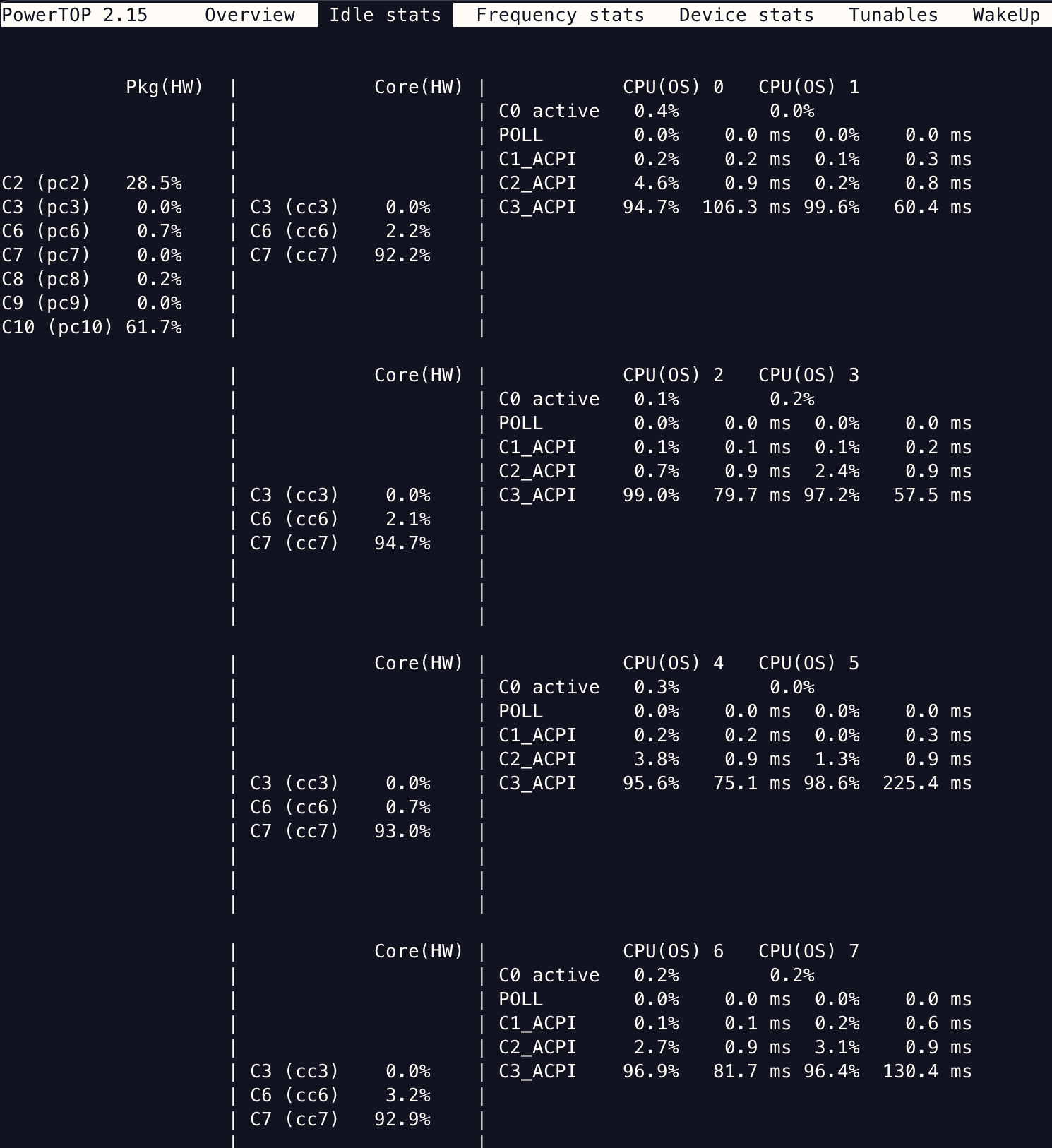

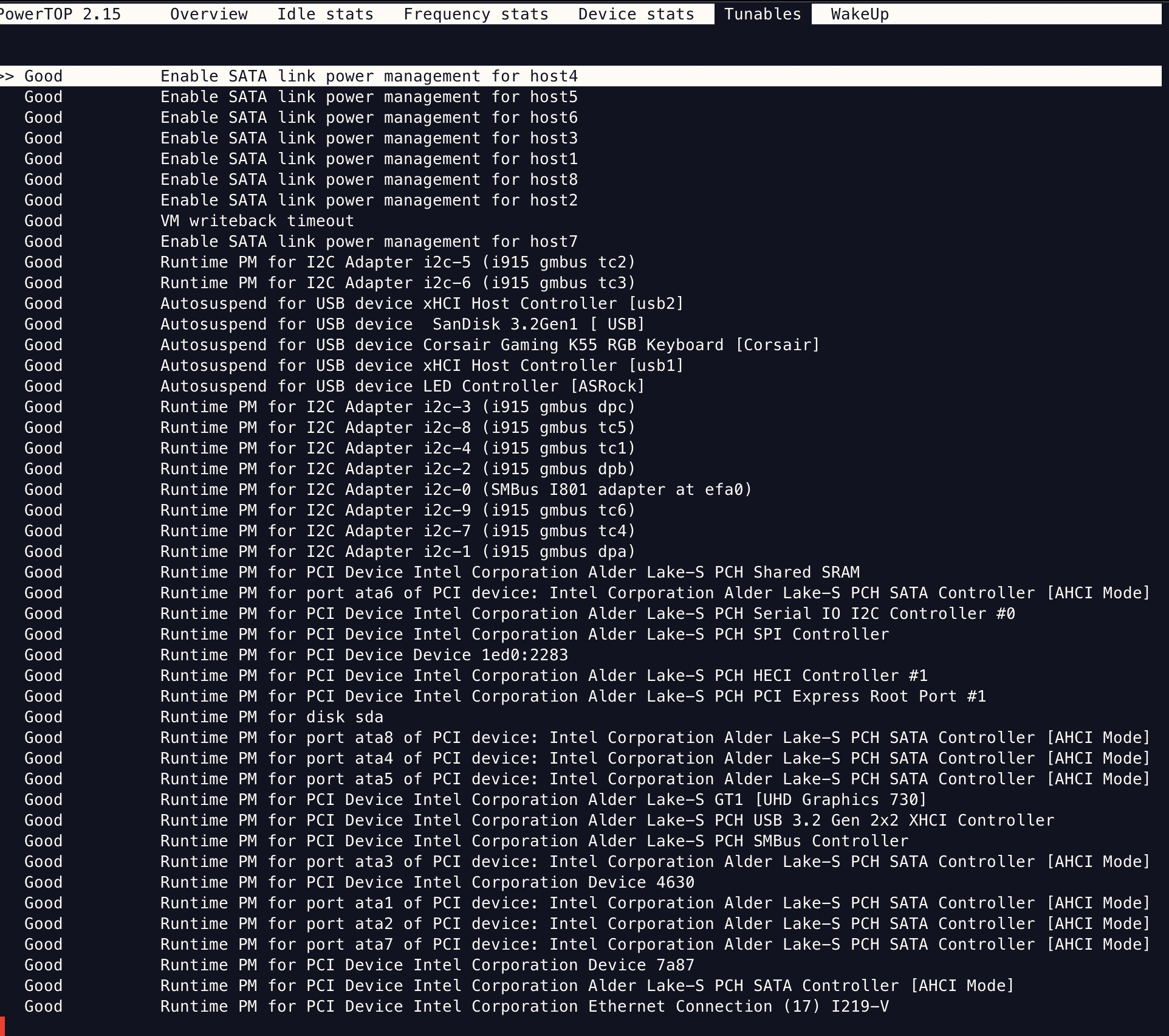

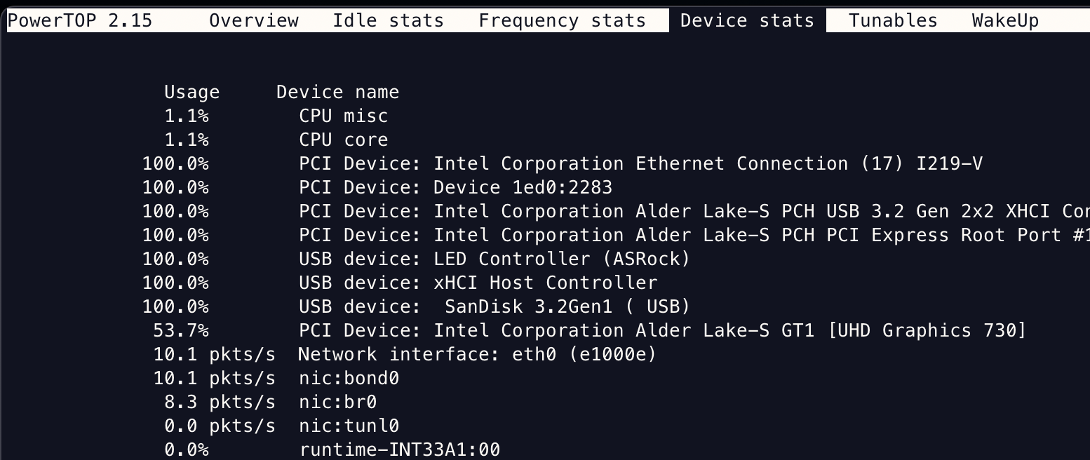

Hey guys, I've followed the guide, but I can't reach better than C3 PKG states. Hoping to get some help here :)
My System is:
CPU: i3-13100
MB: AsRock H610m-itx
RAM: Mushkin 2x32GB
SSD: Teamgroup MP33 Pro 2TB
I haven't installed HDDs yet, since I'm still waiting for my case, lol. (So I decided to dive into this topic while waiting xD)
Not sure if this matters, but I've not created the Cache Pool with my SSD either.
The iGPU driver however is installed.
Current Idle Draw: 15W (I assume/hope this can still go lower)
I've attached screenshots of my powertop idle stats, device stats and tunables, as well as the ASPM stats.
Device Stats looks suspicious to me, since some devices are permanently at 100%?

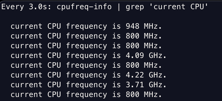

When checking the CPU frequency there are always some cores jumping to ~4GHz before going down to 800MHz again.
Unraid WebGUI was not open, I only used the terminal to access Unraid.
Additionally, here are my BIOS settings:
CPU Config:
  • Hyper Threading: Enabled
  • Active P-Cores: All
  • CPU C States Support: Enabled
  • Enhanced Halt State: Enabled
  • CPU C6 & C7 Support: Enabled
  • CPU Package C State Support: Enabled
  • CFG Lock: Disabled (couldn't find any real info on what this does ¯\_(ツ)_/¯ )
  • C6DRAM: Enabled
  • AVX/AVX2: Enabled
  • Intel Virtualization Technology: Enabled
  • Hardware Prefetcher: Enabled
  • Adjacent Cache Line Prefetch: Enabled
Chipset Config:
  • Primary Graphics Adapter: Onboard
  • Above 4G Decoding: Enabled
  • Clever Access Memory: Enabled
  • VI-d: Enabled
  • SR-IOV Support: Enabled
  • DMI Link Speed: Gen4
  • PCIE1 Link Speed: Auto
  • PCI Express Native Control: Enabled
  • PCIE ASPM Support: L1
  • PCH PCIE ASPM Support: L1
  • DMI ASPM Support: Enabled
  • PCH DMI ASPM Support: Enabled
  • iGPU Multi Monitor: Disabled
  • Intel® Ethernet Connection I219-V: Enabled
  • Onboard HD Audio: Disabled
  • Onboard WAN Device: Disabled
  • Deep Sleep: Enabled in S4-5
  • Restore on AC/Power Loss: Power Off
  • Restore Onboard LED Default: Disabled
  • RGB LED: Off
  • GNA Device: Disabled
Storage Config:
  • SATA Controller(s): Enabled
  • SATA Mode Selection: AHCI
  • Hybrid Storage Detection and Configuration Mode: Disabled
  • SATA Aggressive Link Power Management: Enabled
  • Hard Disk S.M.A.R.T: Enabled
ACPI Config:
  • Suspend to RAM: Auto (other choice was disabled)
  • PS/2 Keyboard Wake Support: Disabled
  • PCIE Devices Power On: Disabled
  • I219 LAN Power On: Disabled
  • RTC Alarm Power On: By OS
  • USB Keyboard/Mouse Power On: Disabled
USB Config
  • Legacy USB Support: Enabled
  • XHCI Hand-off: Disabled
Lastly: I found this post on askubuntu.com, which was about the my exact MB, is that something I should look into? Don't want to go around installing Windows on my SSD and doing some potential dangerous stuff before asking here first :D

High friends. Just curious who's got the lowest wattage for an active system running frigate NVR & plex and whats your build.
Another ASRock owner did the same in this thread and this was his only option:
https://forums.unraid.net/topic/98070-reduce-power-consumption-with-powertop/page/26/#comment-1355095
Maybe this SSD prevents lower C-States. Check without it.
Gonna try a couple more things in BIOS before giving this a try, will report back after that.
Checked without it, sadly not the cause of my problems. (Or luckily I guess, since I don't need to send it back, lol)

I am also trying to apply @genesisdoeswhatnintendont guide to the asrock z790 pro rs d4. I disabled it and my USBs are still working. I think its some sort of RGB LED Controller maybe?
In my case i still cant reach deeper C-States than C3 eventhough I enabled ASPM for all my devices. Enabled C-States. Deactivated every unnecessery device and yet i am only able to reach c3. "Native ASPM" is disabled. Any suggestions what else i could try to tune?
Also does anybody know why i get an error when running lspci -vv | awk '/ASPM/{print $0}' RS= | grep --color -P '(^[a-z0-9:.]+|ASPM )'
could this be the culprit?

Same board, same problem. It's got to be something with the hardware, either the sata controller or the RGB controller would be my guess. It's almost like turning off the RGB controller in bios doesn't actually turn it off, as if it's off but still getting power. I don't know. It would literally be the best Z790 board if you could easily enable C10. Maybe a new bios version will fix it? I've done just about everything I can at this point.
 My guess is Realtek 2.5G LAN is the culprit.  God I hate Realtek so much! 😡
My 2 cents: ATX motherboard (especially with Realtek NIC) and with Z-chipset is not the best choise for low power consumption setup.
I guess so as well. However, im idling at 65w with 8 hdds and 3 nvmes and 20+ container running which is still good i suppose. and yet id love to know how deep i could go.
my proxmox build idles between 20 and 25 watt (5 ssds + 4 hdds)  and reaches c8. Just for science id love to know how big the impact is.
Ill try your suggestions regarding the RGB LED controller and report back. Maybe it helps somehow :D
