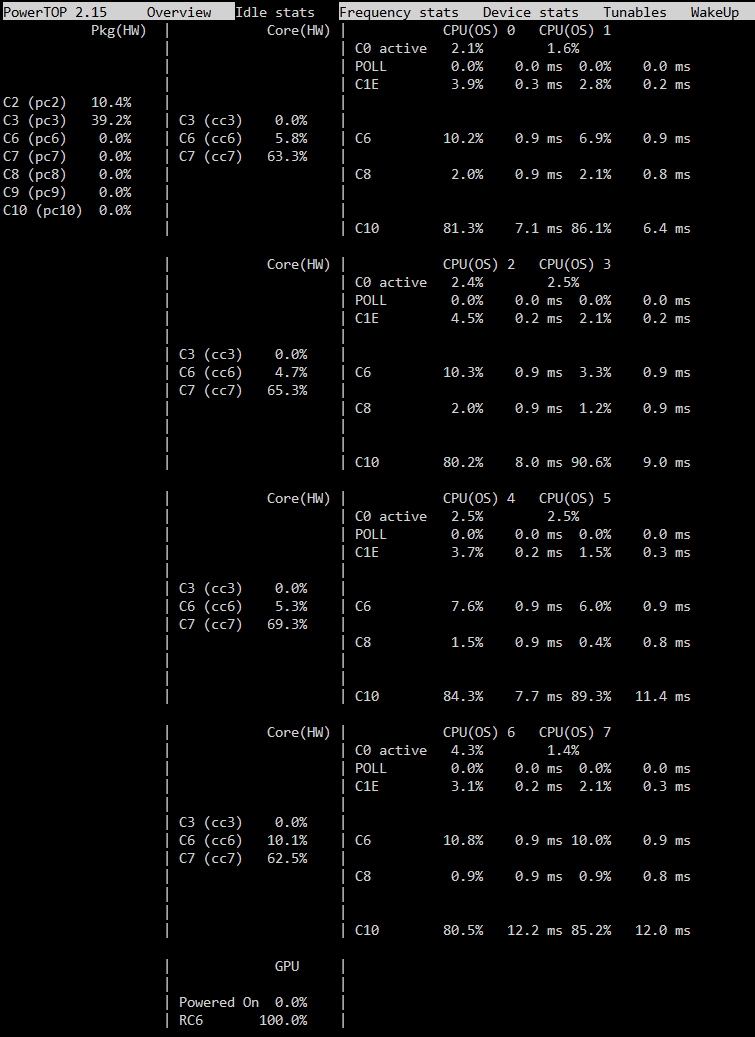

    Good news everyone! I managed to get C10 pkg C-State (previously I get no higher than C3) on Asrock LGA1700 mobo and you can too. Yay!   My setup is:   Motherboard: Asroc
  • I added a warning:   And a further explanation to the initial post:

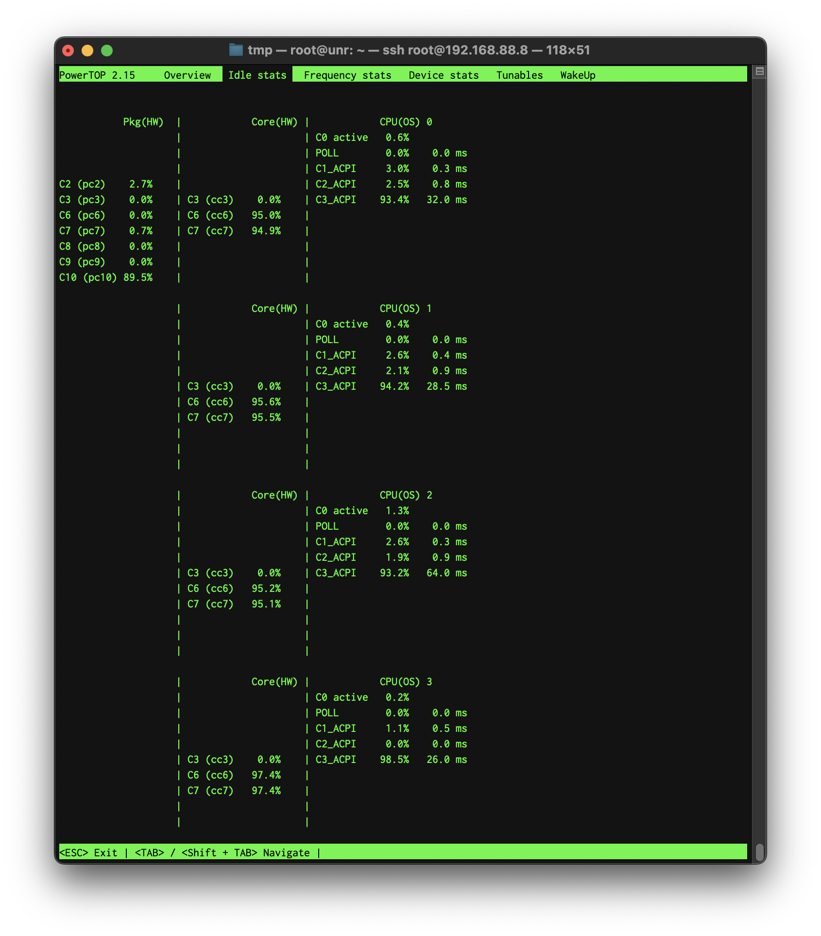

Hello
N100DC-ITX with 12V 72W Leicke power brick:
Ethernet connected(reaching c3 state):
  • Idle: Just board with unraid usb + nvme + -> 7.5W
  • Idle: Just board with unraid usb + nvme + ASM1116-> 9W
  • Idle: Just board with unraid usb + nvme + ASM1116 + Samsung Evo SSD (just connected) -> 9W
Ethernet disconnected(reaching c8 state)
  • Idle: Just board with usb and nvme -> 5.5 W
  • Idle: Just board with unraid usb + nvme + ASM1116-> 7W
  • Idle: Just board with unraid usb + nvme + ASM1116 + Samsung Evo SSD> 7.1~7.8W
    • (ssd just connected trough jonsbo n2 sata board, and is recognized and available to unraid)
How have i get this data? First I have checked as suggested by @mgutt, I connected with HDMI in the 3 scenarios. I've checked C-States. When ethernet is diconnected. realtek 8111 aspm kernel bug is avoided, and reach c8 state. So, to measure without hdmi consumption I just repeat the process , disconnect hdmi, and see how power consumption goes down as normally does when c8 package is reached.
At this point, I haven't tested Ubuntu yet,but a few caveats:

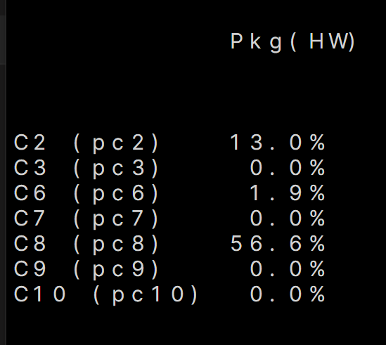

ASPM is set enabled for ASM1166, with ssd sata connected. And c8 is achieved. Can we already say that asm1166 firmware is enough?
For last scenario, for example, this is the capture:
By the way,I never see c8 state going beyond >42% everytime I open powertop. As time pass by at this state, shouldn't it increase? Maybe powertop stops refreshing too.
Which power effiency approaches can be done for ssd sata? In my case I am going to create an unraid with all ssd.
Regards

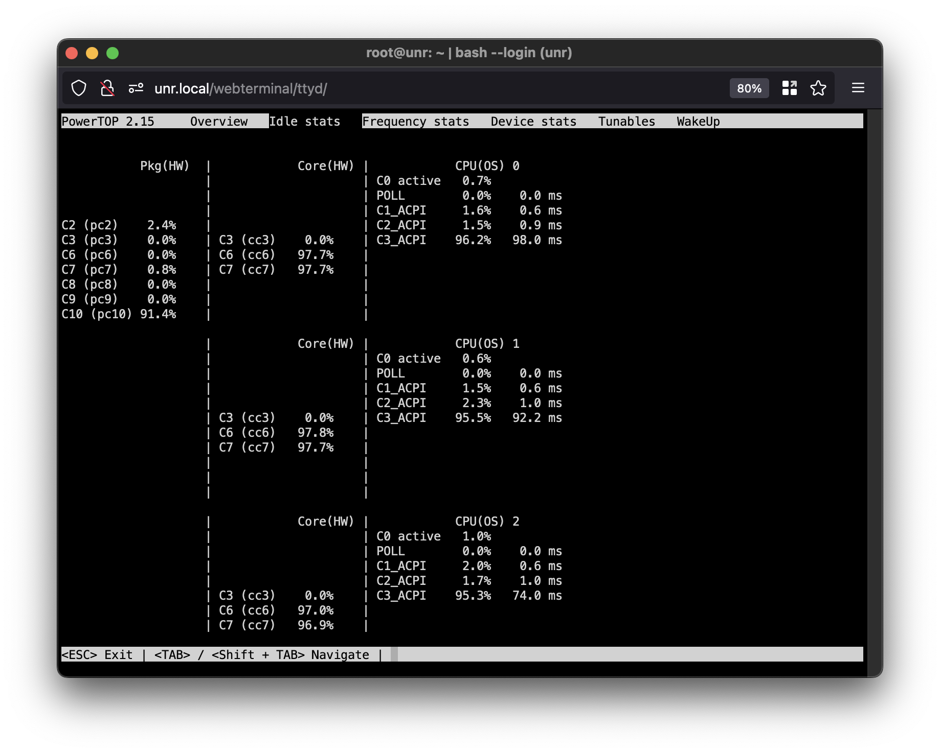

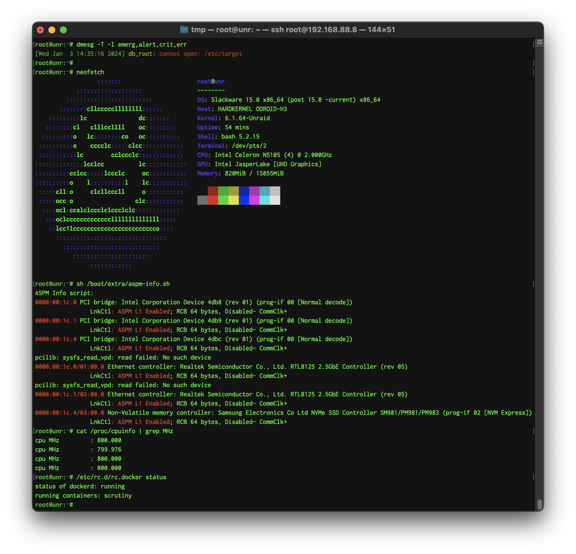

Hello, I'm very new to Unraid.
Here is my first day with trial Unraid on Odroid H3:
1878844598_Screen2023-12-28at22_16_57.thumb.png.d00263971841af82c1b3e7ee75398bc4.png216906265_Screen2023-12-28at22_17_26.thumb.png.c93cb99677f75f5080a5d92fa71e2d32.png722808079_Screen2023-12-28at22_18_28.thumb.png.b049888b16054238f5acd0dbecf82e85.png
Idle power consumption: 2.4—3.5W (on DC side)

In my previous post I had array stopped.
When my array is started with one SSD with ZFS with compression then I have only C1-C2 State and idle power consumption is 4—5W.
//update (2023-01-02) when I unplugged cheap SATA SSD (128GB from AliExpress for 10 Eur) and replaced it with NVME Samsung 970 Evo then package CPU is able to reach C10 again and idle power consumption is back to ️ 2.4—3.5W. With started array and with running 2 docker containers! wohooo! 🙂

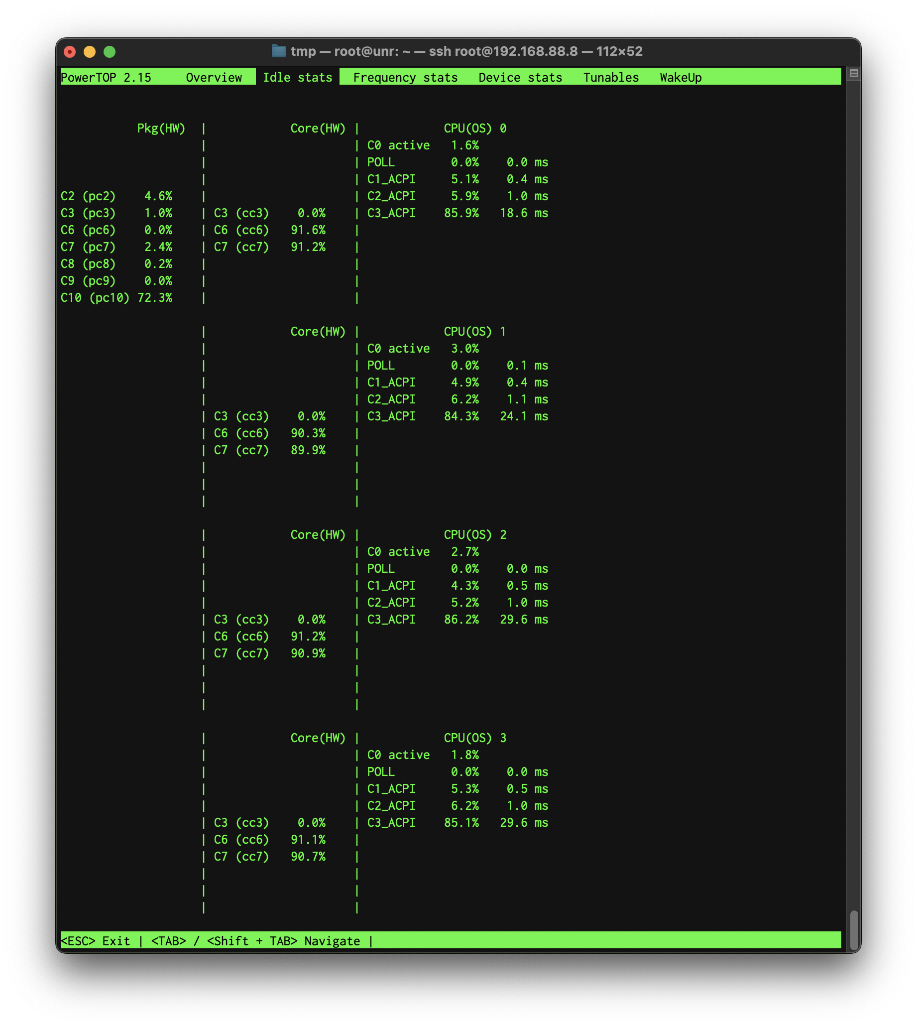

here is with logged off and closed WebUI with 1 docker container running:
1867535728_Screen2024-01-03at15_33_06.thumb.png.a5708850ce29951d5d94c5a0ec17afaa.png399553774_Screen2024-01-03at15_32_44.thumb.png.1a8dc03e6b967ccbacf2aa19e20d132c.png
here is my powertop report: https://jsbin.com/hifepomaki/edit?output

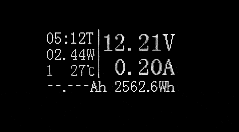

Here is consumption from my Shelly 1PM:
So previously measurements 2.5—3 W on the DC side
corresponds to 3.6—3.7Wh according to Shelly 1PM (on the AC side).
Average power consumption for last 11 hours is 3.75 Wh .
Cool :)

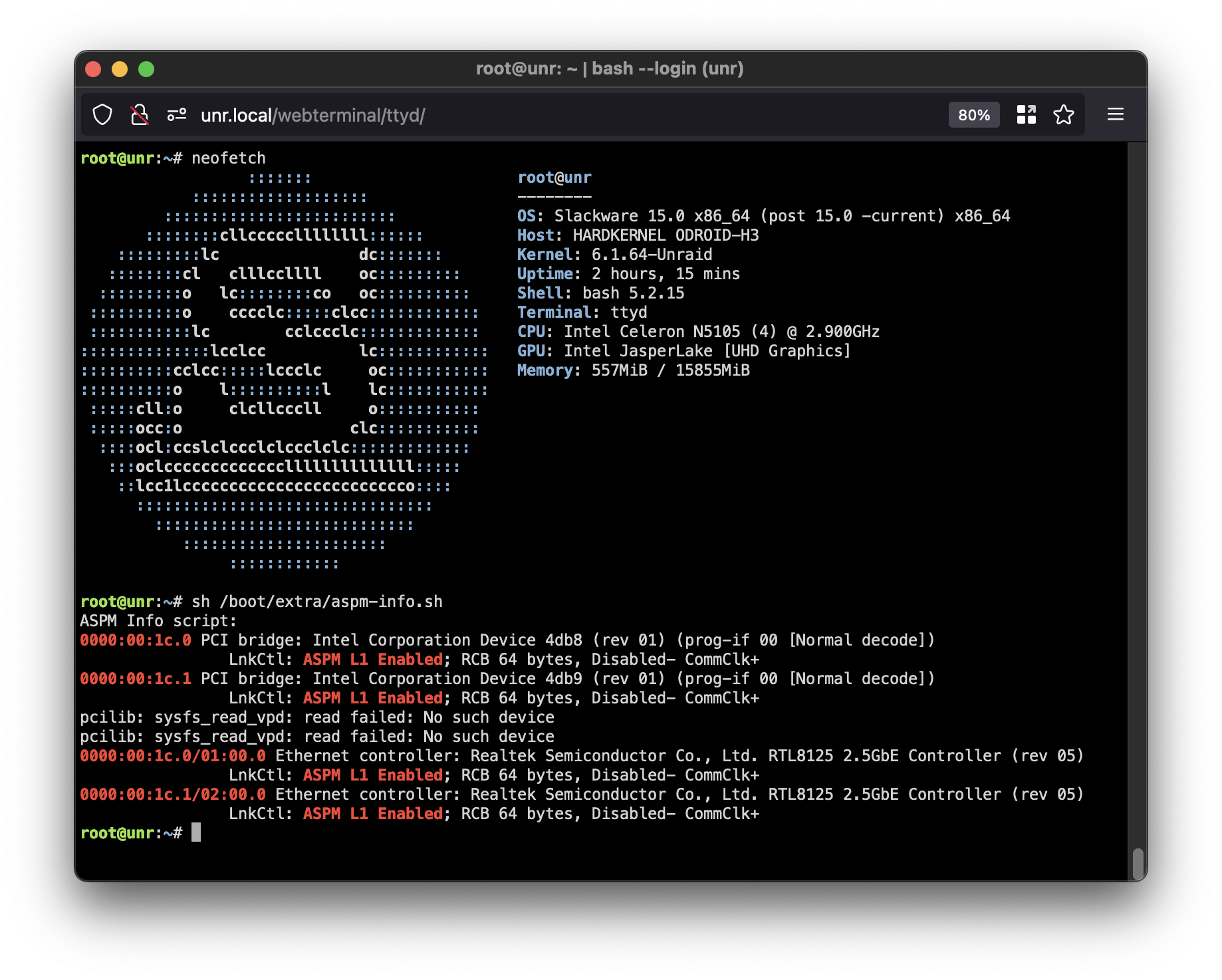

with these running docker containers:212641518_Screen2024-01-04at16_08_50.thumb.png.0ddad8594b7243f8dd973b730b7499b6.png
HW: Odroid H3 (Intel N5105, Turbo disabled)
RAM: 1x 16GB DDR4 Crucial 3200

+ into power consumption measurements is included also OLED DC power meter: https://www.aliexpress.com/item/33012984676.html

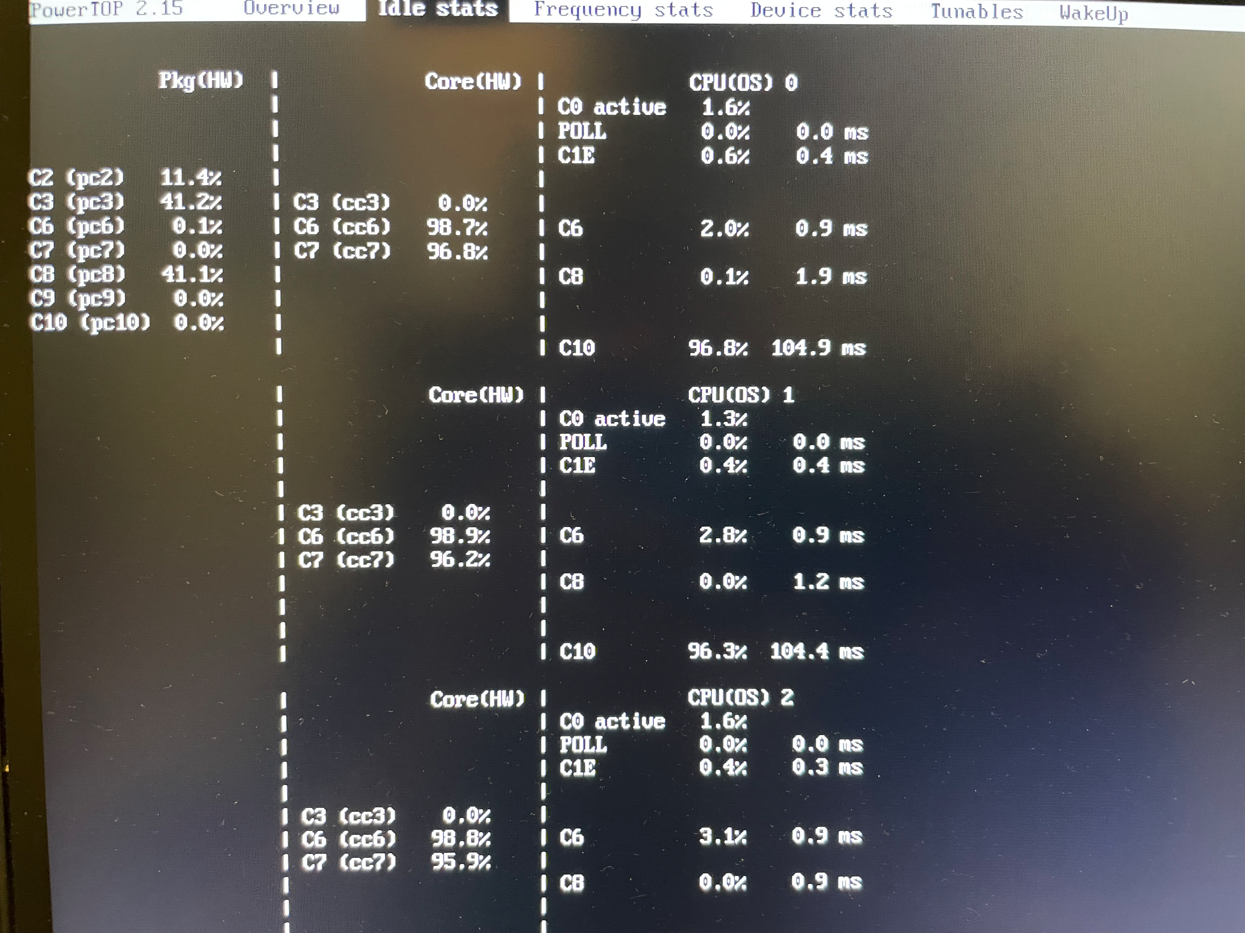

Question about Idle stats in powertop: I consider to run one VM (Home Assistant). I suppose that running a VM will affect "Idle stats", right?
Currently I have ~ 60—70% in C10 Pkg state with couple of docker containers.
PowerTOP 2.15     Overview   Idle stats
           Pkg(HW)  |            Core(HW) |            CPU(OS) 0
                    |                     | C0 active   2.7%
                    |                     | POLL        0.0%    0.0 ms
                    |                     | C1_ACPI     5.5%    0.4 ms
C2 (pc2)    5.9%    |                     | C2_ACPI     6.4%    1.0 ms
C3 (pc3)    2.3%    | C3 (cc3)    0.0%    | C3_ACPI    84.0%   16.8 ms
C6 (pc6)    0.0%    | C6 (cc6)   90.0%    |
C7 (pc7)    2.6%    | C7 (cc7)   89.6%    |
C8 (pc8)    0.4%    |                     |
C9 (pc9)    0.0%    |                     |
C10 (pc10) 64.3%    |                     |
Does running a linux VM will significantly affect Idle stats?
