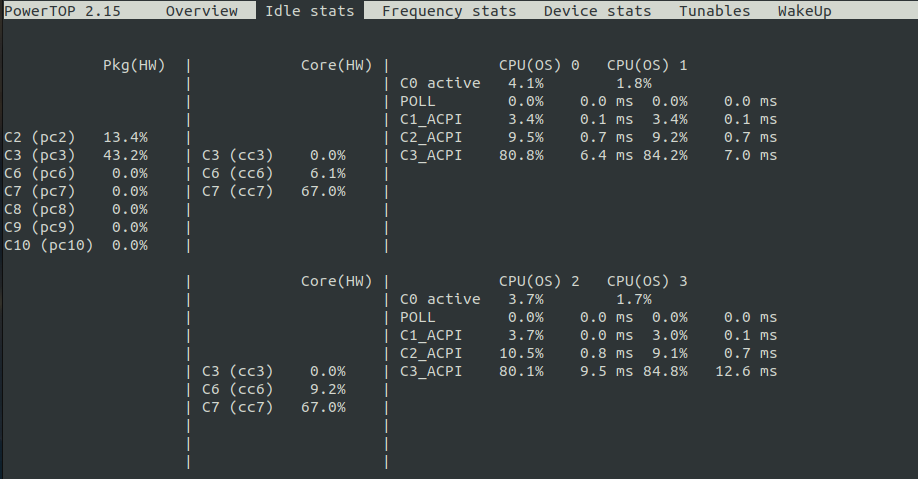

I'm on a 5800x3d + B550i. My ram was running at XMP 3600C16 which I THINK might've been the culprit of a few unresponsive events I had where I had to force a shutdown. It was either that or Power Supply Idle Control. So I've changed the ram to 3200C16 as well as Power Supply Idle Control to Current. Which would mean effectively disable C6.
So that's potentially problematic right? If I want the system to idle better. My 1660Ti is already idling at 8w on P8 which is nice. So is PCIE ASPM (have 2 options, L0 and L1 or just L1) be necessary for anything else? NVME drives maybe?
Right now, with powersave governor + 3 HDDs spundown it's idling at 60w. Still very high in my opinion. Would want to push this even lower but don't know where to start. Not sure if it's worth getting powertop running before getting all the correct options in BIOS sorted?

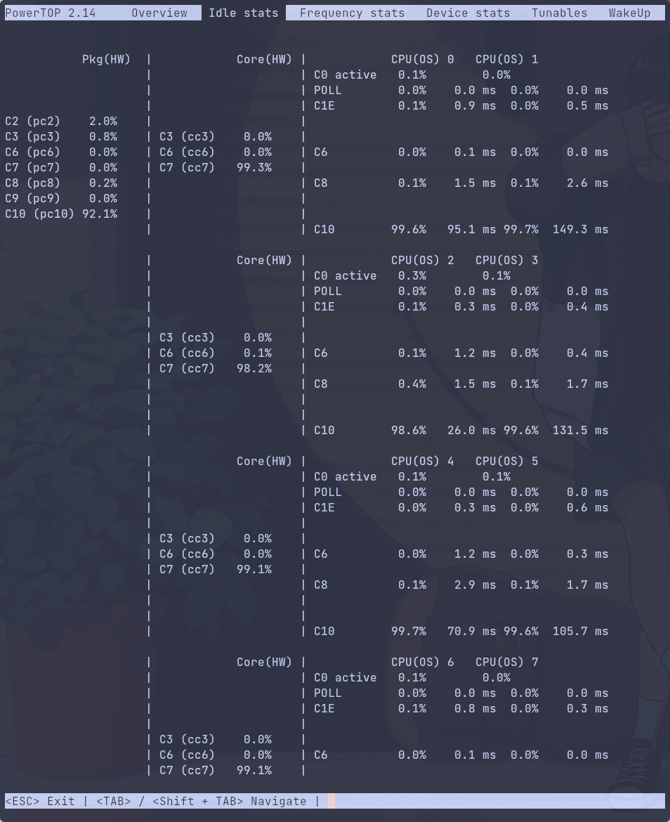

    Good news everyone! I managed to get C10 pkg C-State (previously I get no higher than C3) on Asrock LGA1700 mobo and you can too. Yay!   My setup is:   Motherboard: Asroc
  • I added a warning:   And a further explanation to the initial post:

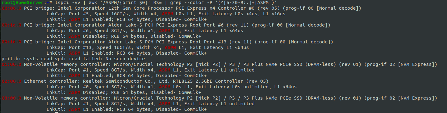

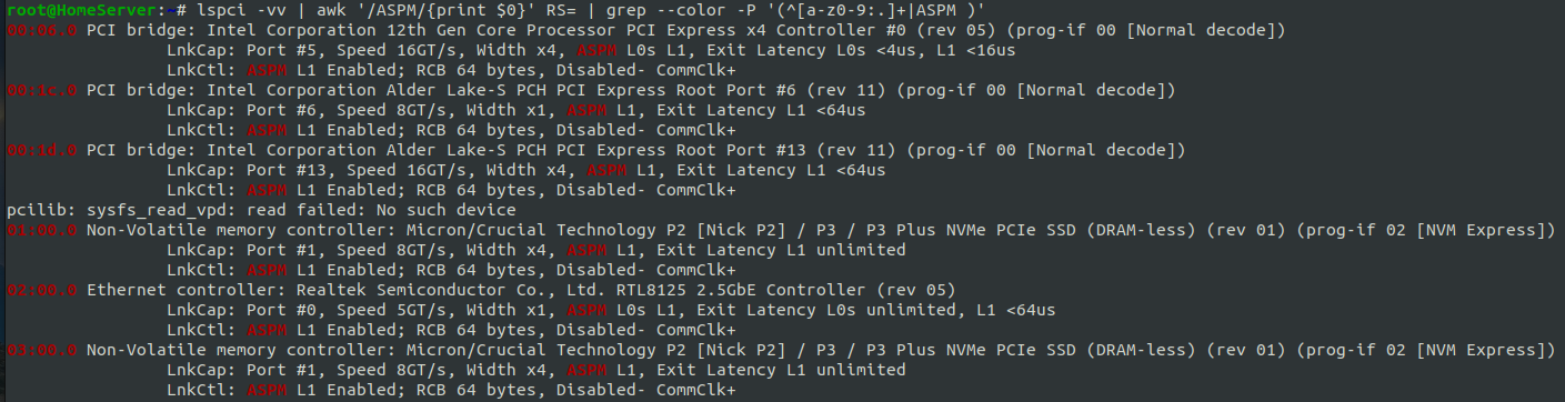

Hi people!
My setup is:
  • Mobo: ASRock H670M-ITX/ax
  • RAM: 2X16GB
  • PSU: picoPSU 150w
  • CPU: 13th Gen Intel® Core™ i3-13100 @ 3366 MHz
  • 2 nvme as cache: Crucial P3
  • 2 SSD: 1 Samsung 870QVO and 1 Crucial BX500
  • 2x12TB HDD: 1 parity and 1 data disk
Unfortunately I'm not able to go lower than C3.
The ASPM output shows ASPM disabled for 2 devices:
I've enabled all ASPM settings, p-cores and c-states supports as suggested in the first @mgutt post but I'm still unable to understand why I cannot enable ASPM also for those 2 devices shown in the above output.

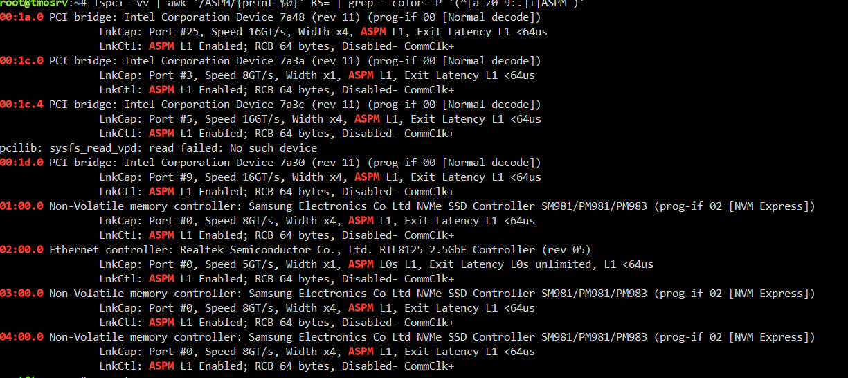

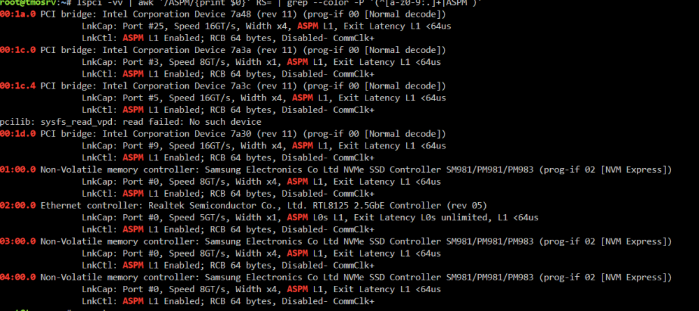

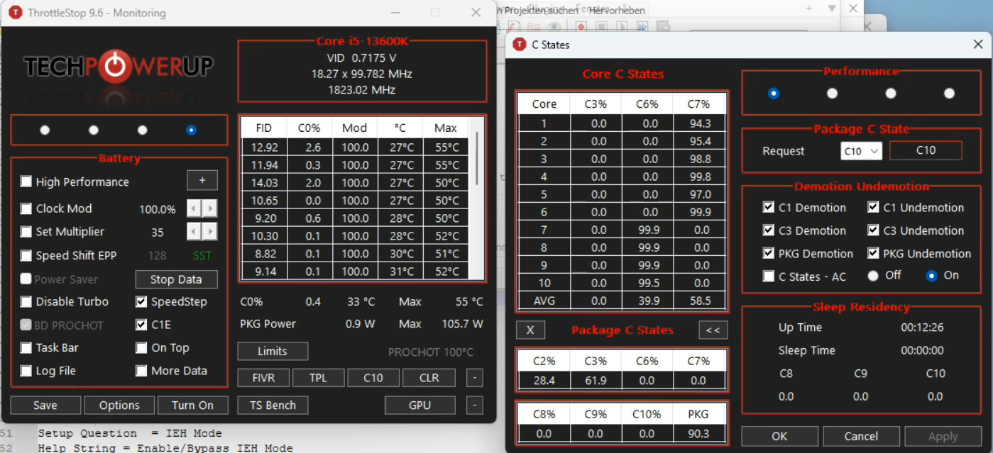

On 2/1/2024 at 4:27 PM, tmodev said:
I am also trying to apply @genesisdoeswhatnintendont guide to the asrock z790 pro rs d4. I disabled it and my USBs are still working. I think its some sort of RGB LED Controller maybe?
In my case i still cant reach deeper C-States than C3 eventhough I enabled ASPM for all my devices. Enabled C-States. Deactivated every unnecessery device and yet i am only able to reach c3. "Native ASPM" is disabled. Any suggestions what else i could try to tune?
Also does anybody know why i get an error when running lspci -vv | awk '/ASPM/{print $0}' RS= | grep --color -P '(^[a-z0-9:.]+|ASPM )'
could this be the culprit?
EDIT: I am also using a PiKVM which is plugged in via HDMI.
Storage:
3x 1Tb Samsung 970 Evo Plus (can do c10)
8x 16Tb Toshiba MG08 (can do c8 atleast)
Throttlestop on Windows:
perhaps because this patch needs to be included in the kernel?
This fixed the Realtek card issue with ASPM disable. Now it is shown as enabled:
echo 1 > /sys/bus/pci/devices/0000:02:00.0/link/l1_aspm
Unfortunately powertop still shows

On 1/18/2024 at 2:42 AM, genesisdoeswhatnintendont said:
Good news everyone!

In Windows I have C8 pkg C-State (Throttlestop utility) and 4.5 watts from the wall at idle (display went to sleep).
in Proxmox (sorry I don't use Unraid but this forum is a godsend) as you see I have
C10 (couldn't believe my eyes at first) and 5.5 - 6 watts from the wall with disks spinned down (added 2 2,5" HDDs: 250GB Samsung HM250HI and 4TB Seagate ST4000LM016 instead of Plextor SSD)

Thanks for your tipps. I finally managed to reach c8 on my Asrock Z790 Pro RS/D4 after months of trying. I had to uninstall the Realtek driver plugin to go deeper than c3 after the update.
Update: I actually reach C10 now.  Amazing. :D
Edited by tmodev

On 2/23/2024 at 9:12 PM, quietwalker said:
Do anyone of you have any suggestion for me?
I'm glad I posted this guide on Reddit too lol
The 1st issue is probably Realtec LAN
The 2nd guess is Crucial P3 (check this post by @Ellissss , C3 with p3 plus and C10 without)

On 2/14/2024 at 5:35 PM, de-sascha said:
Hi long pause between. But today I tried on my  ASUS Pro H610T D4-CSM
echo 1 | sudo tee /sys/bus/pci/drivers/r8169/0000\:02\:00.0/link/l1_aspm
To activate L1 ASPM on the Realtek RTL8111H
But I don't know why I don't have permissions to. See:
root@nasnas:~# lspci -vv | awk '/ASPM/{print $0}' RS= | grep --color -P '(^[a-z0-9:.]+|ASPM )'
00:1c.0 PCI bridge: Intel Corporation Alder Lake-S PCH PCI Express Root Port #1 (rev 11) (prog-if 00 [Normal decode])
        LnkCap:    Port #1, Speed 8GT/s, Width x1, ASPM L0s L1, Exit Latency L0s <1us, L1 <4us
        LnkCtl:    ASPM L0s L1 Enabled; RCB 64 bytes, Disabled- CommClk-
00:1c.2 PCI bridge: Intel Corporation Device 7aba (rev 11) (prog-if 00 [Normal decode])
        LnkCap:    Port #3, Speed 8GT/s, Width x1, ASPM L1, Exit Latency L1 <64us
        LnkCtl:    ASPM L1 Enabled; RCB 64 bytes, Disabled- CommClk+
02:00.0 Ethernet controller: Realtek Semiconductor Co., Ltd. RTL8111/8168/8411 PCI Express Gigabit Ethernet Controller (rev 15)
        LnkCap:    Port #0, Speed 2.5GT/s, Width x1, ASPM L0s L1, Exit Latency L0s unlimited, L1 <64us
root@nasnas:~# echo 1 | sudo tee /sys/bus/pci/drivers/r8169/0000\:02\:00.0/link/l1_aspm
tee: '/sys/bus/pci/drivers/r8169/0000:02:00.0/link/l1_aspm': Permission denied
1
UPDATE!
ENABLE native ASPM support in BIOS fixed the permission issue
Mean ENABLE = OS ASPM support not BIOS support which is disable state.
UPDATE2:
C10 Working now!
Without HDDs connected around 5 Watt idle load
I need to enable ASPM on the Realtek NIC manuel:
You can simple use this Shell script. But may you need edit the Endpoint like here: 02:00.0

Hmm Powertop 2.15 shows nothing unter Pkg(HW). Is the Core i3-10100 to new for that?
I mean that CPU is a couple of years old.
Edited by darkside40
Did you enable APSM / power management C-state in the bios ? Not "auto" but need to be "enabled"
Yes i did and according to the drop of used power after setting all this it is working, only Powertop does not show anything.
I mean obviously that is only a cosmetic issue for me, because i can see the positive results that my unRaid now needs less energy ideling
