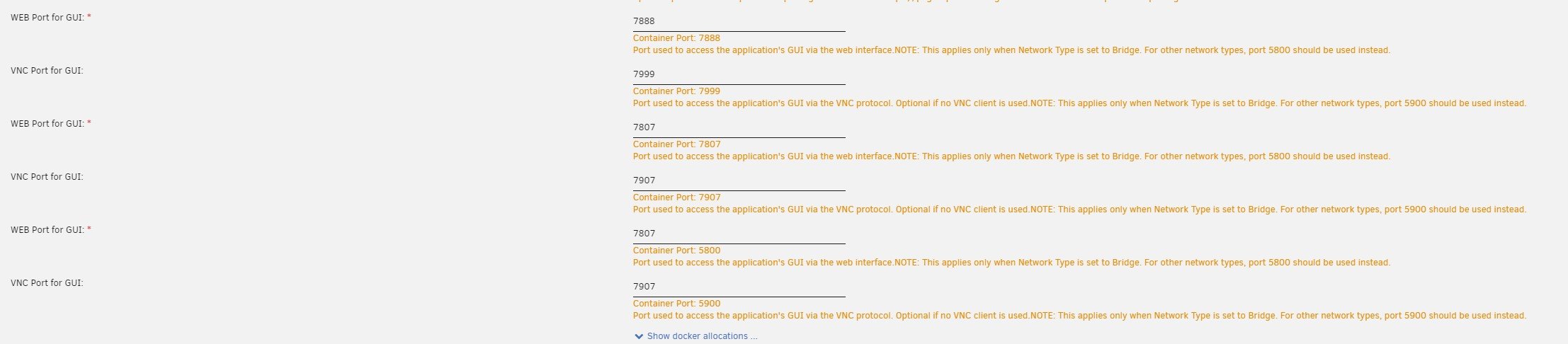

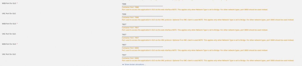

  11. Hello everyone, I updated my server with new hardware (mainboard and cpu) and now I couldn´t connect to my jdownloader web GUI anymore. First I showed an error "could connect to the server" and now I could not even start the GUI. I changed the ports but the container always tries to open port 5800 even if this port isn´t assigned anywere (see the screenshot). The "strange" thing is docker itself is running, I can access it through the myjdownloader webinterface, so really just the docker GUI isn´t working. I there anything I could try? Thanks
