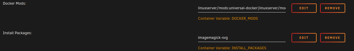

[Support] Linuxserver.io - Nextcloud
I've actually done it already and the warning is gone 🙂 but I agree the documentation is quite hard to overlook. Basically, you just need to set up these two variables in the container in two steps... 1. add the universal-package-installl Mod by adding a new variable to the container (2. screenshot) linuxserver/mods:universal-package-install 2. save -> apply which restarts the Docker 3. Add a new variable "Install Packages" which lists the stuff for the mod to be installed on the next restart, in our case: imagemagick-svg After save and apply, the packet should be installed during restart of the container and the warning should be gone This should be also shown in the logs of container There is a good video on how use these Mods particular useful for the SWAG container - but the approach is the same: hope that helps 🙂
Nextcloud Sicherheits- & Einrichtungswarnungen beheben
Das wird es wahrscheinlich sein, da ich die Version von linuxserver.io nutze. ---------------------------------------------------------------------------- Nur als Ergänzung, man kann auch mit der Linuxserver.io Version das SVG Problem lösen, und zwar über die Docker Mods, die mit dem io-container kommen - über diesen Weg kann man das Paket "imagemagick-svg" nachinstallieren: https://github.com/linuxserver/docker-mods/tree/universal-package-install Wie die Docker Mods funktionieren, kann man in diesem Video erfahren: die Mods die ich jetzt lade "linuxserver/mods:universal-docker|linuxserver/mods:universal-package-install" - wie es grundsätzlich funktioniert wird in dem Video gut erklärt
I have the same error with the missing SVG support. @blaine07 do I understand the github page correct, that it will be added later? I'm a bit confused how to fix or if I need to fix the issue? Edit: I've found the answer in the IO Discord by Driz- you could install the needed package via Docker Mods:
