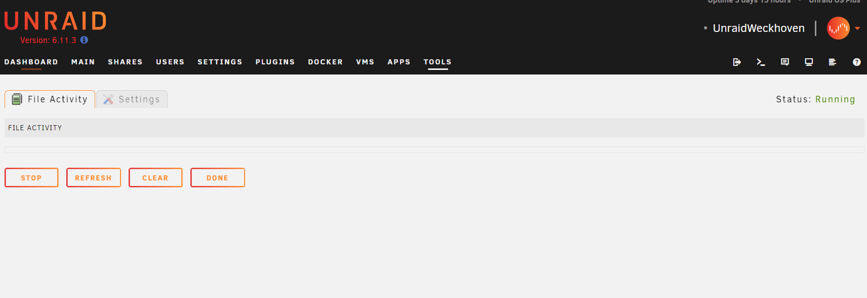

  18. Its working. Sorry - it just got a while to display used files.
