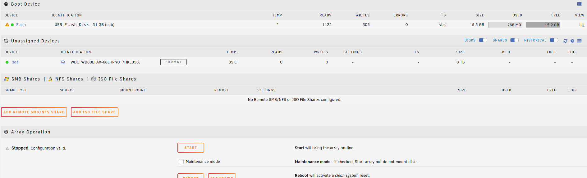

  15. thank you, i stopped the array, did a new configuration (via tools). if i use lsblk, my storage isn't still mounted.

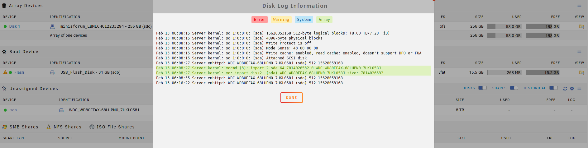

  16. Hey lovely community, i installed 'Unassigned Devices' but my storage doesn't mount automatically. i tried it with fstab, but fstab delete after every reboot. and under assigned devices isn't found there so what is the best way ?
