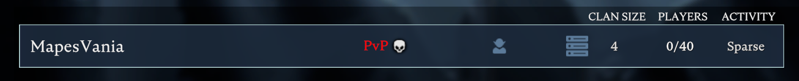

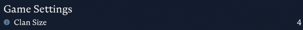

  14. vrising\VRisingServer_Data\StreamingAssets\Settings that the proper path. Cause i updated the json and restarted docker and password still not applied
  15. So not game parameters but the two json files. Wont they get over written when updates occur?
  16. Did not work for Server Password or Clan Size.

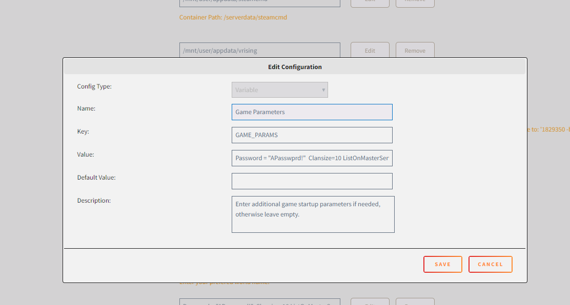

  18. What is the proper syntax for putting parameters into dedicated vRising Server? For example is below the correct process Password = "aPassword" ClanSize = "10" ListOnMasterServer = "False" Thanks again Ich777 for another fantastic docker.
