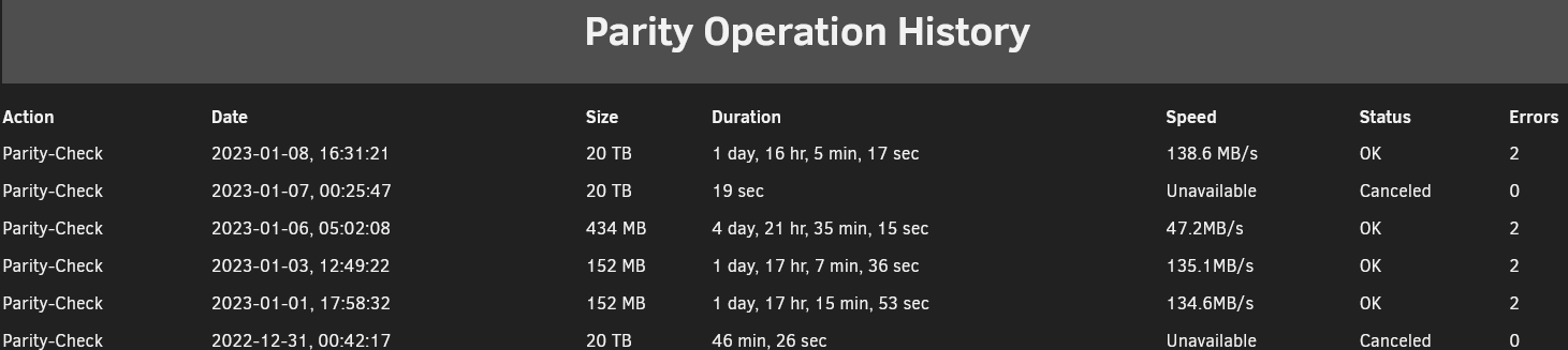

  9. I'm having ongoing issues with my parity checking. About 80% of the checks return 2 errors on the same blocks. There doesn't seem to be an issue with the array, it's always the same 2 blocks, right at the end of the 20TB check. I have had an issue for the last couple of months where the parity check history is not loading, although it is available on the flash, as detailed here: The last time I ran a successful correcting parity check I used the command line. However, this time (a few weeks later) it's refusing to start and I'm not sure why. The array's started and everything else is working as it should as far as I can tell. Here's what I get: root@Tower:~# parity.check correct Not allowed as No array operation in progress already running I can't find any other instances of that error message online. I'm using the 2023.04.30 version of the plugin on v6.11.1 of Unraid.

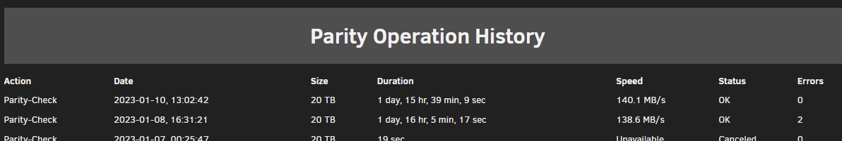

  20. Sync of parity 2 has now completed without error. I find it worrying that using Firefox with the Unraid GUI has been an issue since at least v6.11.1 and there is no message displayed to Firefox users to warn of potential issues and that it's safest to avoid Firefox. I've spent many hours on this and have avoided using my server since building it nearly a month ago until this was resolved. I know that Firefox is a marginal browser nowadays, but I'd imagine there's likely a higher percentage of users among the Unraid customer base than globally. There must be a fair few people like me experiencing weird issues and the last thing you'd imagine in 2022/3 is that the browser you're using could cause technical issues with your server's functionality.

  22. Correcting check with parity 2 disconnected finished earlier. It says it corrected errors on the same 2 sectors as previously: Jan 8 16:18:01 Tower Parity Check Tuning: DEBUG: Automatic Correcting Parity Check running Jan 8 16:24:01 Tower Parity Check Tuning: DEBUG: Automatic Correcting Parity Check running Jan 8 16:30:01 Tower Parity Check Tuning: DEBUG: Automatic Correcting Parity Check running Jan 8 16:31:20 Tower kernel: md: recovery thread: P corrected, sector=39063584664 Jan 8 16:31:20 Tower kernel: md: recovery thread: P corrected, sector=39063584696 Jan 8 16:31:21 Tower kernel: md: sync done. time=144317sec Jan 8 16:31:21 Tower kernel: md: recovery thread: exit status: 0 Yet the status and history are both saying there's still 2 errors:

  24. I first set this system up on an older PC with the 2 parity drives connected via USB. With that setup everything worked OK. I didn't do a check, but the sync completed successfully after I added the 2nd parity. I then moved the parity drives from USB to SATA with the new system- I checked parity as Unraid was seeing them as different drives due to being connected directly rather than via their USB controllers. That check and all that I've done since they've been connected directly have come back with 2 errors, but only the check that finished on the 3rd was definitely run as a correcting check, confirmed by the syslog saying that the 2 problematic sectors (39063584664 & 39063584696) had been corrected. These are the same sectors listed with errors in today's result. Not sure if it's relevant, but while the check's in progress I see it run through the drives and finish with each one in order of size as expected. My biggest array drive is 18TB, the 2 parties 20TB. It seems like these errors are being found after it's finished checking the 18TB, so the error is somewhere in that last 2TB.
