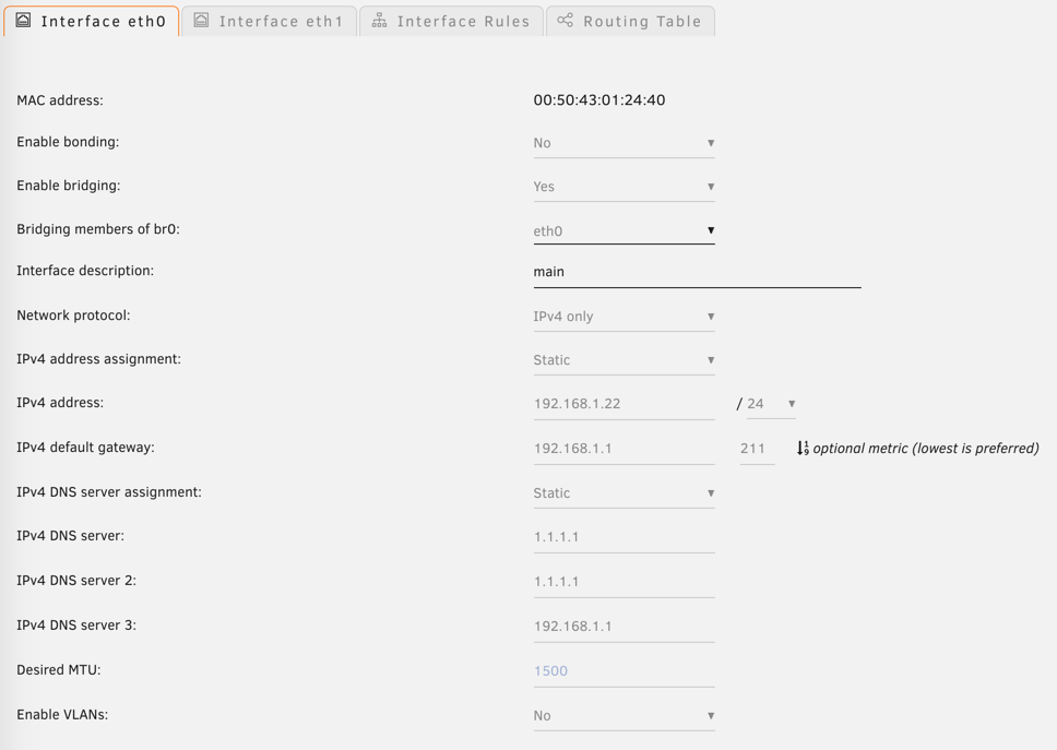

Your unraid DNS should be static and point to a real DNS server. If your router is sending out DNS requests that point to pihole and the docker is down, unraid will not get outside!

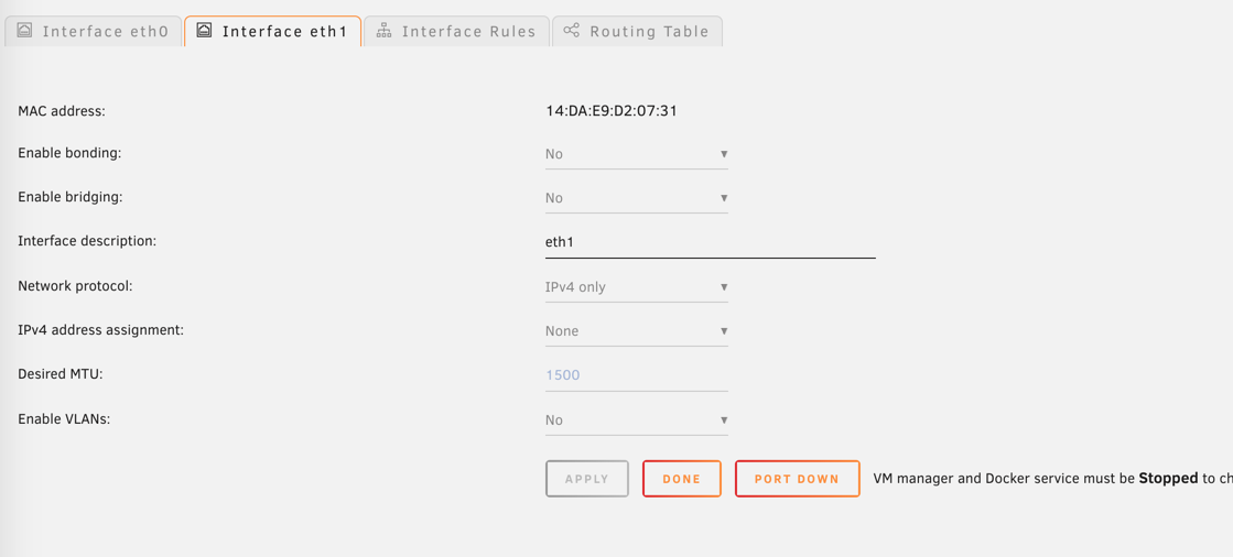

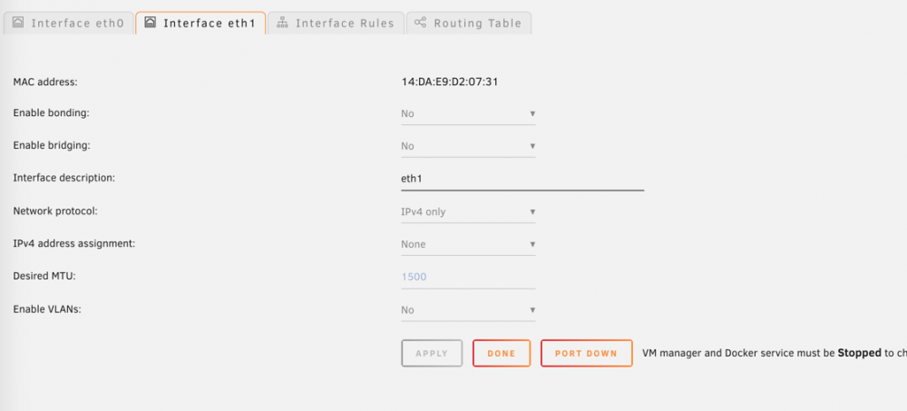

apologies - you may be right if you only have one network adaptor..... I have two in my system.

You can set the router to point to pihole.... that isn't a problem. If you do this, set the unraid IP settings manually to point to external DNS server
[SUPPORT] pihole for unRaid - Spants repo
Yes - how to fix.... Your unRaid is probably looping back through pihole.... on network settings, set a fixed ip, gateway and dns server.
