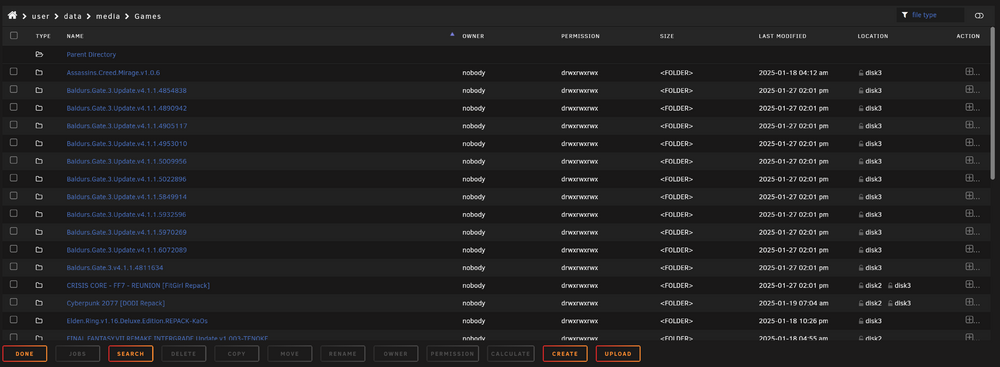

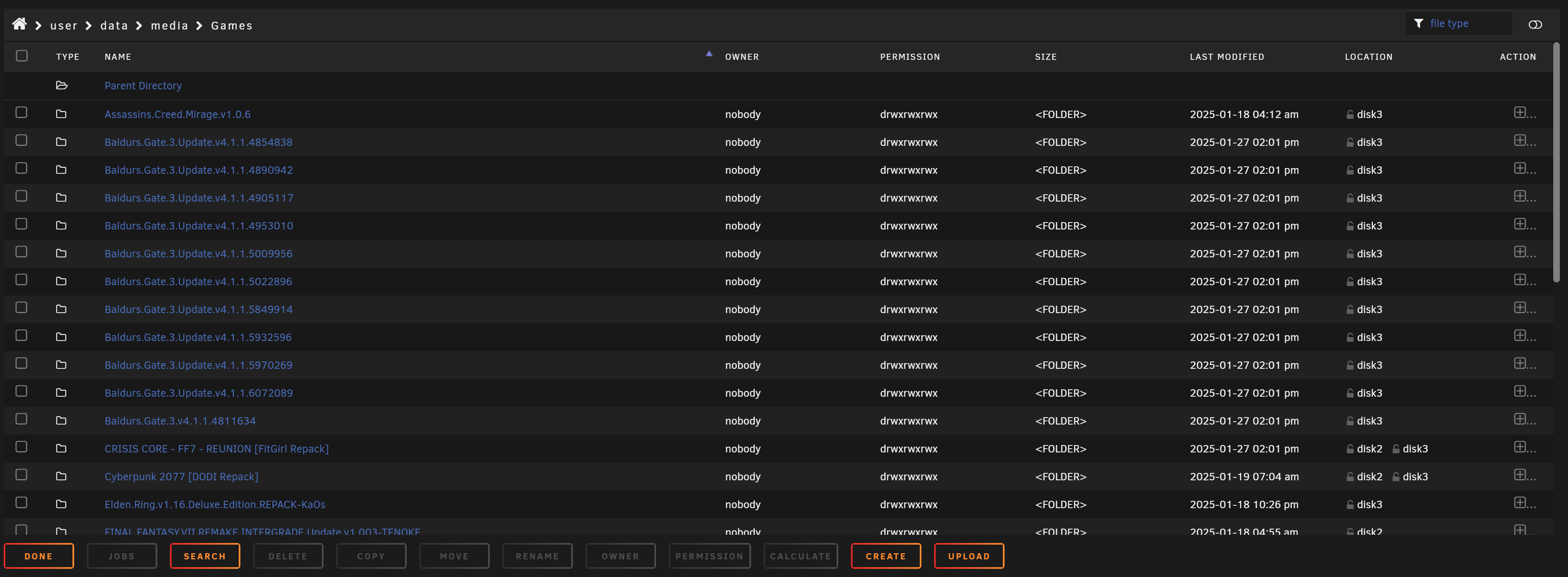

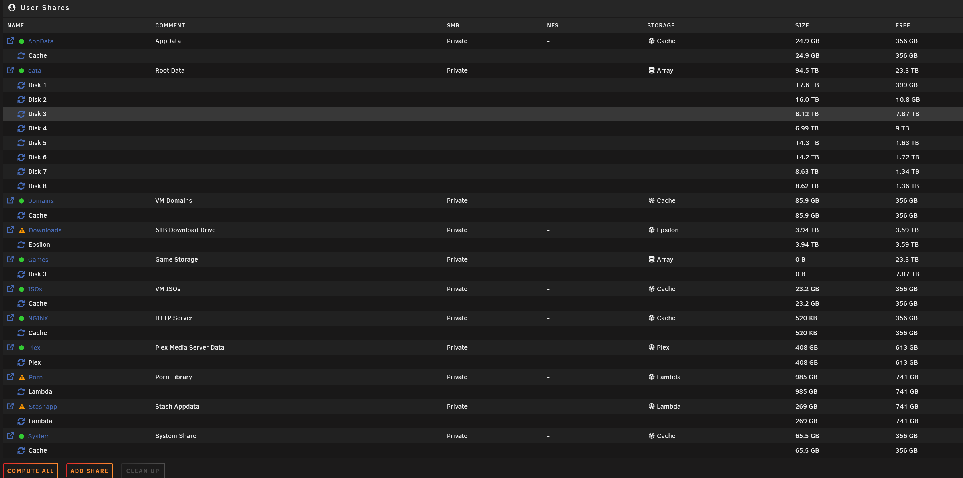

Best way to move one large share to a new share

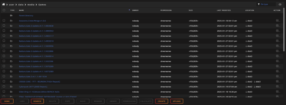

I have /mnt/user/data/Games/ on disk2 /Games/ I want to create a Games share and have them be in the share. When I tried to move them, it looked like it was going to take hours when I expected a 5 second quick relocation since they are going to the array. Hiow do I do this properly? Thanks
Could have probably done it by now letting it run overnight but I kept expecting someone to give a quick solution, anyone got anything?

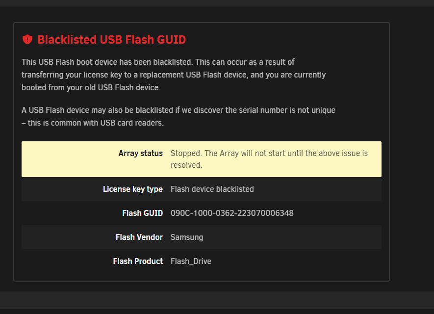

USB wouldn't boot, had [this] error, setup new USB key, need my GUID activated to my key please.

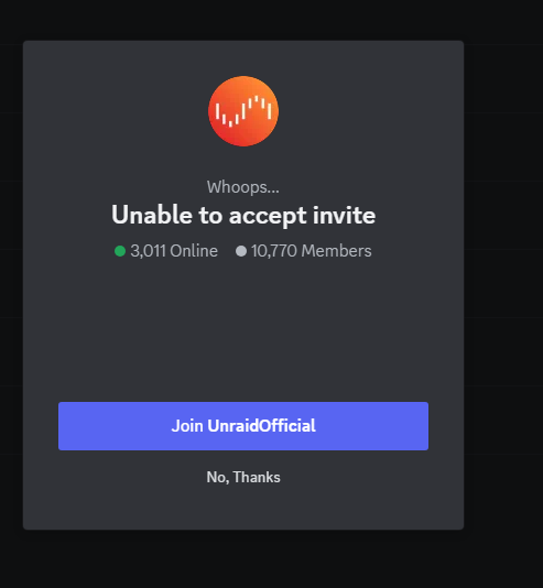

Had this error all of a sudden; Created a new fat32 UNRAID 64gb SAMSUNG Bar Plus stick, copied files over, ran make bootable, boots fine, but need to transfer my key. I'm still banned for the discord for some reason: @discord - sunwind.actual Really hard to get any quick support without it.

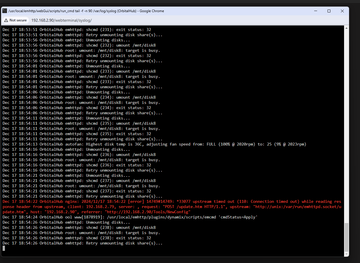

I can never stop the array "Unmounting disks...Retry unmounting disk share(s)..."
man I can't believe I am still getting this issue andd unable to shutddown cleanly.. fix yo shit please.
