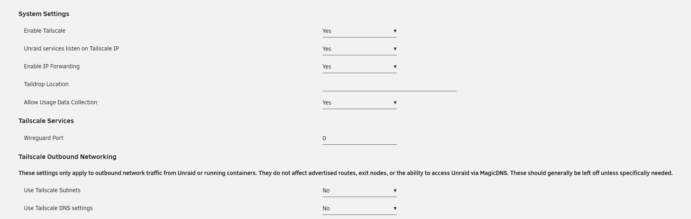

  3. Recently, Tailscale stopped working for me after I could use it for some months. I just can't connect to the unraid dashboard via Tailscale anymore. Using the latest version Tailscale 1.70.0-t0e0a21241-g26f80df92 Unraid 6.12.11 I'm not aware of any changes I made, but it came to my mind, that it's maybe related to my ISP change. With the new ISP, I seem not go to get a public ip4 address (on the modem, the ipv4 is different from the one at a website like https://browserleaks.com/ip). Is this not supported by Tailscale? After I found out, that I couldn't connect anymore, I looked at the Unraid settings again. Tailscale plug-in shows this warning on the "Viewbing Button": Cannot access this device’s Tailscale IP. Make sure you are connected to your tailnet, and that your policy file allows access. I used the feature "Erase Tailscale Configuration" and logged in again. All settings are standard. On the admin console at login.tailscale.com the unraid server shows as online. But still, I can't open with my phone or WinPC the unraid admin page (with connected Tailscale). I tried using the direct ip and machine name. It didn't work. I have also created a Tailscale diagnostic log. Is it safe to post it public?

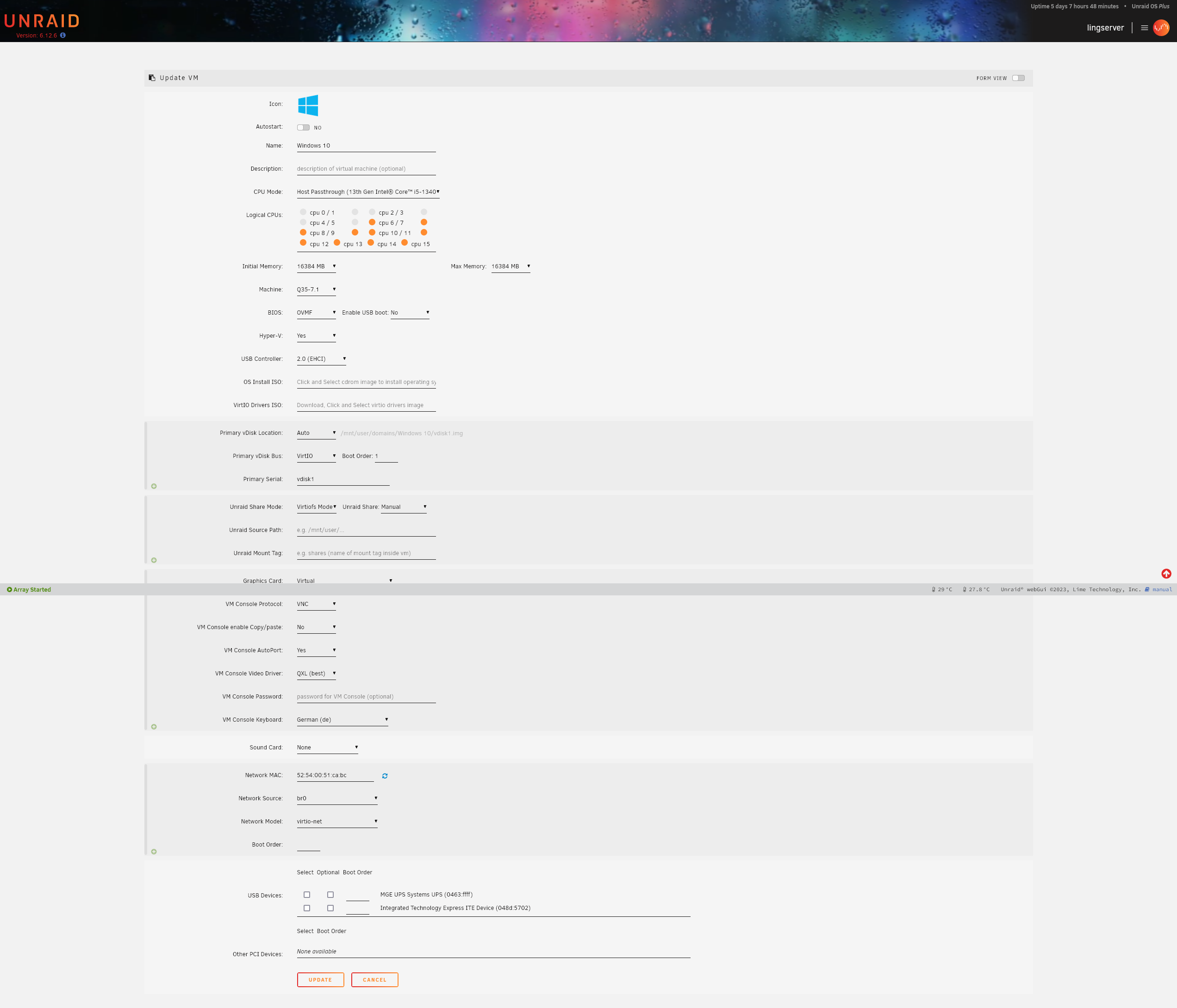

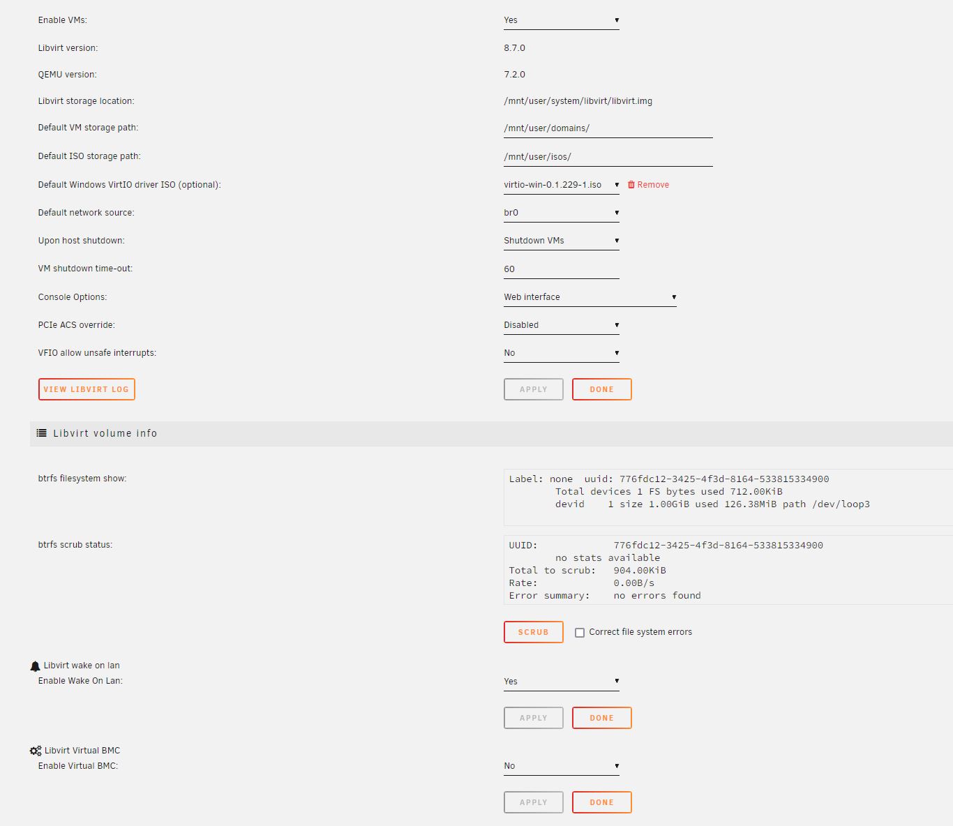

  8. Ich bekomme das nicht zum laufen. - Habe das "Virtual Machine Wake On Lan Pugin" installiert und unter Einstellungen / VM aktiviert - In Unraid bei dem VMs die MAC Adresse der Win10-VM kopiert - das wolcmd tool installiert und eine .bat Datei erstellt: wolcmd.exe 52540051cabc 192.168.1.10 255.255.255.0 4343 52:54:00:51:ca:bc ist die MAC der VM 192.168.1.10 ist die IP vom Unraid Server Auch habe ich das Gui Tool von der gleichen Seite probiert - ohne Erfolg. Egal, ob die VM im Status Pause oder Stopped ist, bekomme ich sie nicht mehr gestartet. Muss ich noch an einer anderen Stelle eine Einstellung setzen? (habe zwei Screenshots von meinen Einstellungen angehängt).
