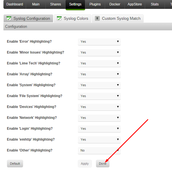

Gentle reminder that the "done" button is still broken. It should send the user to http://tower/Settings. Also there needs to be a scroll bar across the bottom of the log window/frame to be able to read long lines without maximizing the browser The Done button works for me. The slider is there, you just have to scroll down to see it. I'm not sure I can do much about that. My bad. The scroll bar is there. And now the Done works fine. Chrome oddness.

After applying default colors scheme on this page http://tower/Utilities/SyslogSettings,'>http://tower/Utilities/SyslogSettings, I pressed done and ended up at blank screen with this address. http://tower/Utilities

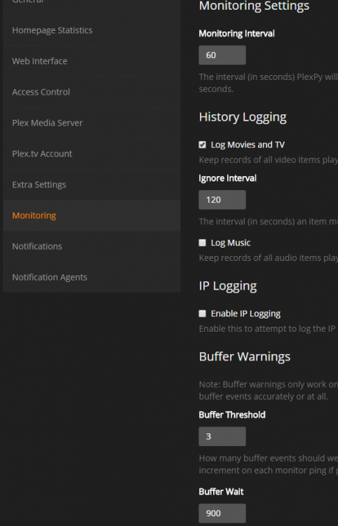

and the rest... To access PlexPy using my settings & IP, the URL is http://192.168.1.8:8181/home Change the IP to the one assigned to your server.
